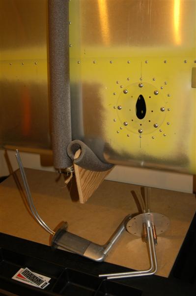

Hey Skip,
I purchased that Dynon pitot tube for my D10-A and it is a solid and heavy installation compared to the stock pitot with the kit. My 701 did not come with any static port parts or a pitot with a static port. You will also need a pitot mast and plumbing to finish this installation, they are both available at http://www.safeair1.com .I did purchase a pitot with a static port before I decided on a Dynon. But I wanted the option to not install the Dynon pitot tube If I wanted. I had made an access panel for inspection of the strut attachment on my 701, but also made the access the mounting point for the pitot. I made 2 exact panels and then installed the dynon on one and the dual pitot static on the other. This way I can change them out easily. I also installed static ports on the fuselage, so I have a static port while using the dynon pitot(got that from safeair also). The AOA blue tube becomes another static port with the other pitot.
The pitot mast is steel. If someone bumps into this hard enough I could see it ripping open my .016 wing instead of breaking off. Just make sure you run 2 tubes to your pitot area. I'm sure this could be an option for you to do. If your getting a Dynon it would be kind of a waste not taking advantage of this feature, but it costs a couple bucks to do. See pics attached.
Brian

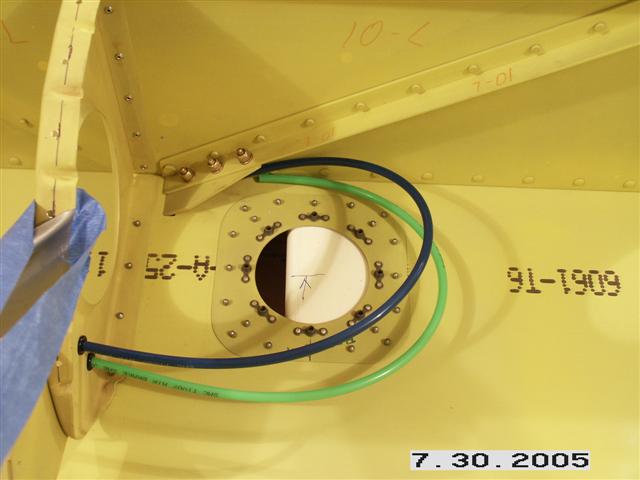

Skip
I'm flying with both the Dynon D100 and D180 with the Dynon pitot. I use
a split feed to both units for the AOA and Pitot. In addition I installed 2
Static ports on the rear of the fuse T'd along the lower longeron just in
front of the stab and split to the two Dynon units. I mounted the Dynon
pitot in the center of a round inspection plate. I like the set up very
much and would recommend it for your VFR needs. With 40 flight hours so far
all is working well.
George May
601XL 912s 40 hours

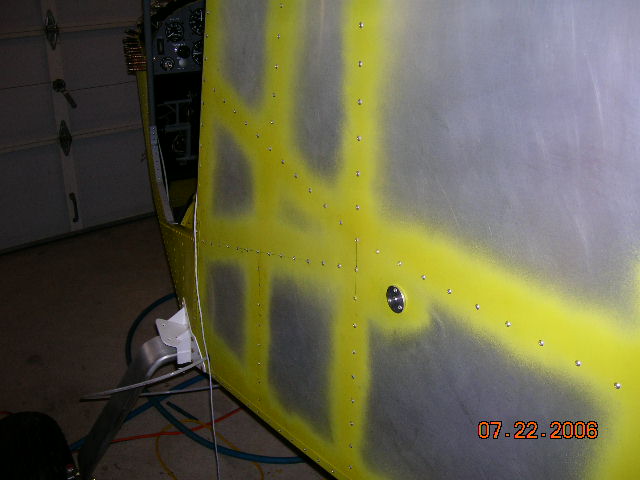

btucke73(at)yahoo.com Guest
Posted: Fri Jan 05, 2007 8:56 pm Post subject: what to do with my pitot |
Gig,
I put my static port about mid way between the
trailing edge of the wing and the leading edge of the
horizontal stab. It is pretty much centered between
the vertical stiffening ribs, and the upper and lower
longerons. This is the approximate location of the
static port on the T-34c, so I just went with it. My
EFIS requires calibrating the airspeed indicator,
which I did with GPS. It is tracking very nicely now.
disclaimer: You should follow the plans. If you
don't, this location worked for me.
VR/
Brandon
HDS / 46 hours
