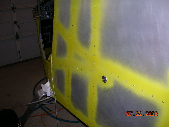

The static port is usually positioned at a point on the fuselage where the Bernoulli principal is least. This will be a relatively flat place which is parallel to the direction of travel. It can also be part of the pitot probe. I'm sure the plans for your plane will give you the optimum location.
My advice is to install two static ports, one on the opposite side of the fuselage, and Tee them together to the static port of your ASI, Alt and VSI inputs. That way a slip or uncoordinated flight won't upset your EFIS readings.

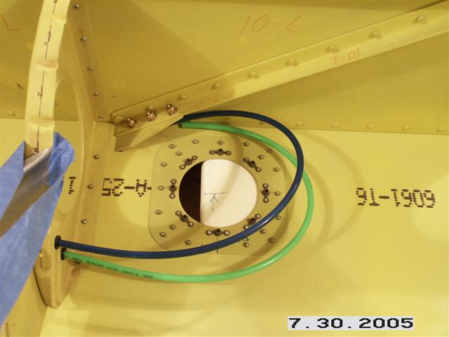

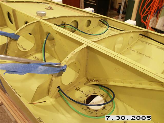

PostPosted: Thu Jan 04, 2007 7:09 am    Post subject: what to do with my pitot Reply with quote

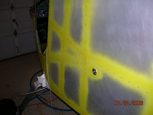

The pitot that came with your kit has two probes, one is a pitot tube and the other is a static source. I recommend buying and learning to use the AOA sensing probe from Dynon if you are going to use their EFIS/EIS unit. Approach and deparutre flown by reference to a calibrated, functioning AOA system is much safer than trying to calculate stall speed in various weather conditions, aircraft configurations and weights.
Mount the kit provided unit on the opposite wing following the plans' directions. You can either "T" the pitot lines together and the unit will "see" the average of the two installations, or you can connect them to a valve accessible inflight to establish an "either/or" option. Either one will work with the Dynon unit's airspeed sensing device. The benefit of two pitot tubes is that one can smack a bug and cease to function until you land and clear it.... rare but possible.
The kit provided static source can be used as your only one or can be backed up by a second one (they have been known to ice over).

PostPosted: Thu Jan 04, 2007 7:57 am    Post subject: Re: what to do with my pitot Reply with quote

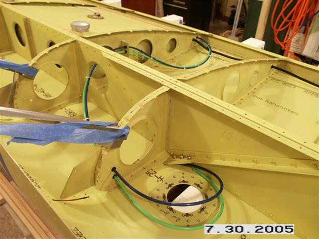

I too am going with the Dynon but I finished my wings before I made that decision. So I only have 2 pitot/static lines running out to the wing and I have the holes positioned for the factory pitot/static tube.
I chose not to go ahead and mount the tube at the time because I figured it would get broken off during moving the wing around.
My plan now is to use the Dynon probe with AOA and use the two lines that are out there for Pitot and AOA and mount the static port somewhere on the fuselage.

PostPosted: Thu Jan 04, 2007 8:09 am    Post subject: what to do with my pitot Reply with quote
If a late installation is necessary, cut an inspection port at the pitot / AOA location and do the installation on the hatch cover. Some guys in the list have done that from the get-go just to facillitate removing the pitot rig to prevent damage in storage and handling of the wings.

I installed the static port half way between the
wing and the horizontal stabilizer, with good results.

PostPosted: Thu Jan 04, 2007 9:29 am    Post subject: Re: what to do with my pitot Reply with quote
Where exactly did you place the Static port? I've been looking for an answer to that question for a while now.

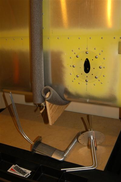

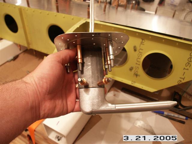

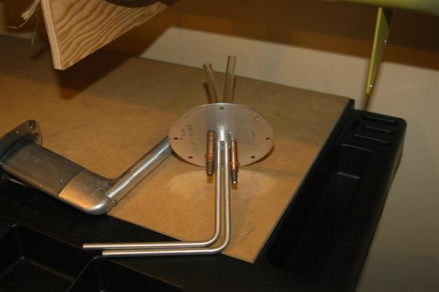

RURUNY(at)aol.com

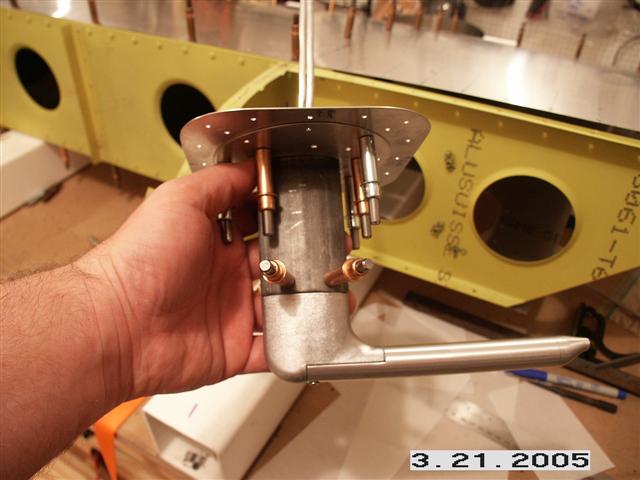

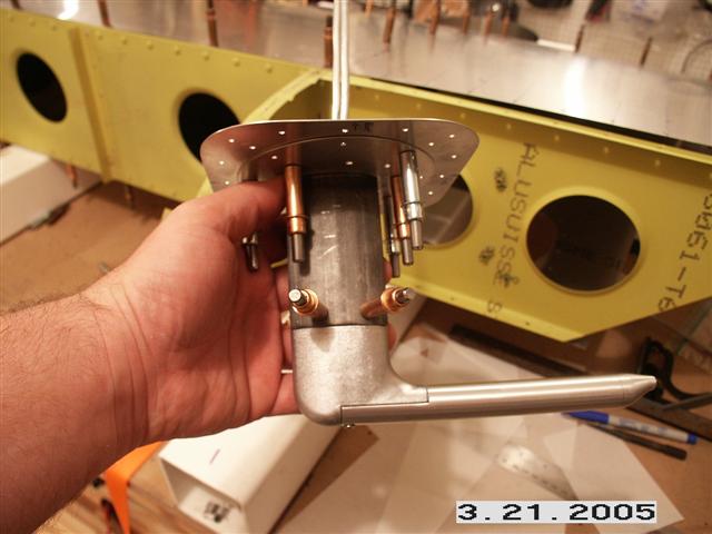

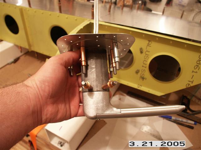

PostPosted: Thu Jan 04, 2007 5:15 pm    Post subject: what to do with my pitot Reply with quote
Hey Skip,
I purchased that Dynon pitot tube for my D10-A and it is a solid and heavy installation compared to the stock pitot with the kit. My 701 did not come with any static port parts or a pitot with a static port. You will also need a pitot mast and plumbing to finish this installation, they are both available at http://www.safeair1.com .I did purchase a pitot with a static port before I decided on a Dynon. But I wanted the option to not install the Dynon pitot tube If I wanted. I had made an access panel for inspection of the strut attachment on my 701, but also made the access the mounting point for the pitot. I made 2 exact panels and then installed the dynon on one and the dual pitot static on the other. This way I can change them out easily. I also installed static ports on the fuselage, so I have a static port while using the dynon pitot(got that from safeair also). The AOA blue tube becomes another static port with the other pitot.
The pitot mast is steel. If someone bumps into this hard enough I could see it ripping open my .016 wing instead of breaking off. Just make sure you run 2 tubes to your pitot area. I'm sure this could be an option for you to do. If your getting a Dynon it would be kind of a waste not taking advantage of this feature, but it costs a couple bucks to do. See pics attached.
Brian

I'm flying with both the Dynon D100 and D180 with the Dynon pitot. I use
a split feed to both units for the AOA and Pitot. In addition I installed 2
Static ports on the rear of the fuse T'd along the lower longeron just in
front of the stab and split to the two Dynon units. I mounted the Dynon
pitot in the center of a round inspection plate. I like the set up very
much and would recommend it for your VFR needs. With 40 flight hours so far
all is working well.

Gig,
I put my static port about mid way between the
trailing edge of the wing and the leading edge of the
horizontal stab. It is pretty much centered between
the vertical stiffening ribs, and the upper and lower
longerons. This is the approximate location of the
static port on the T-34c, so I just went with it. My
EFIS requires calibrating the airspeed indicator,
which I did with GPS. It is tracking very nicely now.
disclaimer: You should follow the plans. If you
don't, this location worked for me.
VR/
Brandon
HDS / 46 hours
