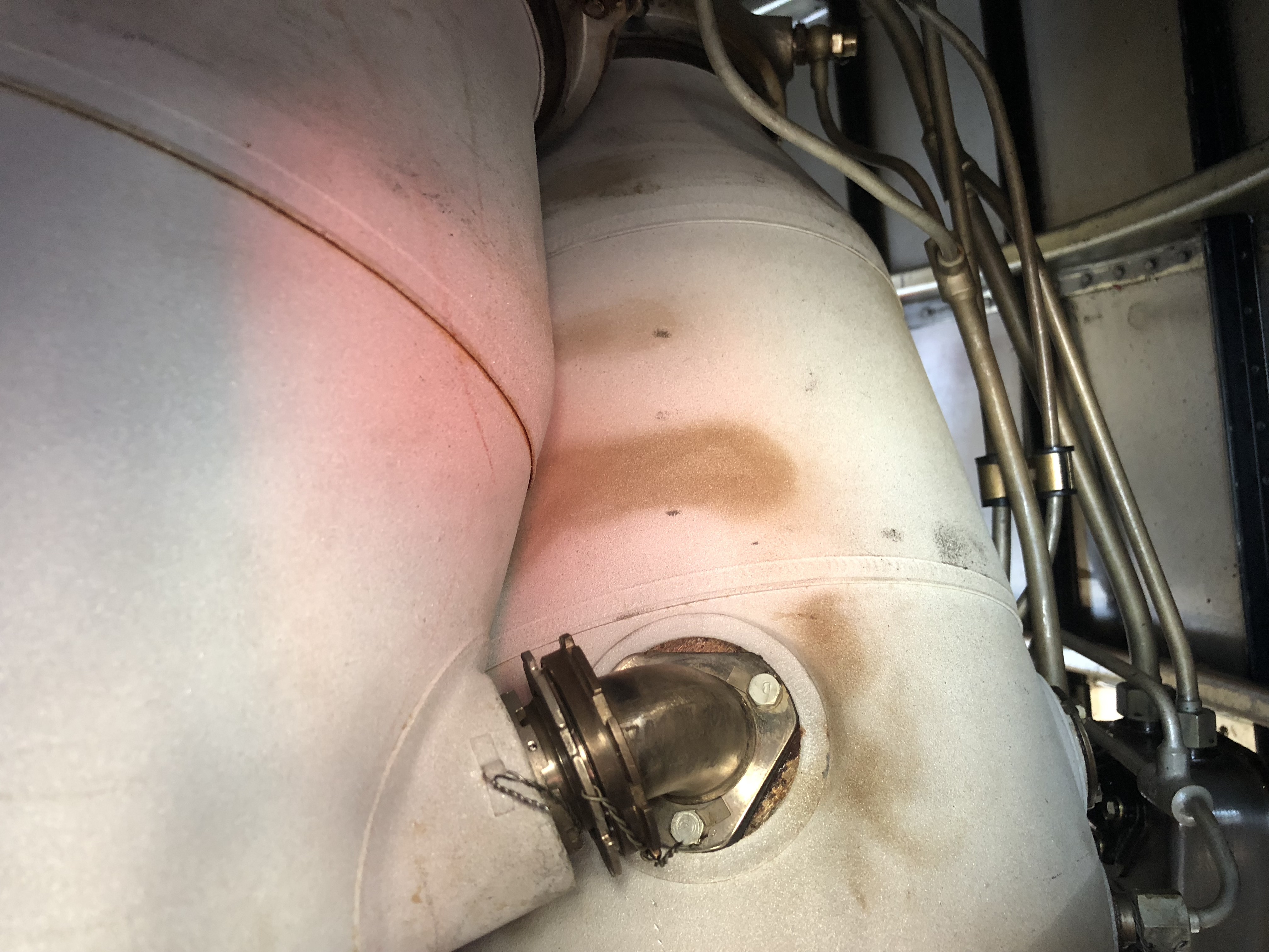

so, an update.
noise on shutdown isolated to the bottle left burner can. It sounds like the injector, or the liner has broken/come loose. The EGT on start up goes to 575, then settles at 325 which is too low.
Taking the can off to inspect the can, and the blades. Evidence of scorching on the outside of the can. I'm hoping a simple burner/injector replacement will solve the issue.
Otherwise a new engine is in order I would suspect
