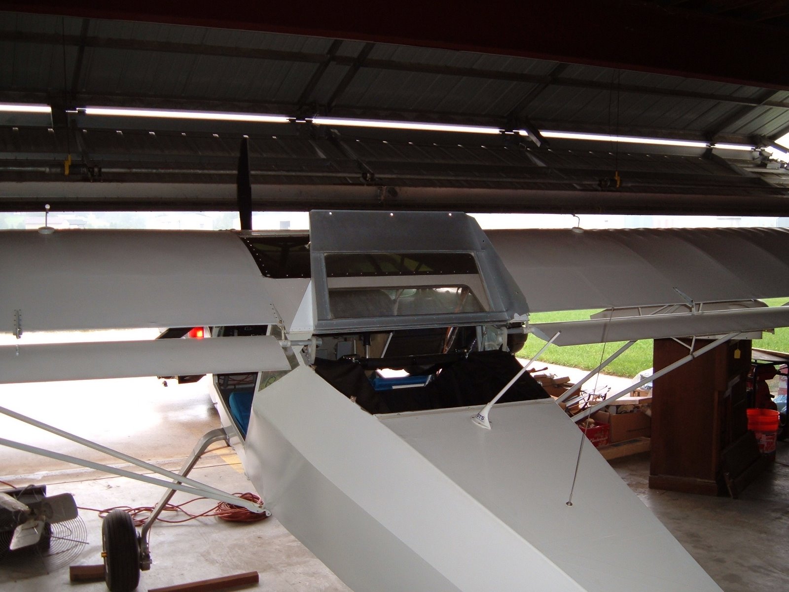

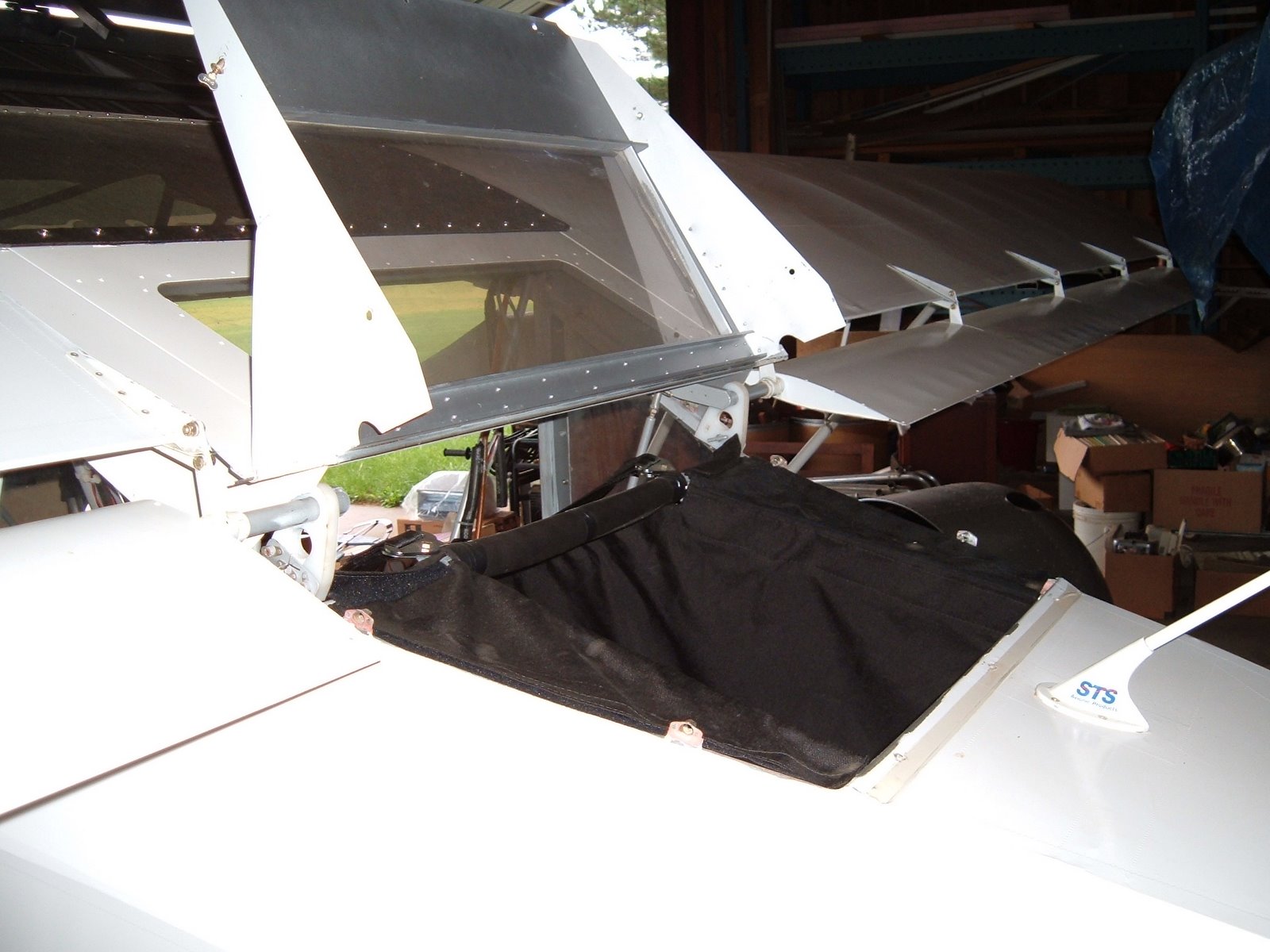

Attached are some pictures of access to the baggage\cargo compartment on a stock Series 5. Max weight is 150 lbs.

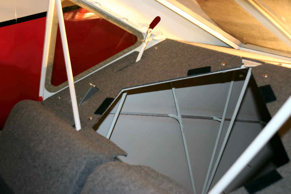

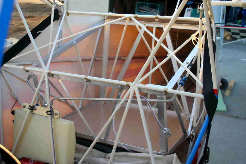

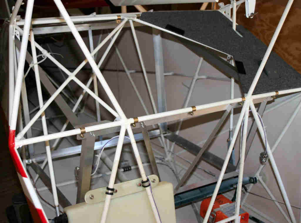

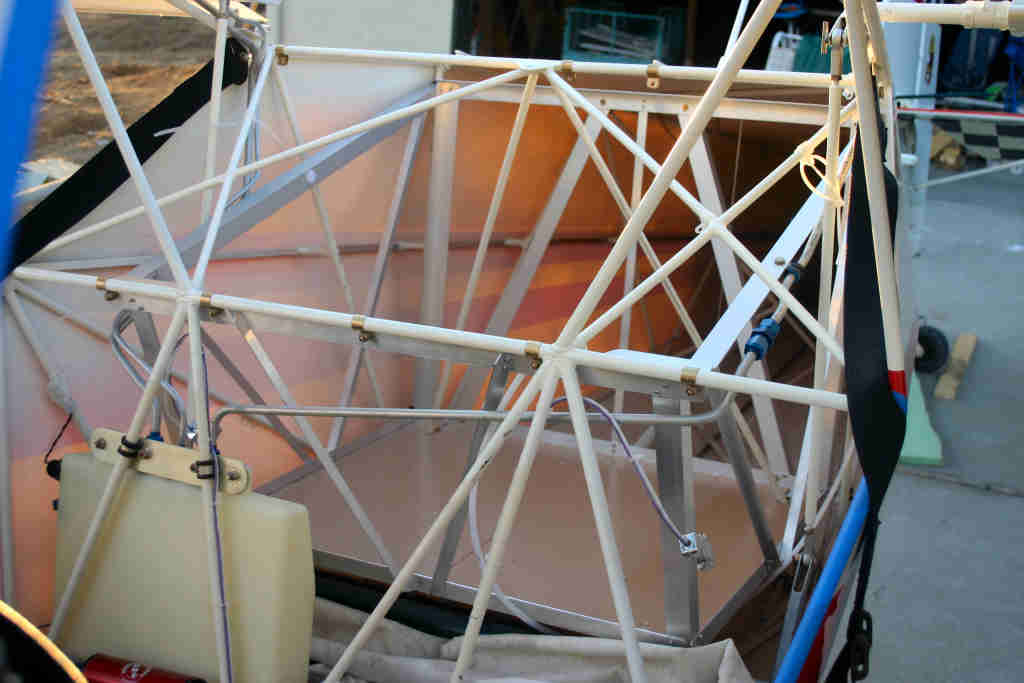

I've attached three pictures. One shows the baggage opening
behind the seat. One shows half the baggage opening with the baggage
structure, but no side panels, and one good shot of the baggage
structure without the panels. Unfortunately I don't presently have
any shots with panels, but the panels are honeycomb glass on the
bottom and corrugated plastic on the sides. The baggage structure is
the silver aluminum angles. The white tubes are fuselage structure
and the silver tubes are fuel lines.

What an ingenious idea, splitting the turtledeck so you have
hatch access as well as internal access! I wish I'd thought of it,
although I guess it isn't too late to make a new turtledeck.
