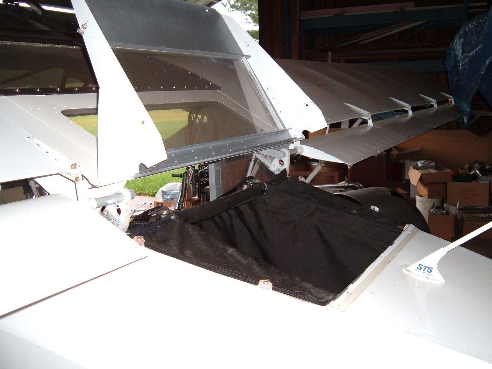

Attached are some pictures of access to the baggage\cargo compartment on a stock Series 5. Max weight is 150 lbs.
Steve
"5" 912UL

What an ingenious idea, splitting the turtledeck so you have
hatch access as well as internal access! I wish I'd thought of it,
although I guess it isn't too late to make a new turtledeck.
