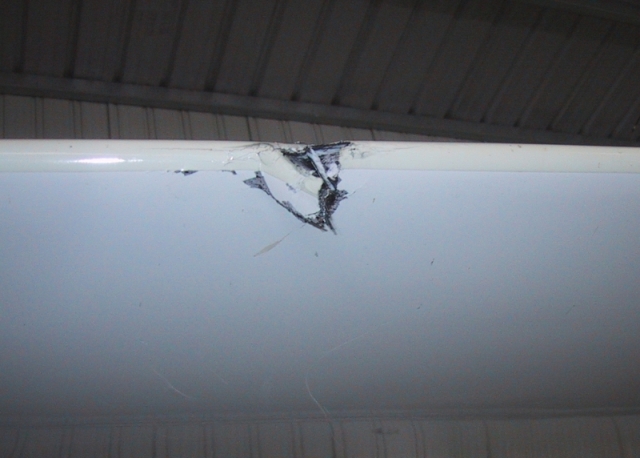

I'm a Lancair builder, but lurk here because of all the good experimental
dialog, much of which still applies regardless of the airframe. For those
RV'ers taking your door message to heart, we Lancair builder/flyers share
the same door importance/fate. FYI, attached are a few personal photos of a
Lancair Columbia that had a door open in flight near Indianapolis.
The slipstream "tore" the left (pilot) door off, after it became unlatched
in-flight. The door then struck the top of the right wing - yes, up over
the top of the aircraft and down into the wing while in-flight. The damage
to the wing skin was significant, into the core, much more than cosmetic,
but not catastrophic. Note: that area is the fuel tank on a Lancair. The
door then, struck the right Hstab. I'd guess it would be hard to do that
much damage with a good full sledge hammer blow (significant). As a result
of that impact, the fuselage was cracked under the tail. The longitudinal
crack is at the fuselage 1/2 mold joining line (joggle). The
circumferential crack(s) are through the outer skin, core, and inner skin.
The entire tail was loose/wobbly to the touch. From seeing it myself, I
can't imaging the tail would have stayed on too much longer or in a stiff
crosswind landing. The pilot was able to declare an emergency and land, but
was "very" lucky. Also keep in mind this was a Columbia which is certified
in the utility class and VNE of 235 kts - quite strong - perhaps even more
so than either our RV or ES birds.

Just make sure the lock pin is fully in place on the inner tube that
connects to the button on the door latch. If it is not, and your knee
or something hits the handle a little, it can come open. Once it
starts, the pressure on the door makes it want to continue going open
until it releases. Fortunately, when that happened to me I was able
to grab the door and close it (it wasn't too hard to close, but
without a handle on the back of the door as in the attached picture it
would have been impossible) before any damage was done to it. I would
say the first thing to do if that happens would be to get off the
power (unless you are on takeoff, maybe) and slow down. I know of two
cases where the door came open and didn't come off, one of which was
on takeoff and one of the hinges broke. Even with the hinge broken,
the pins held the door closed during flight.

After landing I discovered that the rear door hinge had torn completely
loose from the fiberglass, the strut was broken, and the front hinge was
still attached but bent and had to be replaced.
I ordered a new front hinge set and a new strut. Epoxy Floxxed the rear
fiberglass where the hinge had torn completely off the cabin top and
repaired the door fiberglass where the hinge had partially tore out of
the door. In 3 days when the new hinge and strut arrived I installed
and was back in the air.
