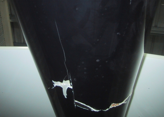

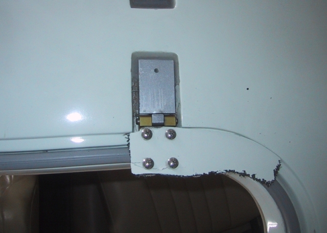

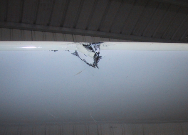

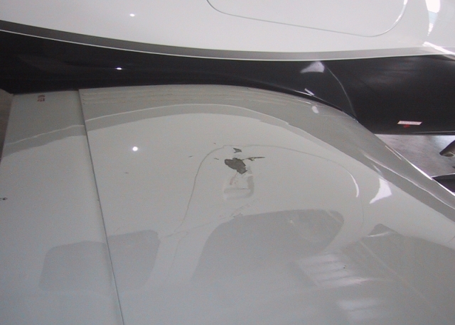

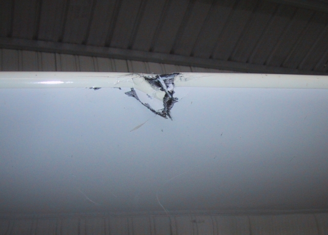

I'm a Lancair builder, but lurk here because of all the good experimental
dialog, much of which still applies regardless of the airframe. For those
RV'ers taking your door message to heart, we Lancair builder/flyers share
the same door importance/fate. FYI, attached are a few personal photos of a
Lancair Columbia that had a door open in flight near Indianapolis.
The slipstream "tore" the left (pilot) door off, after it became unlatched
in-flight. The door then struck the top of the right wing - yes, up over
the top of the aircraft and down into the wing while in-flight. The damage
to the wing skin was significant, into the core, much more than cosmetic,
but not catastrophic. Note: that area is the fuel tank on a Lancair. The
door then, struck the right Hstab. I'd guess it would be hard to do that
much damage with a good full sledge hammer blow (significant). As a result
of that impact, the fuselage was cracked under the tail. The longitudinal
crack is at the fuselage 1/2 mold joining line (joggle). The
circumferential crack(s) are through the outer skin, core, and inner skin.
The entire tail was loose/wobbly to the touch. From seeing it myself, I
can't imaging the tail would have stayed on too much longer or in a stiff
crosswind landing. The pilot was able to declare an emergency and land, but
was "very" lucky. Also keep in mind this was a Columbia which is certified
in the utility class and VNE of 235 kts - quite strong - perhaps even more
so than either our RV or ES birds.

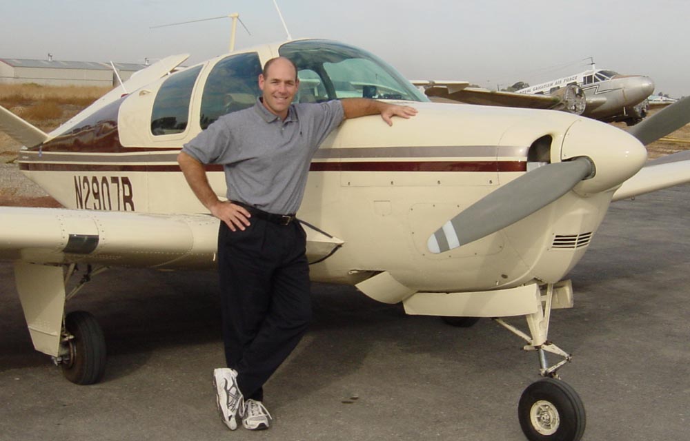

Yes and no. I have a D-35 Bonanza that had a difficult latching
mechanism (doors hinges forward as we all know). Heck it's a 1952 plane
designed in the 40's. Between the latch mechanism and the goofy door
handle the only door on the plane looked closed but on two (2) occasions
the door unlatched in flight. Both times the door unlatched on takeoff.
Because the door hinges in the front there was no concern of the door
ripping off but there was NO possibility of closing the door in flight
either. The slipstream pulled the door open. I know, I was in the PAX
seat. Great idea to include "Seatbelts Secure" in the checklist! It took
all my strength to hold the door in MOST OF THE WAY while we went around
and landed. If I released the tension the door would open a bit more but
not much more. So I was fighting to hold the door 2-3" closed vs. where
it would have naturally been had I applied very little pressure to the
door handle. Also note holding the door like that is very awkward with
little leverage. After the second time the door popped we completely
removed & serviced the door and replaced the door latching mechanism.
All good after that.

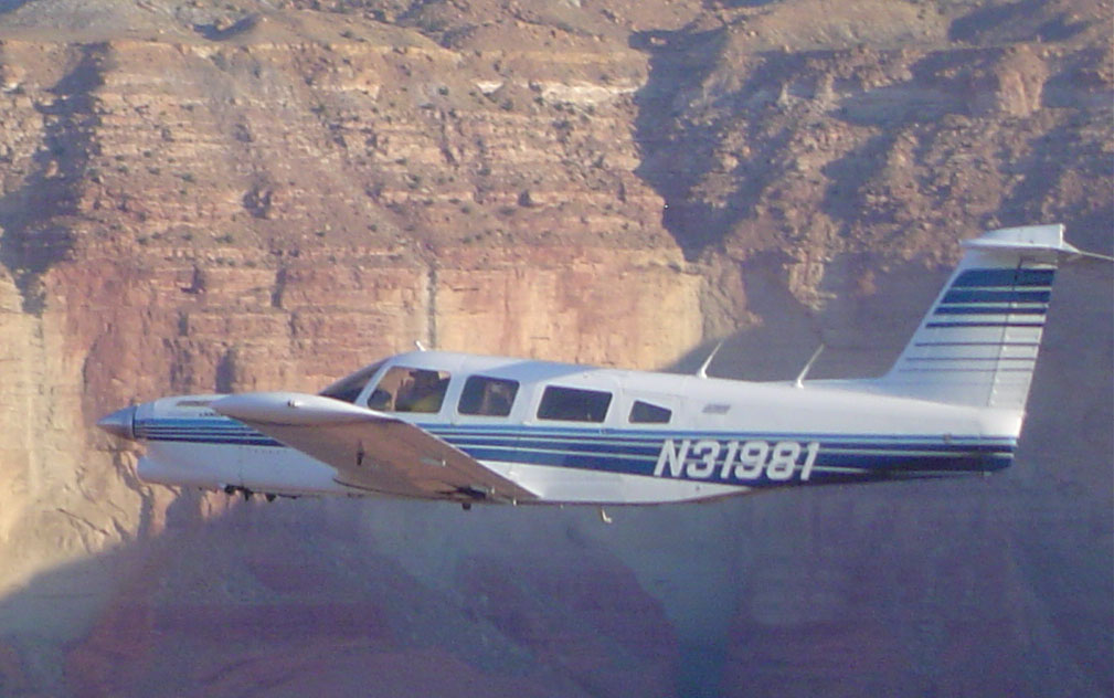

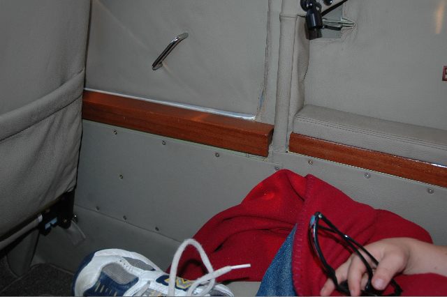

On my Turbo Lance II (AKA Land Lance) our rear baggage door once was not
fully closed. Again a misaligned mechanism. The misalignment was minimal
but about 8 minutes after takeoff we heard a buzzing sound. The sound
was the battery style home CO sensor I had placed in the plane. We could
hear it over the engine/Comm sounds. I was on a short flight (14
minutes) with a couple of friends to attend a BBQ so I nosed down,
throttled back and coasted into PRB. Again we completely removed &
serviced the door and replaced all the door latching mechanism. As most
know the Turbo Lance II is a long plane with the exhaust on the right
side and the baggage door on the rear left side. One might think that
the CO might dissipate in the slipstream but there was enough to set off
my detector. Truly a silent killer. My -10 will include a remote CO
detector that will alarm on the G900X.
Photos of both planes attached.

Just make sure the lock pin is fully in place on the inner tube that
connects to the button on the door latch. If it is not, and your knee
or something hits the handle a little, it can come open. Once it
starts, the pressure on the door makes it want to continue going open
until it releases. Fortunately, when that happened to me I was able
to grab the door and close it (it wasn't too hard to close, but
without a handle on the back of the door as in the attached picture it
would have been impossible) before any damage was done to it. I would
say the first thing to do if that happens would be to get off the
power (unless you are on takeoff, maybe) and slow down. I know of two
cases where the door came open and didn't come off, one of which was
on takeoff and one of the hinges broke. Even with the hinge broken,
the pins held the door closed during flight.
Jesse Saint

After landing I discovered that the rear door hinge had torn completely
loose from the fiberglass, the strut was broken, and the front hinge was
still attached but bent and had to be replaced.
I ordered a new front hinge set and a new strut. Epoxy Floxxed the rear
fiberglass where the hinge had torn completely off the cabin top and
repaired the door fiberglass where the hinge had partially tore out of
the door. In 3 days when the new hinge and strut arrived I installed
and was back in the air.
