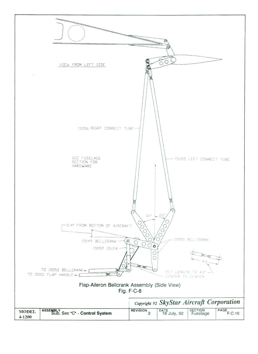

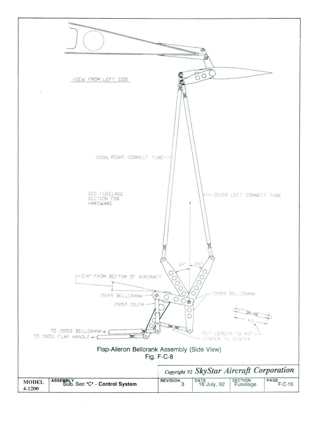

I had 30+ up and 20 down on my elevator. The aileron rigging is more
complex. I have attached a page from the manual rendered barely
legible by the reduction process. Let me know if you need a larger
view and I'll send it direct. Note there's no measurement for the
flaperon. It's installed horizontal with the wing true chord, (LE to
TE,) horizontal, measured at the flaperon mid-span. I've set my flap
system so I can reflex the flaperon up a little, though I've not been
able to discern any speed difference doing so.

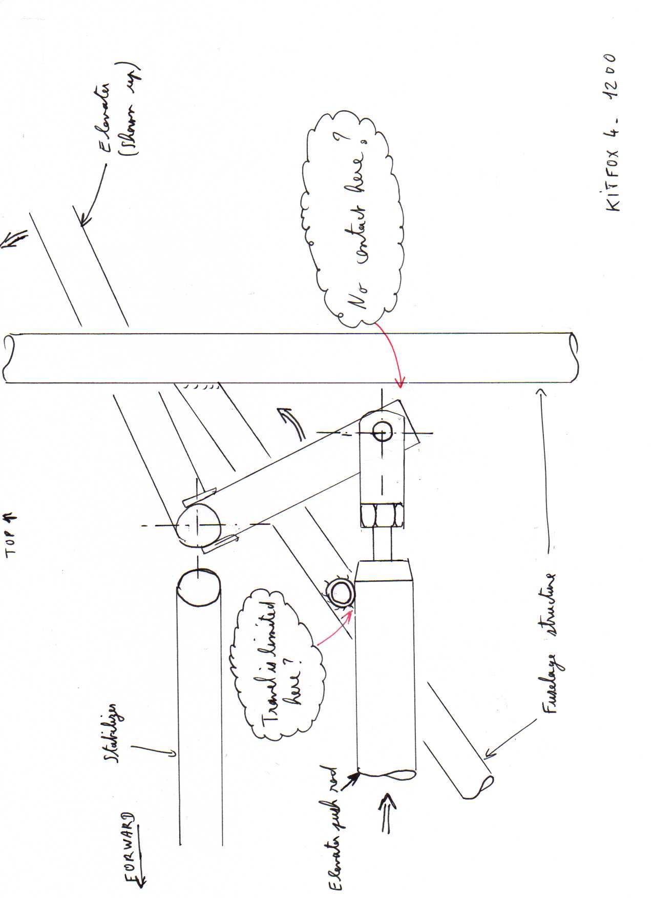

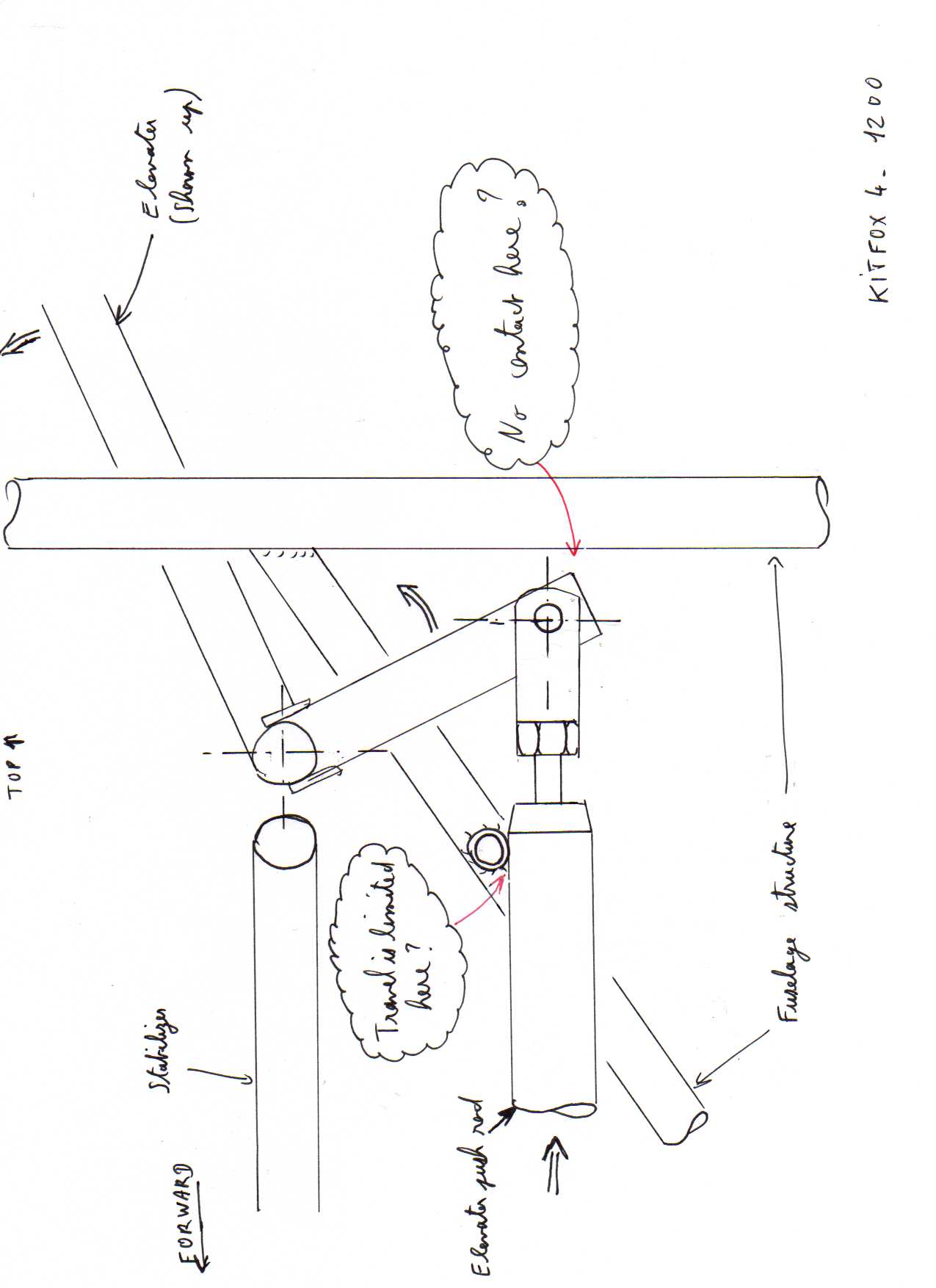

Renaud
Joined: 24 May 2007
Posts: 9
Location: France
PostPosted: Thu Jun 07, 2007 1:45 pm    Post subject: Re: need Elevator travel limits for speedster mk4 Reply with quote
Don,
The manual of the Kitfox Classic IV says up +29° down -24° for the elevator.
One mine, the upward travel stopped when the push/pull rod hit the little transverse tube normally used to stop downward travel. (See the attached skecth). I checked with John McBean (Kitfoxaircraft) who confirmed that the upward travel normally stops against the rear vertical.
I built a little part fixed on the lever of the elevator that now hits the rear vertical of the fuselage.
At the end, I have a travel of ~35° up, just what I need for 3 points landing (and I sealed the elevator / stab gap). Downward travel is about 25°, but of course I never had to use it completely.
Maybe this can help.
