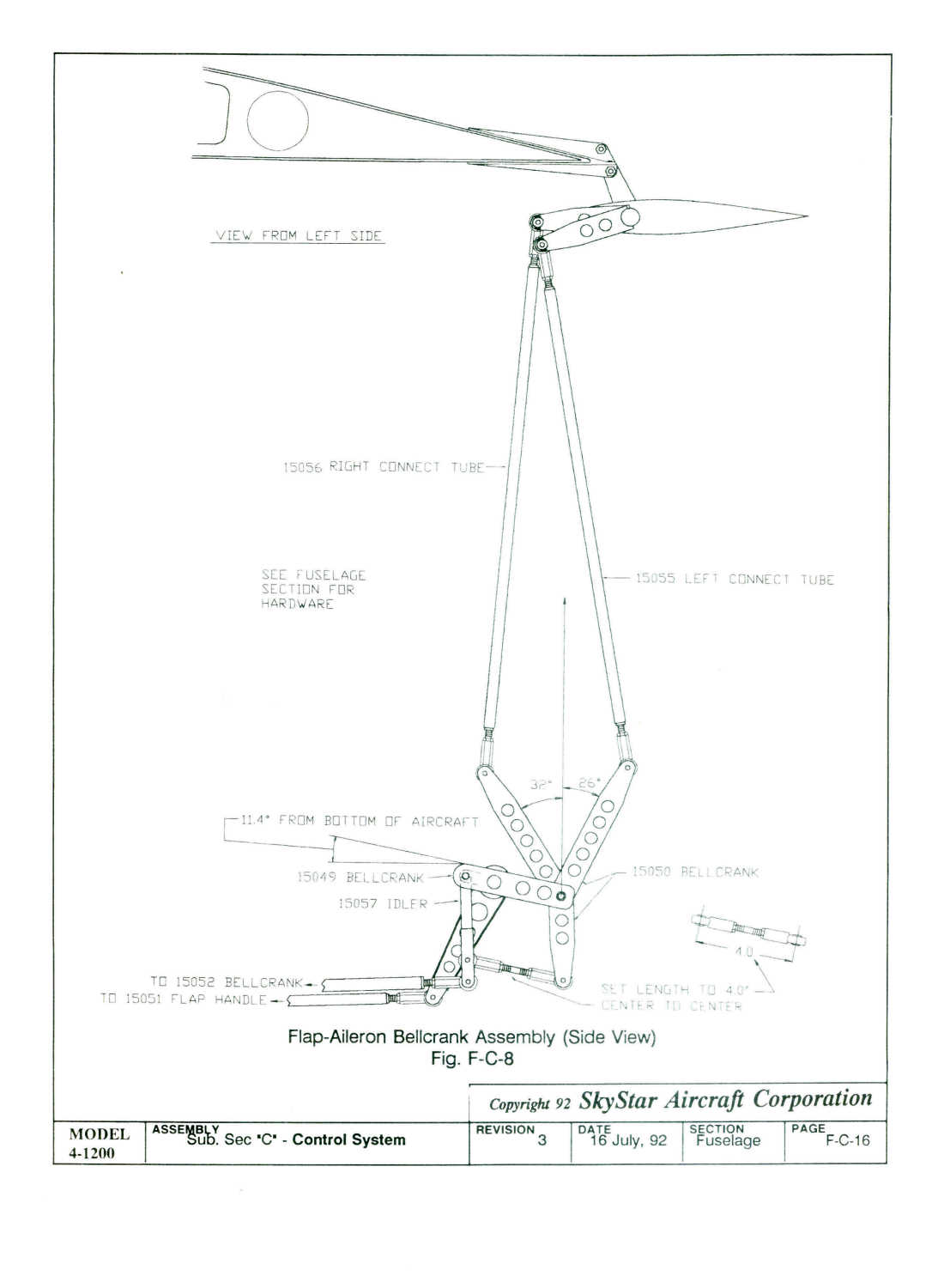

I had 30+ up and 20 down on my elevator. The aileron rigging is more
complex. I have attached a page from the manual rendered barely
legible by the reduction process. Let me know if you need a larger
view and I'll send it direct. Note there's no measurement for the
flaperon. It's installed horizontal with the wing true chord, (LE to
TE,) horizontal, measured at the flaperon mid-span. I've set my flap
system so I can reflex the flaperon up a little, though I've not been
able to discern any speed difference doing so.
