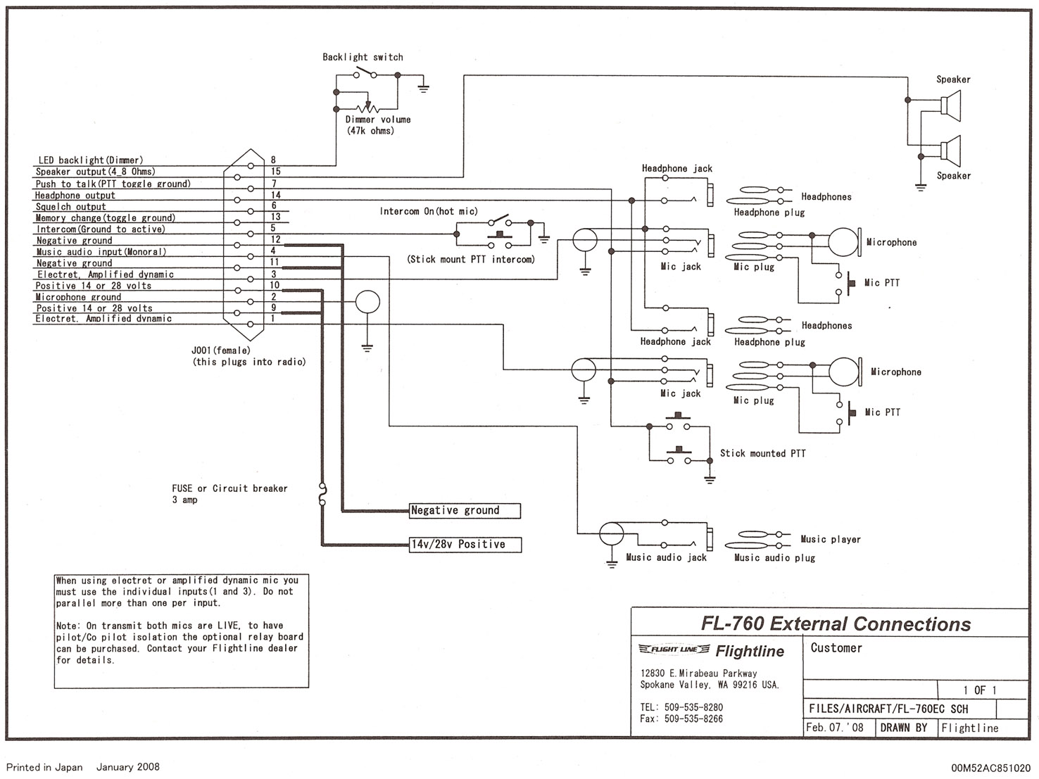

I have a flightline fl-760 and the manual says that both mikes go hot on transmit. That doesn't seem a like a great idea, particularly in a noisy cockpit. They mention an optional isolation relay board, but apparently they never did produce it, so I have to make up my own.
The problem is that while I can solder just fine, I suck at designing circuits. Has anyone made one of these boards, or has a schematic that I can work from? or any source for buying such beast?

I'm using the vox feature. works great on the bench. I'm not sure you can turn that feature off in this radio.
Would it work if I just put a relay in to disconnect the copilot mike on transmit..breaks the connection from the copilot mike to pin #3? And at the same time grounds pin #7 (the transmit PTT)?
There will only be one PTT[/list]
That would work. Check out
this relay:

The part suggested is a Tyco part. Here's the data
sheet:
http://relays.tycoelectronics.com/datasheets/OMI-2P.pdf
If you don't have access to Radio Shack then any
other small signal relay will do (2A or
less contacts).

When I tried the link it didn't get me to that part, but it looks like that's the one I found one their site. Given the info on the data sheet, I think my problem is solved. Thanks to you, and all the others that chimed in.
We have "the Source" here in the frozen north, a subsidiary of Radio Shack. I'll have no trouble getting what I need.
