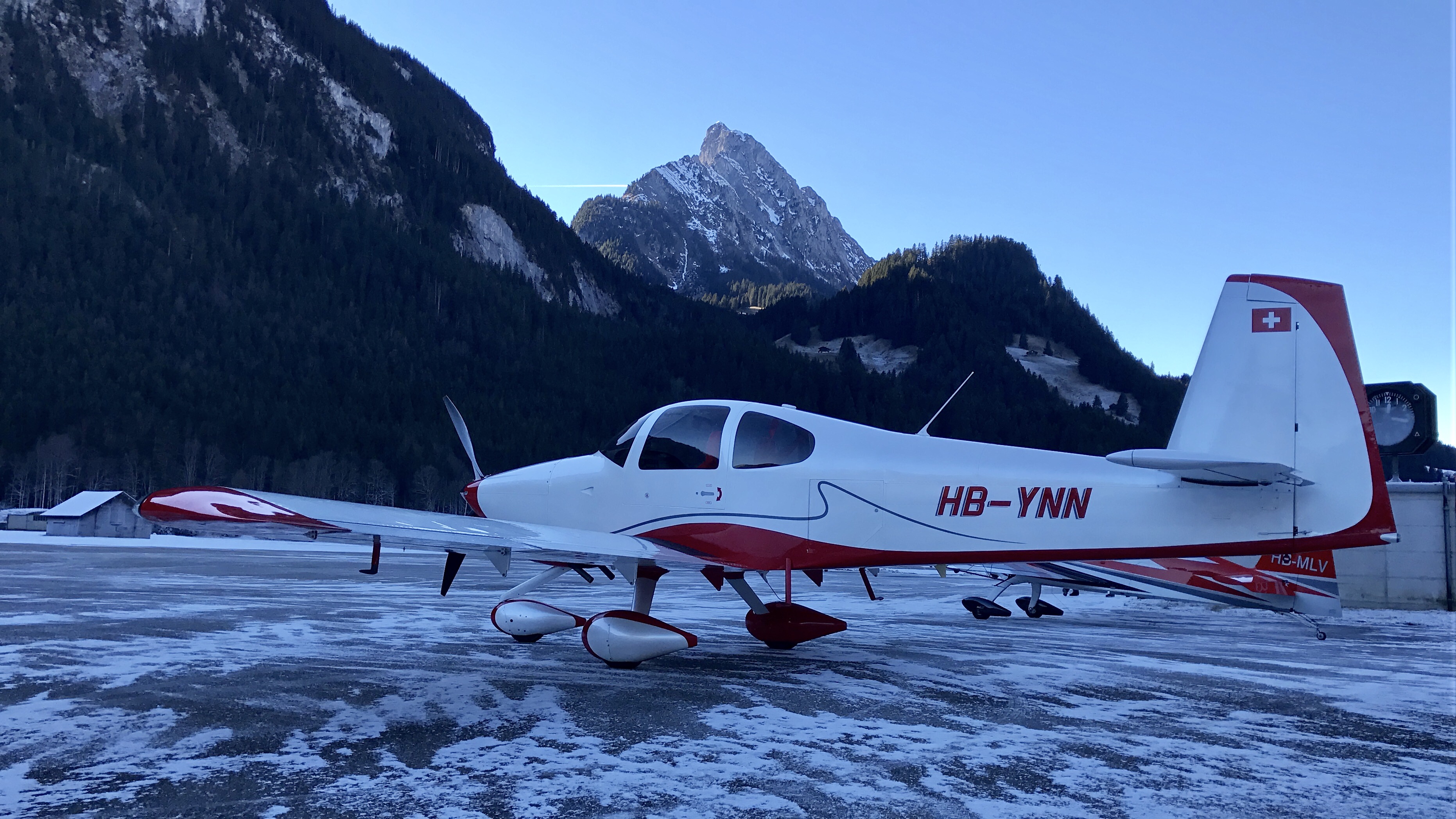

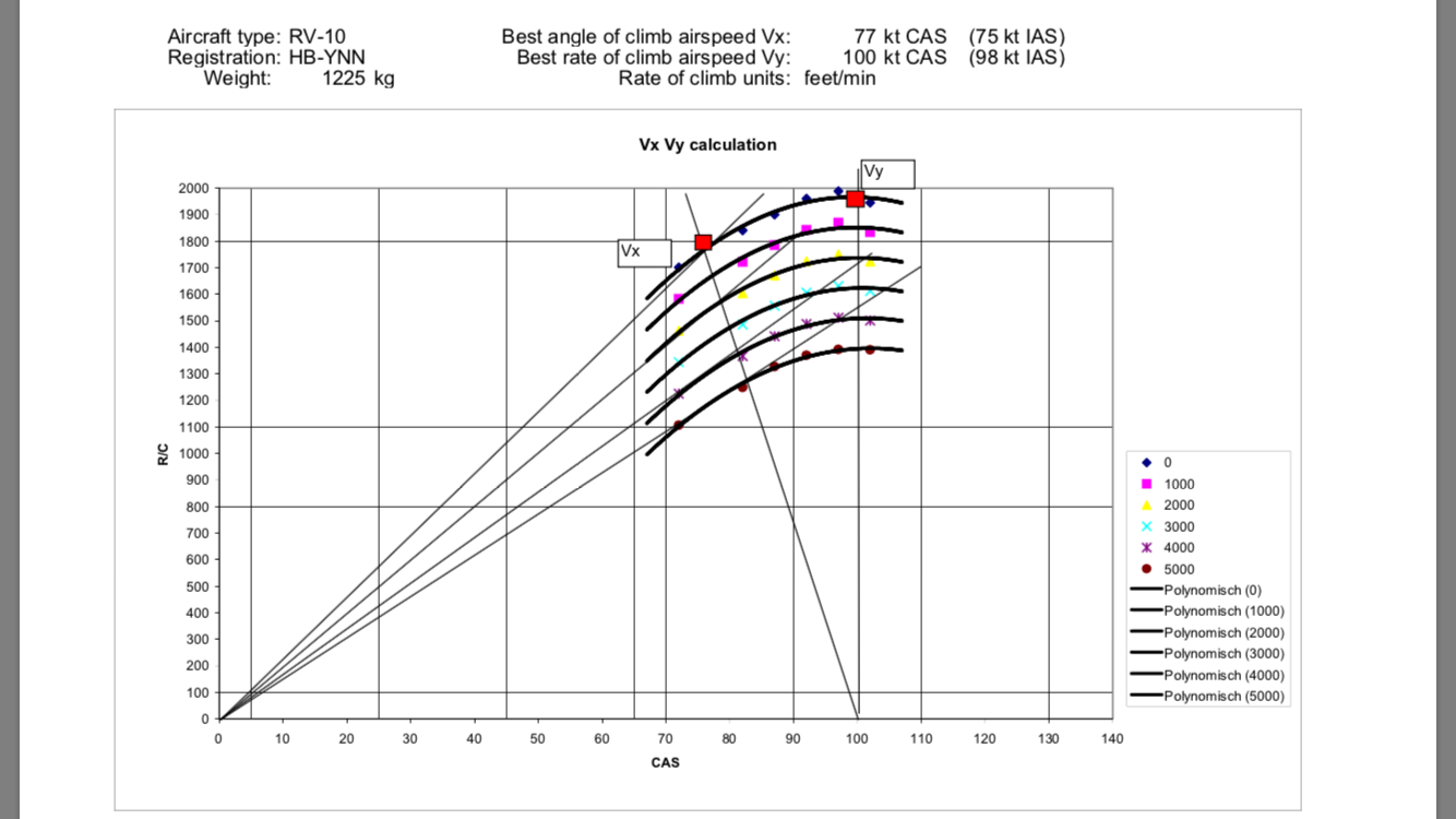

PostPosted: Tue Dec 13, 2016 10:33 am    Post subject: Re: What flap setting do you use for takeoff Reply with quote
Attached my Vx / Vy measurements during Phase I it was done with flaps 0 degrees. Would be interesting to see what it would be with 10 or 15 degrees.

PostPosted: Tue Dec 13, 2016 11:50 am    Post subject: What flap setting do you use for takeoff Reply with quote
Mike, just redo your testflights and send the data to Andre Smile and then
you will know.
Cheers Werner

PostPosted: Tue Dec 13, 2016 12:07 pm    Post subject: Re: What flap setting do you use for takeoff Reply with quote
Great idea if I ever find the time but an even better suggestion you do it during your Phase 1, just get the -10 done quickly 😉
Saanen LSGK 🇨🇭

PostPosted: Tue Dec 13, 2016 12:34 pm    Post subject: What flap setting do you use for takeoff Reply with quote
I would do that for you but might need help for finishing the remaining
90% Smile
But wait, there is Gordon he should be close Wink
Cheers
Werner
