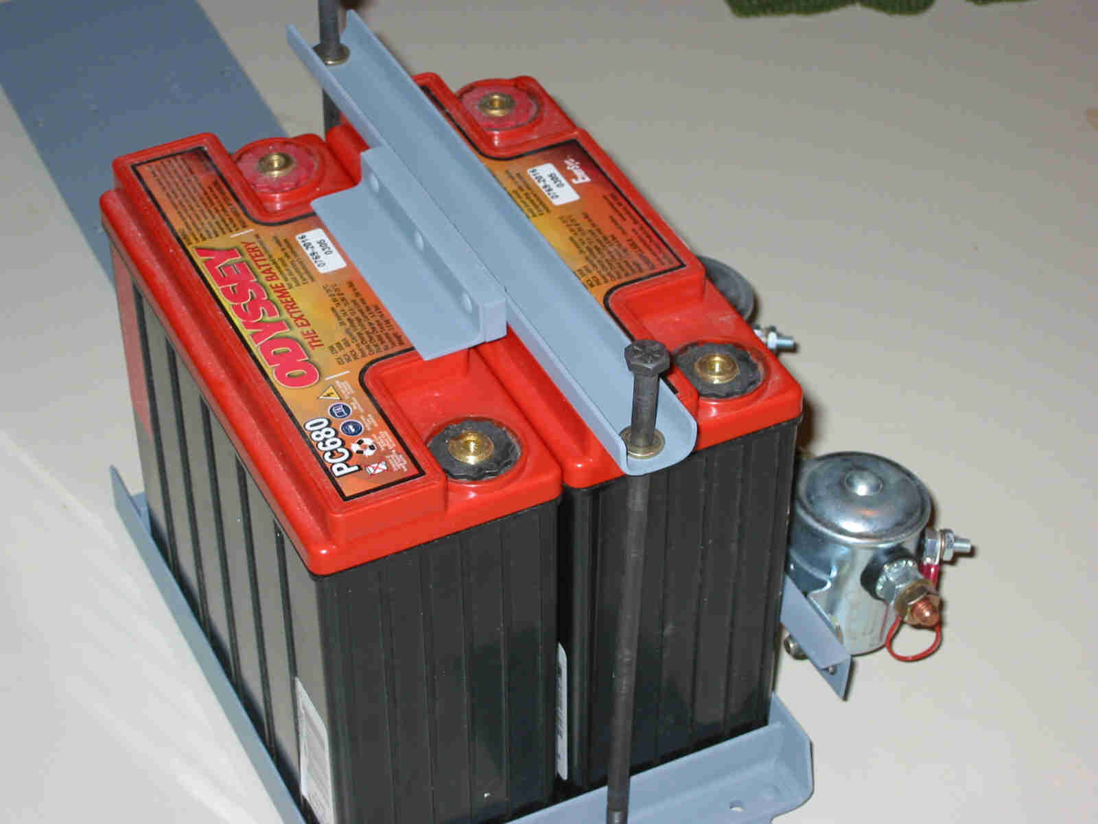

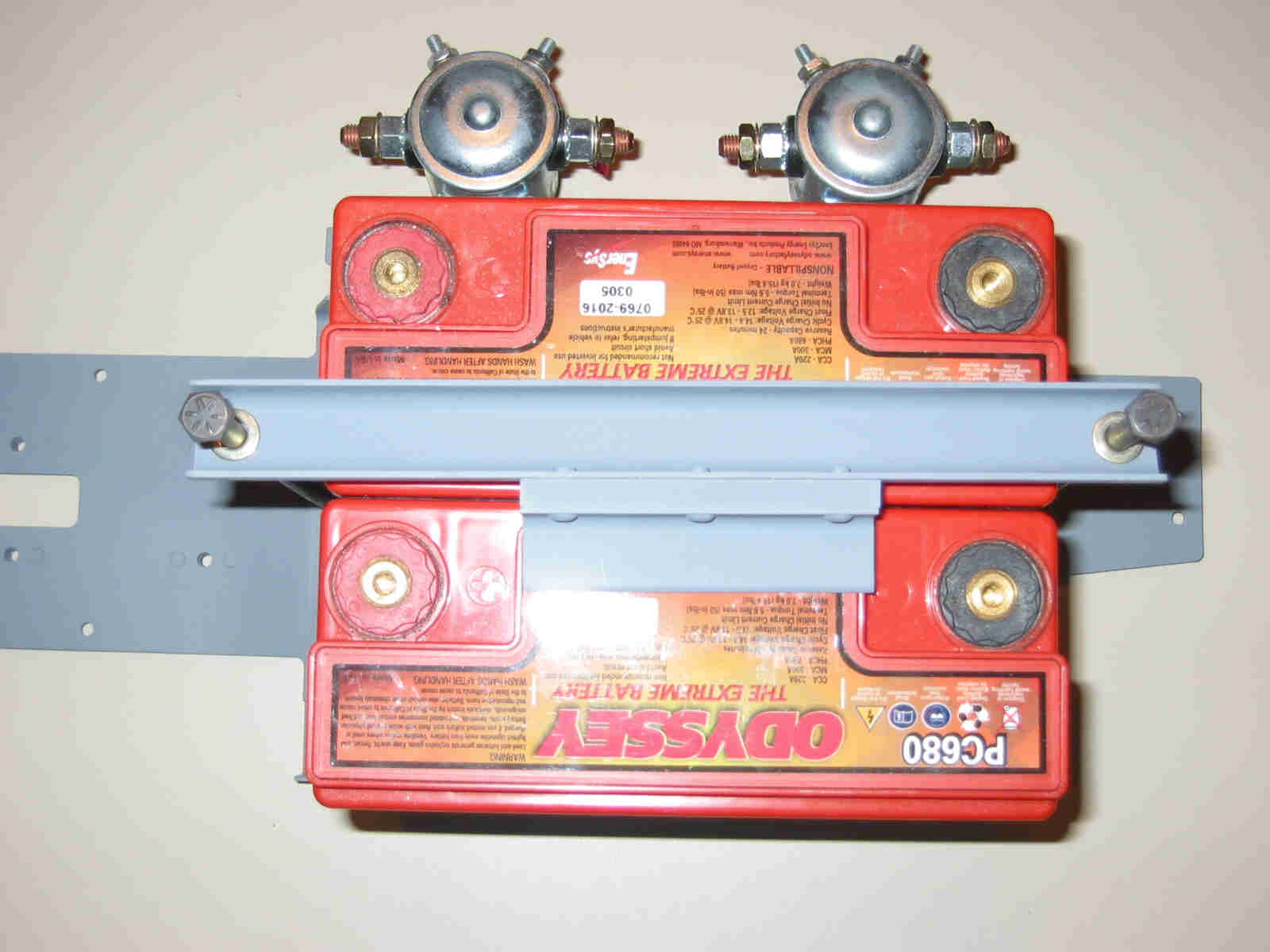

I studied the archives a bit and found that several of you have installed dual batteries. I cannot find any pictures of how the mods were made. Does anybody have pictures of their battery mods??? I have not decided on which batteries I will use yet. Do I need to know this before I build the tray???

Here’s what I did, batteries are a pair of PC-680s. Not a problem to mod the tray later.
