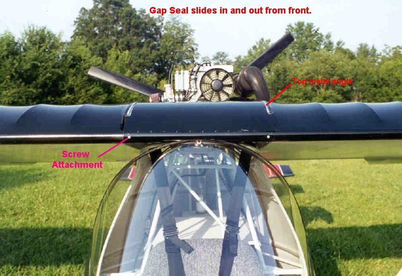

Here's a couple of pictures of the gap seal that I made for mine....
I didn't make it clear because I sit so far in front of it...
Gotta Fly...
PS Oooops I just saw you said Ultrastar....I don't know if these pictures
will help...

Hmmm, y'know, I know some people have alum gap seals but I never thought of
doing it that way until I saw your pictures, it looks nice. Actually it
might work better on the US since the engine's not above the wing, it could
be one piece all the way to the trailing edge on top... and I have all this
extra aluminum from another project... gotta think about this.
thought of
| -Dana
Dana:
Some of us were using aluminum sheet gap seals in 1984 on our US's.
The nylon gap seals did not last long in a UV environment. We had to
come up with a good alternative.

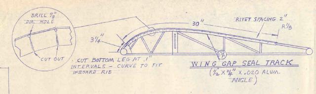

Gap seal pictures.

One thing you will need to check before you use Possums method, is whether
your wings are the same distance apart front and back. I didn't build my
plane, (probably would not have been any straighter if I had) but there was
about 3/4 inch difference wider in the back of the wing. It was very tight
to get in, and not supported in the back. A wider runner would have solved
the problem, however I didn't notice until I had already mounted the
runners.
