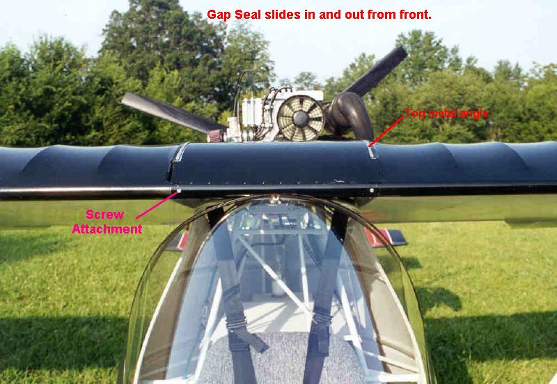

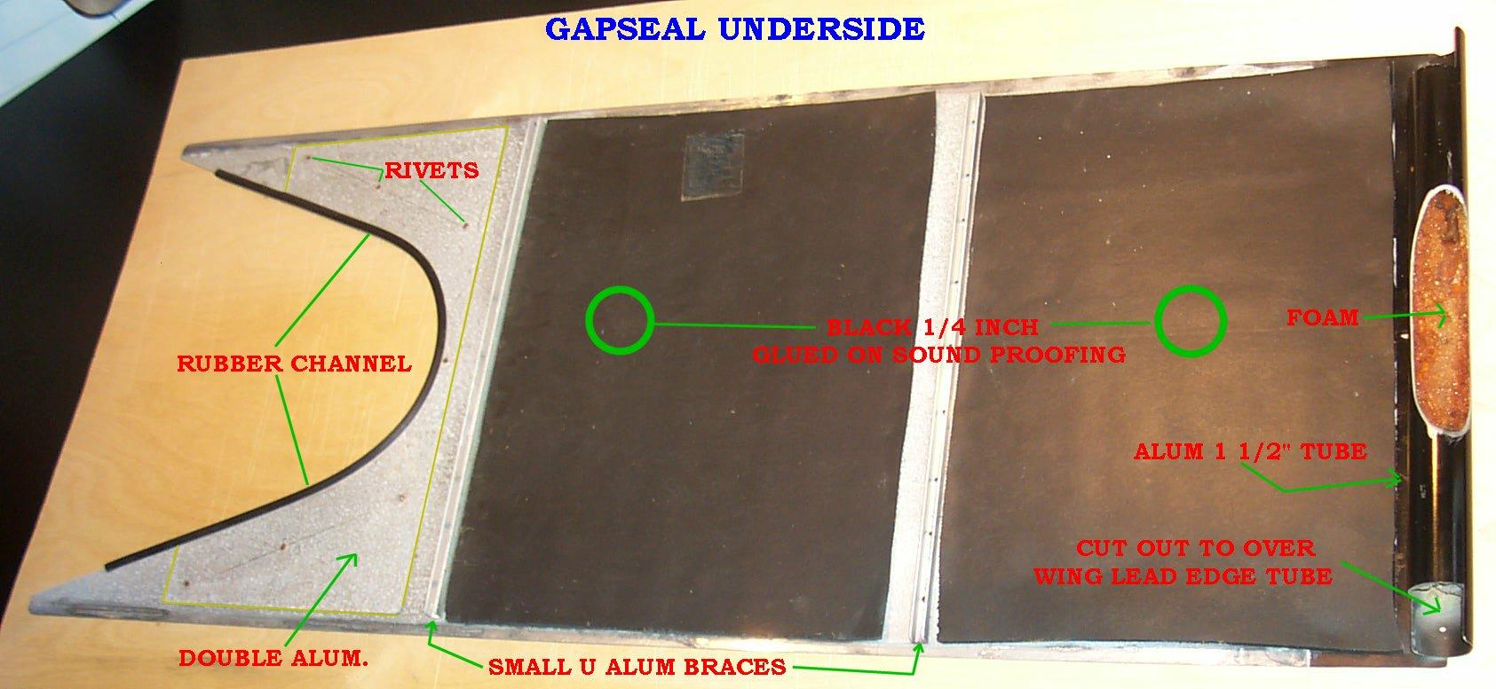

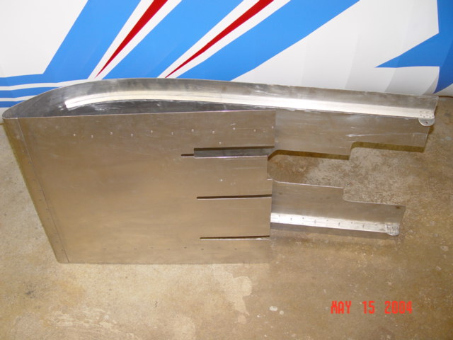

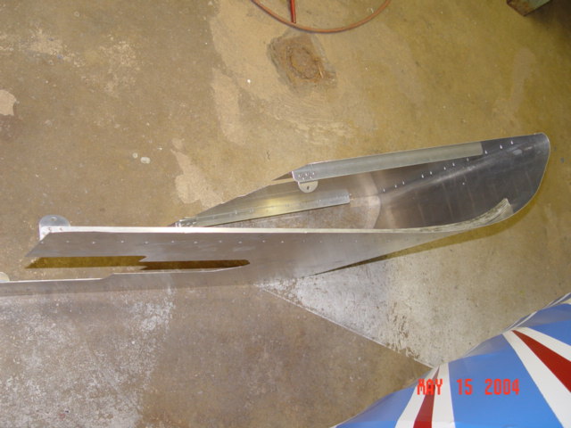

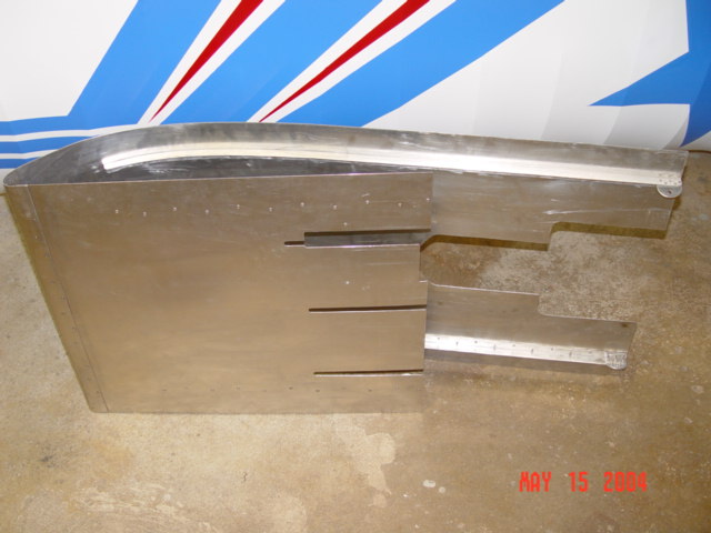

PostPosted: Mon Jan 08, 2007 5:15 pm    Post subject: Re: Wing center section questions Reply with quote
Here's a couple of pictures of the gap seal that I made for mine....
I didn't make it clear because I sit so far in front of it...
Gotta Fly...
PS Oooops I just saw you said Ultrastar....I don't know if these pictures
will help...

d-m-hague(at)comcast.net
PostPosted: Mon Jan 08, 2007 5:55 pm    Post subject: Wing center section questions Reply with quote
.PS Oooops I just saw you said Ultrastar....I don't know if these pictures
will help...
Hmmm, y'know, I know some people have alum gap seals but I never thought of
doing it that way until I saw your pictures, it looks nice. Actually it
might work better on the US since the engine's not above the wing, it could
be one piece all the way to the trailing edge on top... and I have all this
extra aluminum from another project... gotta think about this.
-Dana

PostPosted: Mon Jan 08, 2007 6:49 pm    Post subject: Wing center section questions Reply with quote
thought of
| -Dana
Dana:
Some of us were using aluminum sheet gap seals in 1984 on our US's.
The nylon gap seals did not last long in a UV environment. We had to
come up with a good alternative.

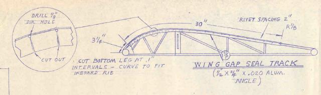

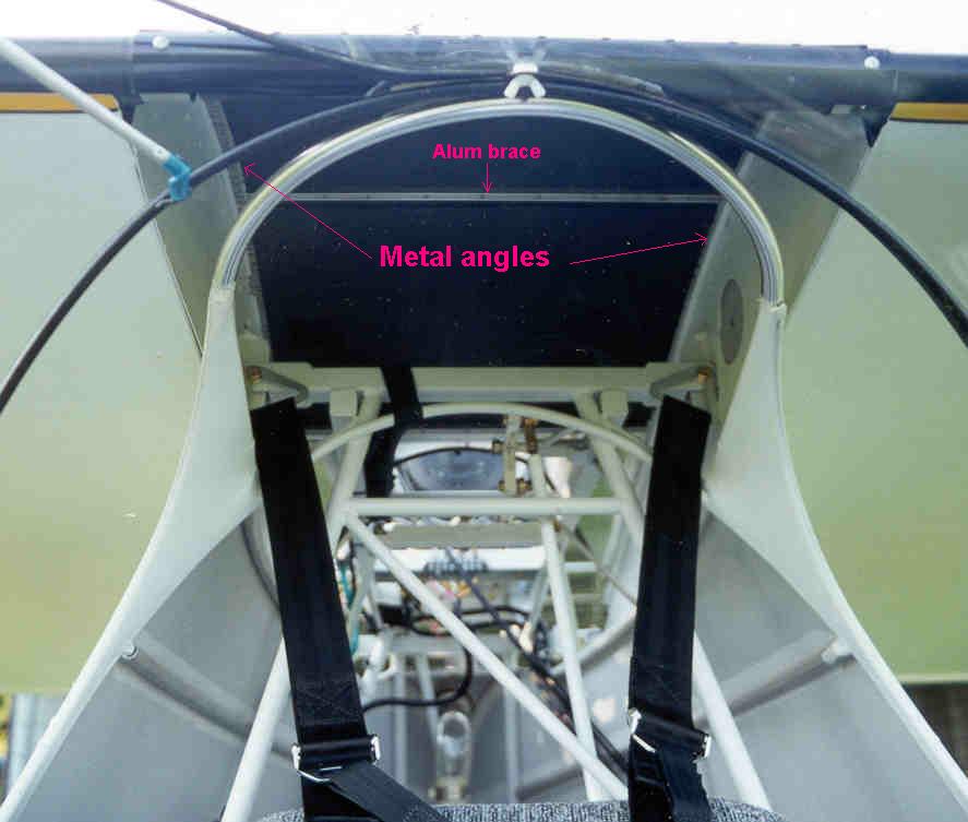

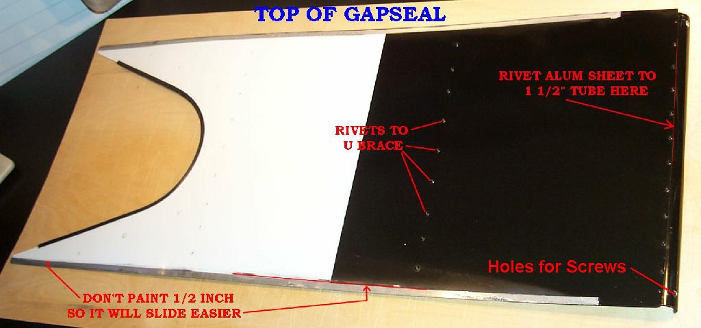

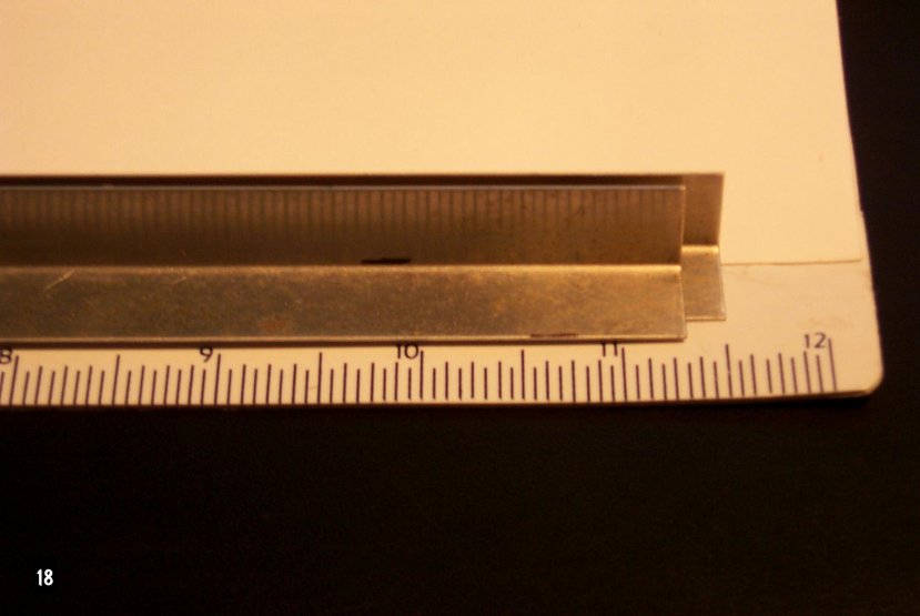

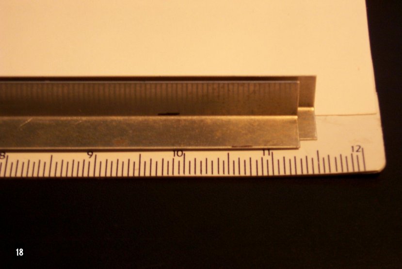

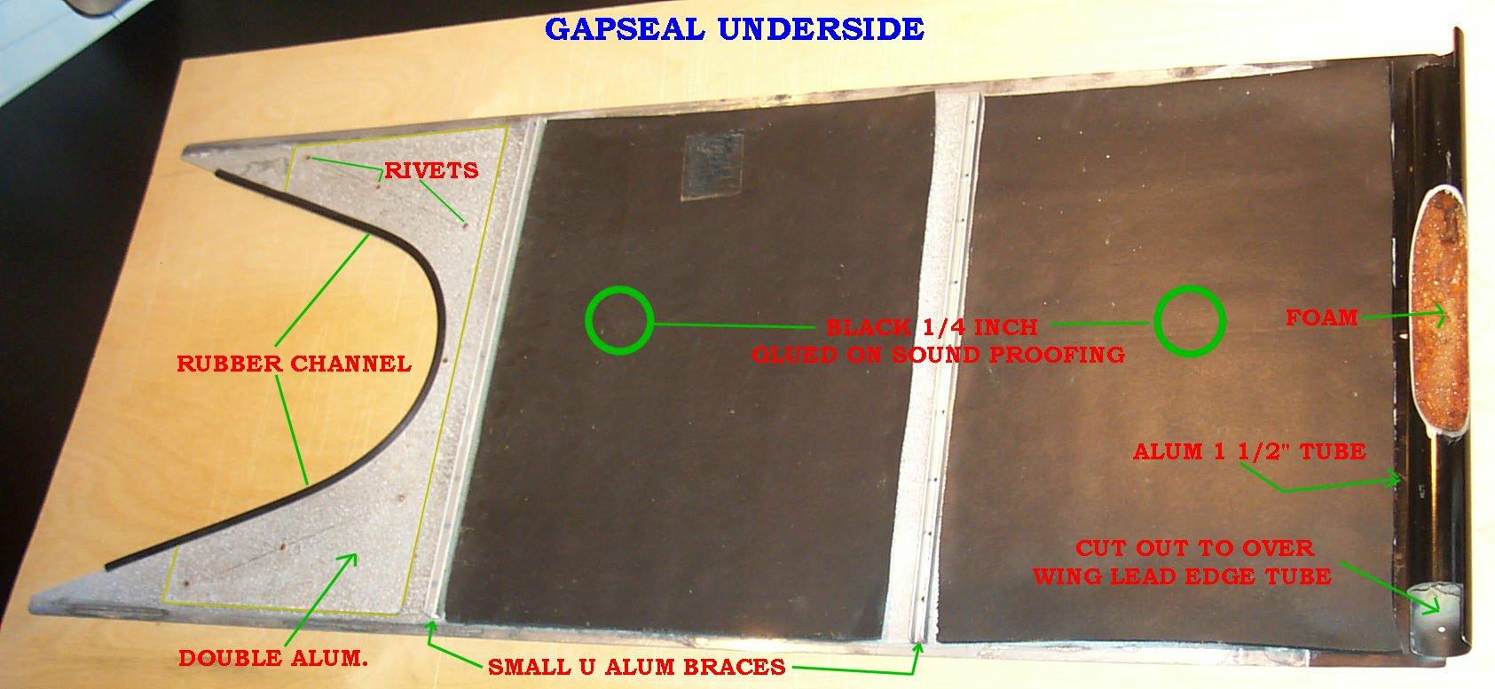

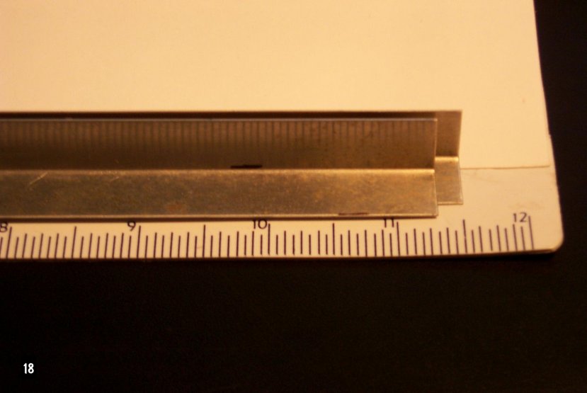

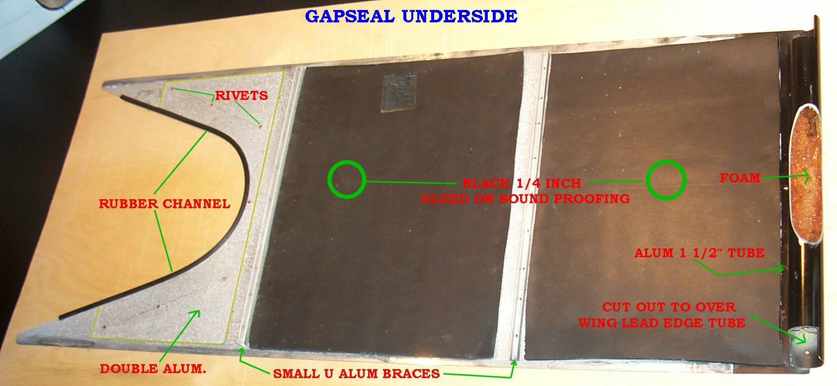

PostPosted: Tue Jan 09, 2007 6:16 am    Post subject: Wing center section questions Reply with quote
At 07:18 PM 1/8/2007, you wrote:
Working through various bits on my new old Ultrastar, and more confusion.
1. I didn't get a center gap seal with the plane;
Gap seal pictures.
 Filesize:  19 KB
 Viewed:  335 Time(s)
 Filesize:  143.43 KB
 Viewed:  346 Time(s)
 Filesize:  49.5 KB
 Viewed:  331 Time(s)
 Filesize:  41.74 KB
 Viewed:  345 Time(s)
 Filesize:  45.28 KB
 Viewed:  365 Time(s)
 Filesize:  77.68 KB
 Viewed:  337 Time(s)
GapInstr.doc
Download
 Filename:  GapInstr.doc
 Filesize:  20.5 KB
 Downloaded:  393 Time(s)

PostPosted: Tue Jan 09, 2007 8:10 am    Post subject: Wing center section questions Reply with quote
One thing you will need to check before you use Possums method, is whether
your wings are the same distance apart front and back. I didn't build my
plane, (probably would not have been any straighter if I had) but there was
about 3/4 inch difference wider in the back of the wing. It was very tight
to get in, and not supported in the back. A wider runner would have solved
the problem, however I didn't notice until I had already mounted the
runners.
