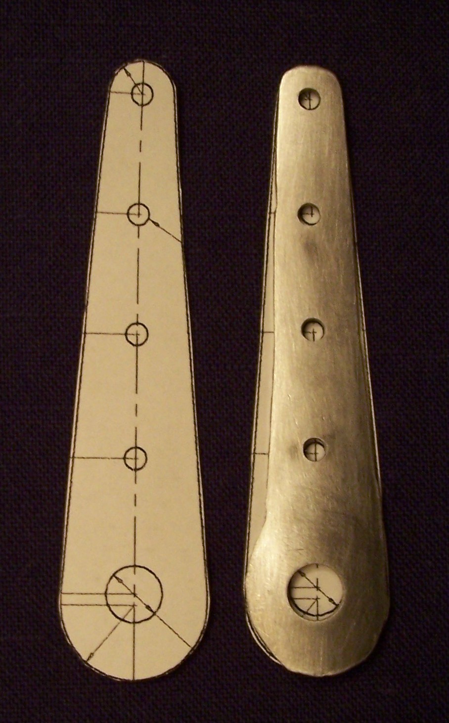

OK, this is my first post here on Matronics, so please forgive me if I break some cardinal rule. I tried to make my first part #22003 Rear Spar Attach Reinforcement (for Model 4-1200) and I think I may have shaved off a wee bit too much metal. I will try to attach a picture of the part so that some of you experts can give me some guidance. At this point I am thinking that the part may still be used, but will have to be checked at every pre-flight.
Thanks in advance,
Kent

Hi Kent,
--- kentk <kentk25(at)yahoo.com> wrote:
| Quote: | OK, this is my first post here on Matronics, so
No problem. Here we have 1 Pope, 2 cardinals and a
whole lot of sinners.
| Quote: | Reinforcement (for Model 4-1200) and I think I may
Thanks in advance,
Kent
Right or wrong on this part will depend upon what you
have left, of course. I think I built 1.3 Kitfox's to
cover the "not quite good enough" parts I remade.
Some are remade just for looks, but if it is critical,
you don't want to be flying wondering if it is good
enough. Make a new one and be sure. To me, the rear
attachment falls into the "make sure" category rather
than the preflight check category.
Let's see what others say.
But go ahead and attach a pic, if nothing else than
for practice, and confirmation from all on what they
would do. We like to discuss stuff here....

Kent please hit the attach button and show us the part. May or may not be a
problem, but we like to over analyse. Ron NB Ore

Is the image not showing up for anyone but me? If that is the case, here is the link to the photo:
http://forums.matronics.com/download.php?id=3526

Hey Kent
I wish I would have used the inserts. They look like a lot better way to do
it. If not just build some new parts. Spar attach points tend to be
important.
Good luck
Albert

It's an important part, not too hard to remake, and someday there will be a "next" owner who may not know to check this on pre-flight. If your A&P or FAA inspector see an example of workmanship like this, they'll start looking a lot closer, too. Besides, when it does crack, probably at the second hole, do you want to have to try to get it out once assembled? Easier to just re-make it now. Tip for next time: use the file lengthwise along the edges, not across it, and the edge will stay straight.

Thanks for the direct link to the image. First congratulations on your
choice of airplane - the best Kitfox ever in my opinion for all the things
Kitfoxes are designed to do.
My suggestion would be to replace the part. A taper on a fitting like that
is designed to spread the forces evenly to the end. By essentially cutting
a notch on this one it creates a stress riser which could result in a
premature failure.
Where are you? Tell us about your project.

Well, first of all, thank you everyone for the excellent advice. I really don't want to use any inferior parts on my plane, but was also concerned about availability of replacement parts.
Last year I aquired this KitFox Model 4-1200 from a friend who originally purchased it back in '94. He had worked on the fuselage, but not much else. I live in College Station, TX and have an ASEL Private Pilot License. My flight experience is mostly Cessna 172 and 150s. I have some low wing hours, but prefer the high wing. I have zero tail dragger experience.
So, at this point I am focused on building the wings. The kit did not include the engine nacelle (nor anything FWF for that matter), so I am undecided as to which powerplant to use and which prop arrangement is best. I am very much in the research phase at this point.
Kent

Hi Kent,
I used the BlueSky spar inserts on my model 5 and am very pleased with the
results. I thought that if any one area of the aircraft should be over
designed the spar attach point was it. My aeronautical engineer son agreed.
Joel

Regarding Spar Attach Reinforcement,
Not to say one way is better then another.. but remember that the aircraft
was load tested and flight tested with these reinforcements. The
reinforcements didn't fail and to date there has not been an in-flight
structural failure of a Kitfox..

Kent,
After viewing the picture I would recommend remaking the attach bracket. While the one you made would 'probably' be okay, why take a chance. They're cheap parts and easier to do now rather than later. I used the 'cuff' thinking they would be an improvement, but the original design has never been an issue. I have a model V and probably have the original spar reinforcement pieces, but I recently moved and finding them may take a while. If you want them (and I can find them) they're yours, no charge. Does anyone know if the Series V(1400 lbs version) part is the same as the model IV part?
Rick

At 06:28 PM 1/5/2007, you wrote:
| Quote: | I tried to make my first part #22003 Rear Spar Attach Reinforcement (for
No question. Replace it. I know it's discouraging but you'll probably make
many, many parts twice or even three times during the construction of your
aircraft. Calling it a "kit" was optimistic at best. It's more of an
"assisted plans-built" aircraft.
