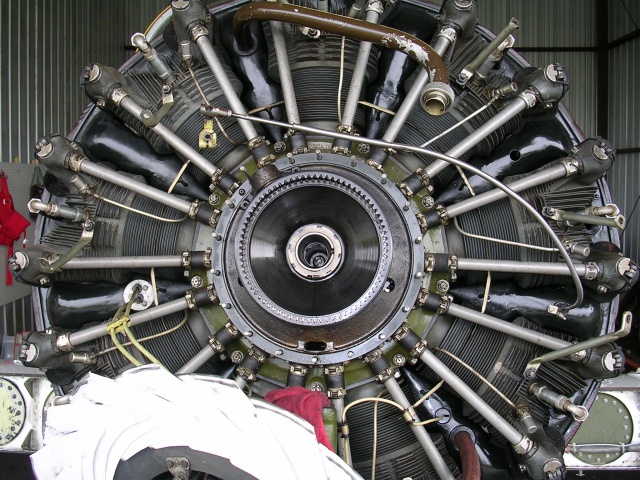

PostPosted: Mon Jan 30, 2006 3:27 pm    Post subject: Iris Instead of Grills Reply with quote
Hello Mark,
This is ANOTHER "Mark" so this is bound to get confusing.  Tim mentioned my experience in regard to flying without gills, so I thought I would bring my experiences in this regard to light.
There have been a number of people who have replaced the gill system with the IRIS system, and the conversion is fairly simple.  One thing to keep in mind is that there are two different types of systems for controlling the IRIS.  The original system found on most Sukhoi 26's and their ilk used two cables in semi hard tubes that each fed to a round wheel on the IRIS itself.  In the cockpit there is a control LEVER that pulls on one cable at a time... obviously as you pull on one cable (and put it into tension) the other moves backwards and is slack and at that point the wheel on the IRIS pulls keeping it taught.   Just picture two cables attached 180 degrees apart to the outer rim of a wheel and you'll get the picture.
The newer method (and more preferable by far) is found on the newer SU-31's, and uses a HARD TUBE PUSH/PULL ROD very close to what controls the original YAK prop and gills.  If you get the NEWER IRIS, you should be able to use the existing YAK control that comes on the aircraft that used to control your gills.
Ok, now the bad news.
My YAK-50 came with the Les Crowder big spinner mod. (I mean as in HUGE.. looks good though, and I have been told that this is really a YAK-18T spinner, but I don't know for sure).  Anyway, this mod required all the gills to be removed.
So, when I originally bought the aircraft, it had 110 hours on it since new, and away I went... no gills, no problem, who cares anyway?
After about 150 additional hours or so, I started getting all sorts of cracking on the cowling leading edges.  Then the hollow tubes that the front of the top and bottom cowling are riveted to, started cracking too.  This problem became more serious as time went on, because at the same time, the little red tubes/struts that hold the cowl MOUNTING ring in place started to crack and break TOO!  These are the little adjustable things that bolt to the front of each cylinder and go straight out to the cowl mounting ring.
At the time, I could not imagine what was causing all this.  When my cowl was closed, it closed fairly firmly on the front cowl ring I just described above.  I thought this might be the problem so I loosened everything up.  Wrong Answer. The problem got worse.
I put soft fabric material between the mounting ring and the cowl ring.... this helped a little, but it could still easily be seen that things were just vibrating too darn much.  I might also mention that my two bladed prop was also out of balance quite a bit.  Balanced the prop.... and that helped, but did not STOP the problem.
I then got the chance to study a YAK-52 up close and personal, and could see that those gills added quite a lot of support to that front cowl ring.  So, I made four adjustable struts out of stainless steel tubing.... identical in design and function to the ones coming straight out from the cylinder attachment points, but for these... I ran them out from the front of the engine supercharger cover (using the same mounting studs that the IRIS would attach to) HORIZONTALLY to the front cowl ring.  Four of them, one every 90 degrees.  These acted like spokes on a wheel, and gave back the support that the original gills had.
Result?  Problem cured.  No more cowling damage... problem is 100% FIXED.
This leads me to advise AGAINST putting an IRIS system on a YAK-50/52, UNLESS you also take additional steps to support that front cowl ring.  There are a lot of other factors involved here... such as: "What condition are your engine mounting rubbers in?"  Bottom line, the front of the cowls MUST MOVE WITH THE ENGINE, and if you take out the gills, you basically have a situation best pictured by imagining a person holding a HULA-HOOP out in front of himself with outstretched arms.  Then picture something/ANYTHING, "hanging from the hula-hoop itself"... you can see, there just is not any structural strength in that kind of assembly.  Put the gills in, and mount the gills to the engine itself, and you can see that the above picture regains all of its strength.
By the bye, this is yet another reason to keep those leather mounting pads in good condition that are located on the engine itself.  These ALSO provide quite an amount of structural support to the whole upper and lower cowl.
Sorry for the long post, but the details were needed in my opinion.
Mark Bitterlich
N50YK

PostPosted: Mon Jan 30, 2006 4:23 pm    Post subject: Iris Instead of Grills Reply with quote
Dont apologize, thank goodness for Yak/CJ related posts
On 1/30/06, Bitterlich GS11 Mark G <BitterlichMG(at)cherrypoint.usmc.mil> wrote:
Hello Mark,
your gills.
Mark Bitterlich
N50YK

PostPosted: Tue Jan 31, 2006 5:40 am    Post subject: Iris Instead of Grills Reply with quote
Un the Sukhoi and my SP the whole cowl is MUCH stronger than the standard 50/52 cowl. For example, the front of the cowl is shaped like a wing there is baffling on the inside of the cowl that gives great strength. Also there are support arms from all cylinders to the cowl (see attached picture) I bet you have wondered what those bolts on the front of the cylinder were for, well guess no more because they are the mounting for the support arms.
The diameter of the cowl opening is also slightly smaller hence the gap on a 52 cowl when the flaps are closed.
Hope this helps
Gus
Mark Bitterlich
N50YK
