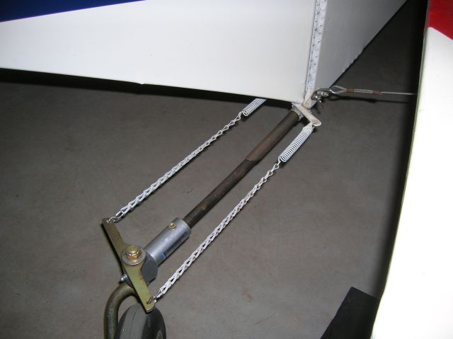

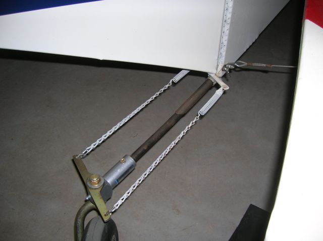

Sorry for the delay, I was wrestling hay rolls for my buddy and didn't get around to the photography until this morning.
It was a good thing to take a look at the strut since I was once again reminded that I haven't gotten around to painting it, yet. One of those, I want to fly right now, I'll do it up proper this winter items. And now it's winter. Anyway.
The tubing size for the outer sleeve is 3/4" X .058, the inner is 5/8" X .065. Frankly, it's a bit heavier than I would like and I'll probably go back to aluminum when I do take it off. It is stout, though, and won't bend, at least so far, under the worst "arrival" loads. Smile
Rick
Rick Girard
"Ya'll drop on in"
takes on a whole new meaning
when you live at the airport.

PostPosted: Thu Dec 28, 2006 9:21 am    Post subject: Tail wheel strut Reply with quote
Rick, is that a fully castering tailwheel in the photo? The TW on my
Firefly does not caster. If yours does caster, what is it and where can I
get one?
Jim

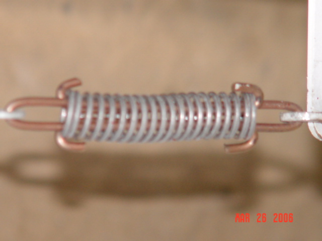

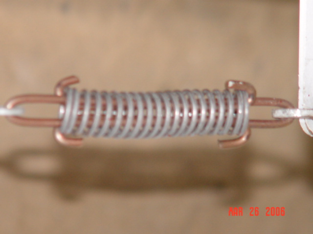

PostPosted: Thu Dec 28, 2006 11:48 am    Post subject: Re: Tail wheel strut Reply with quote
Hi Rick,
I notice you have the springs like the prints say....
Alot of us have changed them to the screen door type set up...
Mine are home made , others have bought theirs...
Here's a picture of mine , ( made with TIG welding rod )
Gotta Fly...
Mike in MN

jindoguy(at)gmail.com
PostPosted: Thu Dec 28, 2006 1:11 pm    Post subject: Tail wheel strut Reply with quote
Jim, I have the 6" full swivel from Aircraft Spruce. Travis has the 4" version, and may have the 6", too, at TNK.
Rick

PostPosted: Thu Dec 28, 2006 1:36 pm    Post subject: Tail wheel strut Reply with quote
Thanks. At Spruce I assume it's the one for 5/8" tubing and 10 degrees?
Jim

PostPosted: Thu Dec 28, 2006 2:17 pm    Post subject: Tail wheel strut Reply with quote
That's the one.
