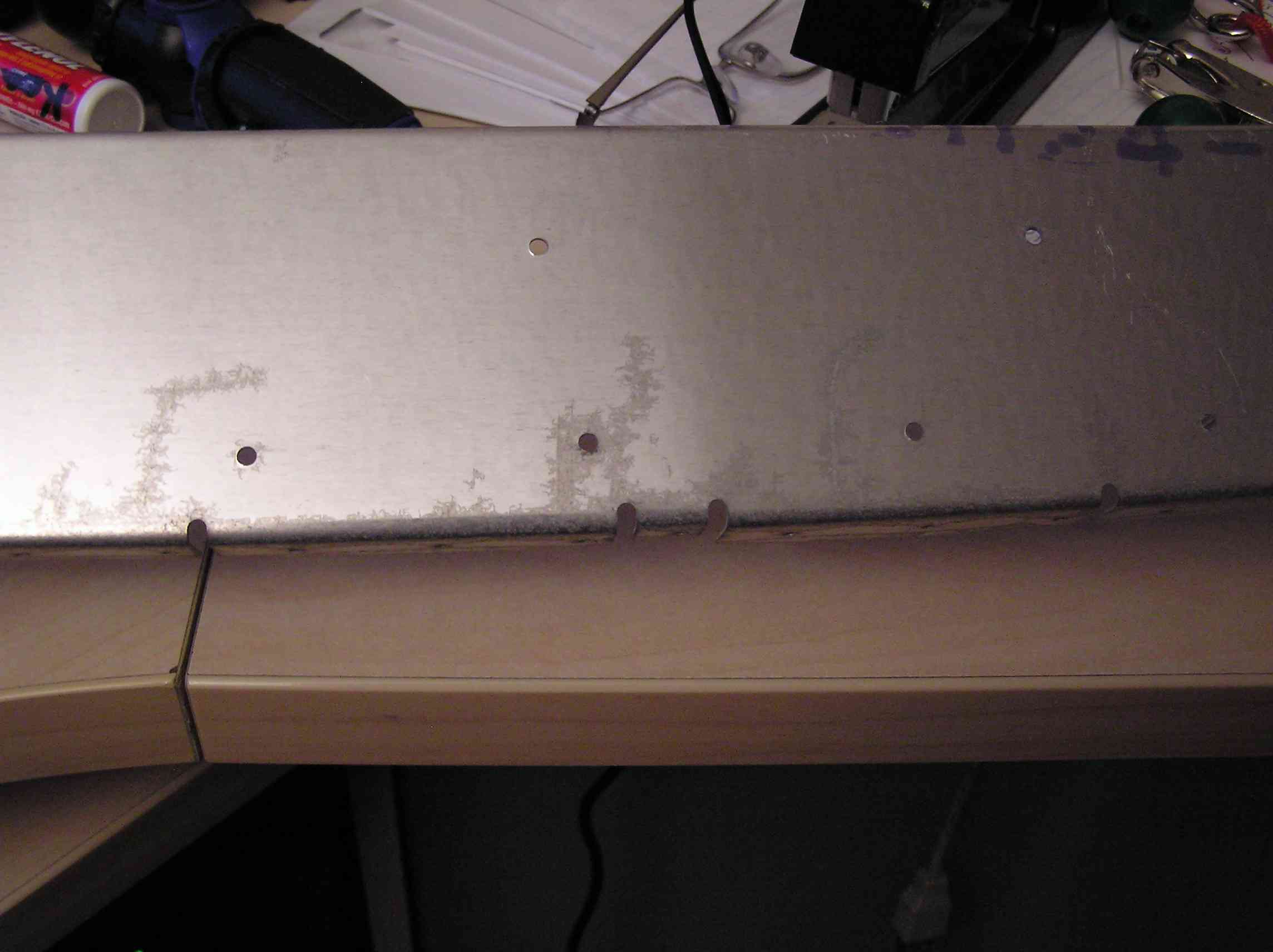

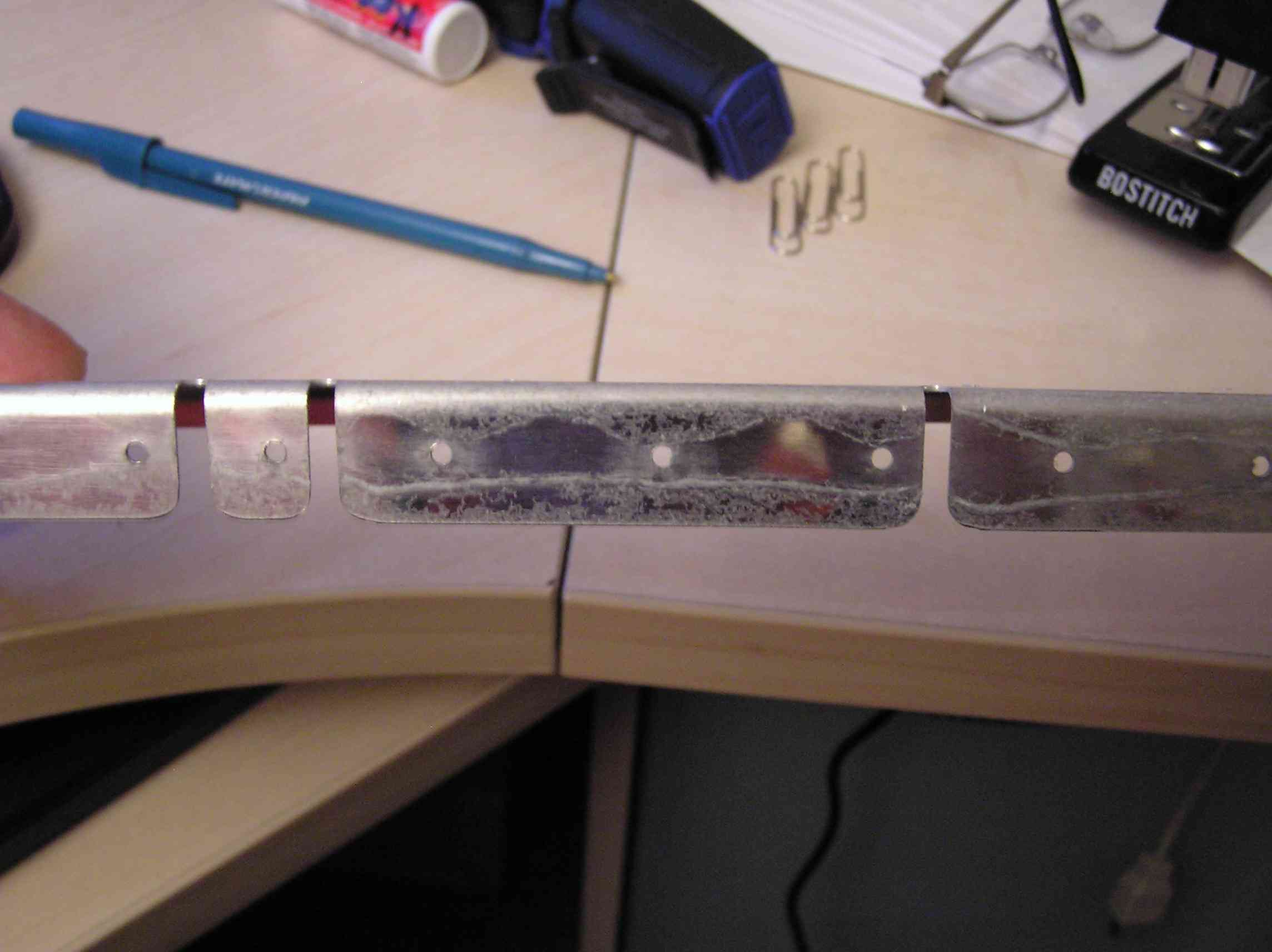

Hi
This evening I was starting to prep my tail cone parts. When removing the vinyl wrap, one piece had some unusual surface discoloration. I thought it might be some adhesive and tried removing it with lacquer thinner but to no avail. It looks like a mineral deposit of some sort. Is this surface corrosion and if so how to handle this.
I have attached a couple of pictures.
Inquiring minds need to know
Les Kearney

PostPosted: Wed Dec 27, 2006 8:44 pm    Post subject: Surface Corrosion? Reply with quote
Looks like filiform corrosion. I would talk to Van's and maybe replace the part.

john_rv10(at)yahoo.com
PostPosted: Thu Dec 28, 2006 2:28 am    Post subject: Surface Corrosion? Reply with quote
Hi Les,
Yes, that looks very much like filiform corrosion. You will find that alodine won’t take to that area.
A relatively painless but time consuming solution I found for the same problem is to remove the filiform corrosion with a small grinder with a felt pad with some aluminum polishing paste. This preps the surface for alodining then painting as you prefer. Other methods of removing the filiform corrosion I tried left the surface too marked for my liking.

gommone7(at)bellsouth.net
PostPosted: Thu Dec 28, 2006 4:12 am    Post subject: Surface Corrosion? Reply with quote
Hi Les,I did recive one of my wings bottom skins in the same conditions,it is a no brainer,I ask them if my dollars have some kind of surface corrosion,don't even ask what to do ,ask only for a replacement,that simple,

kearney(at)shaw.ca
PostPosted: Thu Dec 28, 2006 8:23 pm    Post subject: Surface Corrosion? Reply with quote
Hi Again
I spoke to Ken at Van’s who suggested I clean the filiform corrosion using a scotchbright pad. After some serious scouring, I got it off with the pad. That being said, I was most unhappy with the result as I was almost certainly well into the substrate and removed the ALCLAD layer. As a result I am concerned that it may lead to greater problems in the future especially if my priming is compromised during assembly. Van’s was quite happy to send out a replacement. As this is part of the forward tail cone bulkhead, this won’t have too big an impact on my build schedule.

PostPosted: Fri Dec 29, 2006 6:04 am    Post subject: Surface Corrosion? Reply with quote
The solution is to simply remove all of the plastic up front... Parts can't be
properly dimpled, riveted, or deburred with plastic in the way. In addition, if
you are planning to paint you'll end up buffing/sanding/scotch-briting every
inch of the surface anyway. So add lots of hours to an already long project by
oh-so-carefully removing plastic in nice straight lines?
If the corrosion is minor, just buff it out and move on. I had a few (one or
two) parts that also had this look and simply took a scotchbrite pad to it and
the primer did stick. No big deal as there are lots of other way harder things
to worry about.
