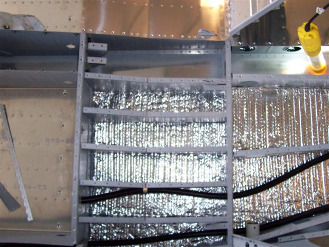

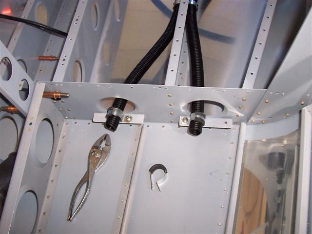

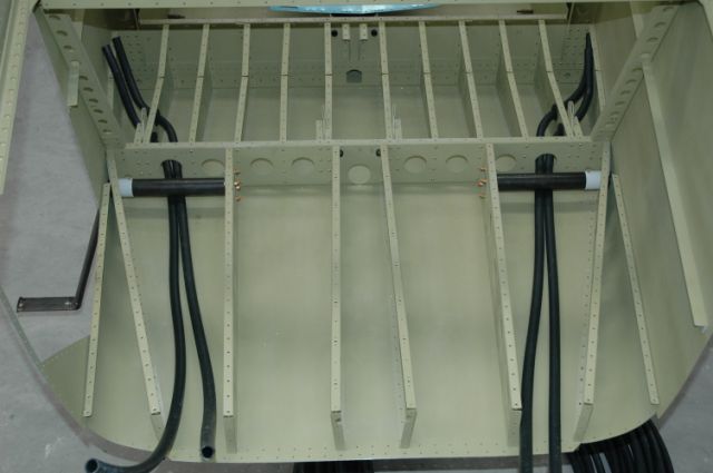

Niko,
I've done the same thing and supported the conduit under the baggage floor with adel clamps. #19 drill used midway along the baggage rib, #8 screw and nylok nut at each station. Works well. Also fabricated a bracket to support the conduit as is exits the rear bulkhead into the tailcone. Pics included.
John Hasbrouck

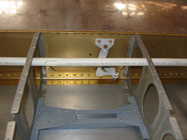

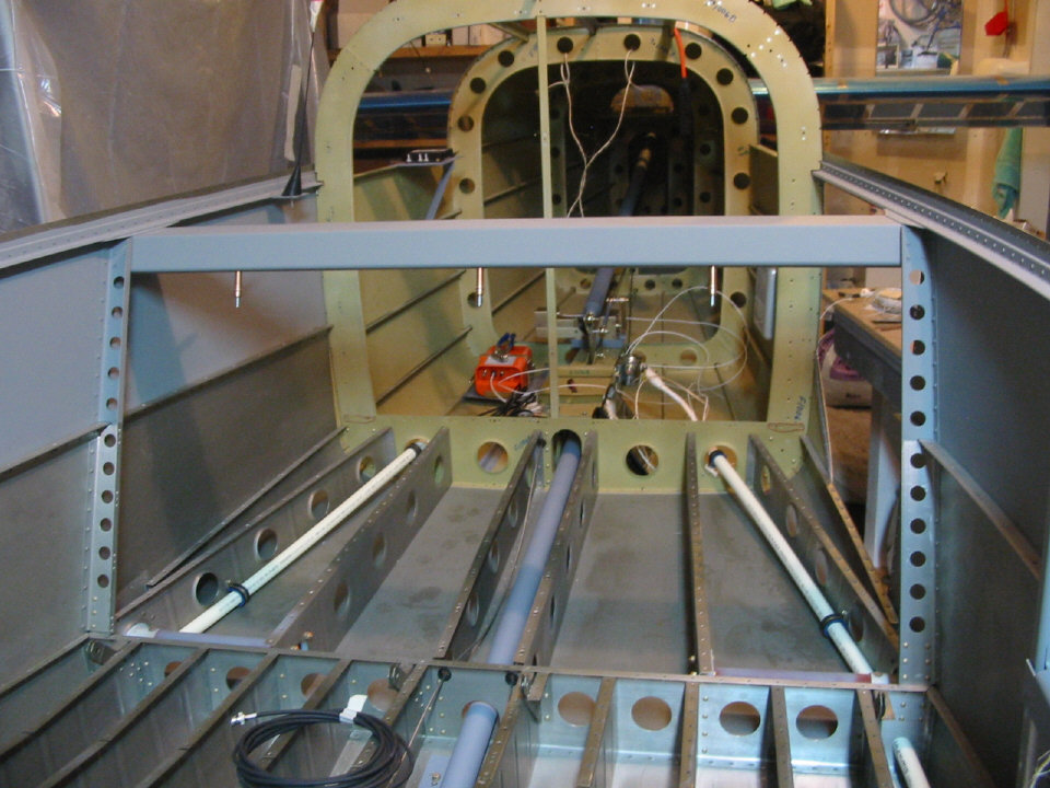

I put conduit under the baggage floor and supported it with adel clamps. However, I did not like the Van's conduit. It is too flexible, making it very difficult to route wire through. I bought 3/4" PEX pipe from the local plumbing store. It is more flexible than PVC, yet much more rigid than the corrugated black conduit. It is smooth on the inside and is just under 7/8" OD so it was easy to enlarge the holes with a 7/8" unibit. I also put the conduit down the full length of each wing, with a couple holes along the length to allow wires to exit.
PEX pipe is made for plumbing, so I did a non-scientific test to compare it to Van's conduit. I used a heat gun to simulate an overheating wire. Try taking a heat gun to the corrugated conduit: it shrivels up like shrink wrap. By comparison the PEX is quite a bit more robust when it comes to heat.
Photos attached.
wires to exit.
Photos attached.

Niko,
Photos attached.
Jim McGrew
