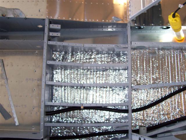

LarryRosen
Joined: 16 Jan 2006 Posts: 415 Location: Medford, NJ
Posted: Tue Oct 24, 2006 8:58 am Post subject: Fuselage Conduit Support |
I cannot comment on how supporting the conduit, but
Instead of drilling out the floor board, now may be the time to add an
access panel or 2 to the floor. I used the same parts that are used for
the wing stall warning access panel and installed them in the baggage
floor so I have future access to the step mounts. You can see photos
here
<http://lrosen.nerv10.com/Construct/Log/Fuselage/FloorAccessPanels/index.html>.
Michael Sausen used them in a different place in the baggage floor.
Photos are here
<http://www.mykitlog.com/users/display_log.php?user=msausen&project 2&category=613&log=15783&row=15>
I may add some additional access panels if and when they are needed.

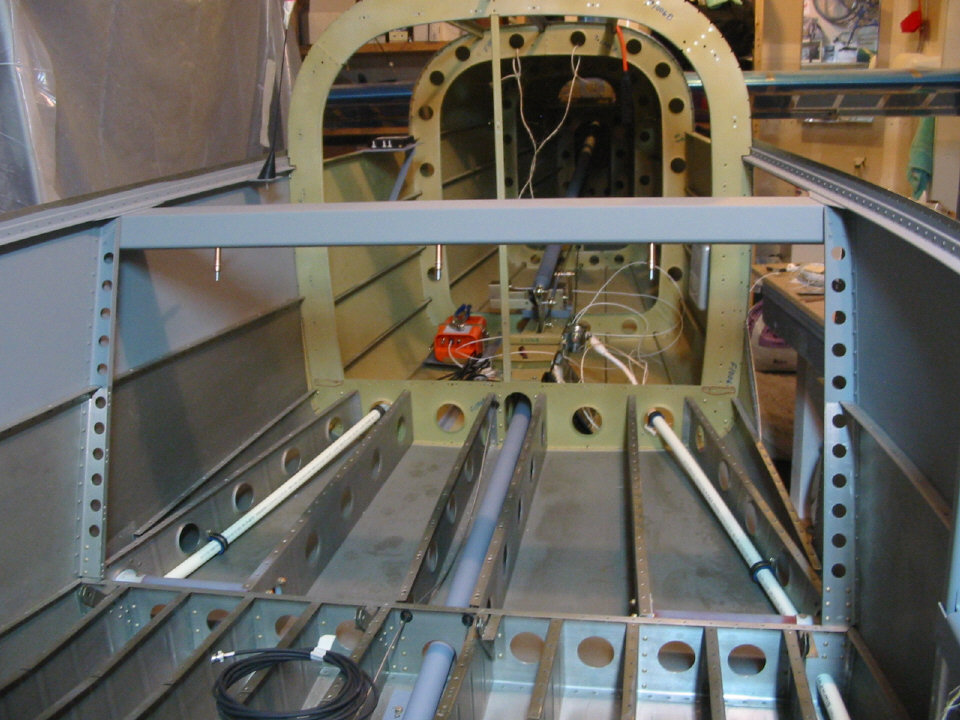

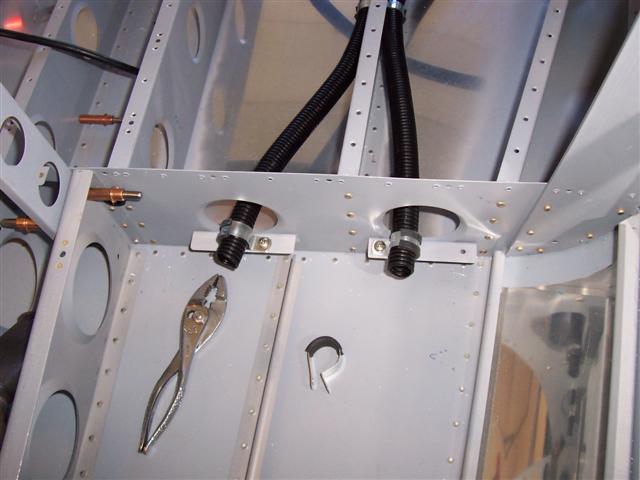

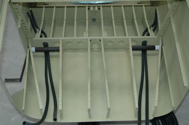

jhasbrouck(at)woh.rr.com Guest
Posted: Tue Oct 24, 2006 10:27 am Post subject: Fuselage Conduit Support |
Niko,
I've done the same thing and supported the conduit under the baggage floor with adel clamps. #19 drill used midway along the baggage rib, #8 screw and nylok nut at each station. Works well. Also fabricated a bracket to support the conduit as is exits the rear bulkhead into the tailcone. Pics included.
John Hasbrouck

jesse(at)itecusa.org Guest
Posted: Tue Oct 24, 2006 11:10 am Post subject: Fuselage Conduit Support |
This is what we did, but we used thicker-wall (stiffer) conduit with a smooth inside. We made a bracket at the back of the baggage compartment to hold them with cushion clamps, tied them off to the step support, and used grommets in the holes going through the ribs and the rear seat floors. There’s no such thing as too much conduit IMHO, especially with a 2AWG welding wire battery cable completely filling one.

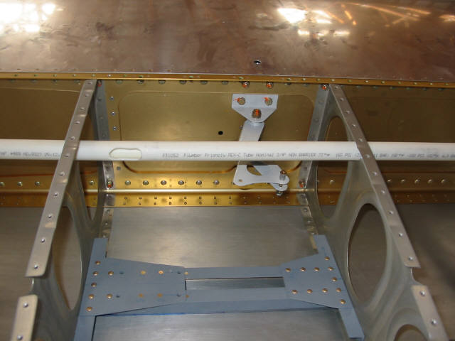

ScooterF15
Joined: 19 Jun 2006 Posts: 136
Posted: Tue Oct 24, 2006 5:35 pm Post subject: Fuselage Conduit Support |
I put conduit under the baggage floor and supported it with adel clamps. However, I did not like the Van's conduit. It is too flexible, making it very difficult to route wire through. I bought 3/4" PEX pipe from the local plumbing store. It is more flexible than PVC, yet much more rigid than the corrugated black conduit. It is smooth on the inside and is just under 7/8" OD so it was easy to enlarge the holes with a 7/8" unibit. I also put the conduit down the full length of each wing, with a couple holes along the length to allow wires to exit.
PEX pipe is made for plumbing, so I did a non-scientific test to compare it to Van's conduit. I used a heat gun to simulate an overheating wire. Try taking a heat gun to the corrugated conduit: it shrivels up like shrink wrap. By comparison the PEX is quite a bit more robust when it comes to heat.
Photos attached.
Photos attached.
