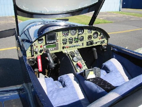

All the opinions I've read are good and worthy ones. In my case, as a CFI I'm used to switching hands and going between wheels and sticks and having to stretch across the cockpit to reach things. For most of my career I owned a Cessna and an Aeronca Champ (still have the Champ.)
I chose to go with the center stick for 1.) Simplicity 2.) Comfort (nice armrest leading up to the stick instead of curling your hand in your lap.)
3.) Easier entry and exit. To deal with the other issues I will simply design my panel for easy placement of controls (and duplicate some on the right) and install a single axis autopilot to do the flying when I need my hands or am otherwise engaged. Anyone who has flown single pilot IFR and tried to copy clearances, twist radios and the like while in IMC knows the value of an AP. If you don't want an AP, remember the "poor man's auto pilot" (rudder pedals) which can be used to keep the wings level on an otherwise properly trimmed AC.
In the end, there is no best choice..... just go with what works for you.

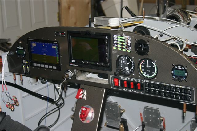

  - The Zenith-List Email Forum - -->   - NEW MATRONICS WEB FORUMS - -->   - NEW MATRONICS LIST WIKI - -->   - List Contribution Web Site - Thank you for your generous support!     -Matt Dralle, List Admin. -->
 Filesize:  54.01 KB
 Viewed:  673 Time(s)
 Filesize:  63.59 KB
 Viewed:  684 Time(s)

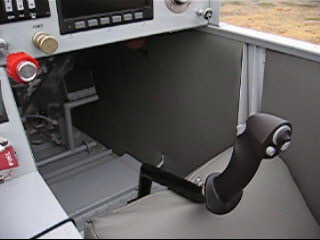

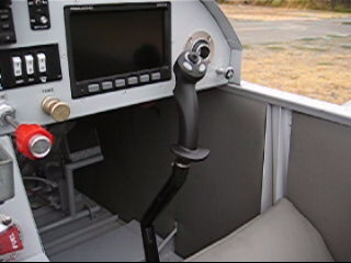

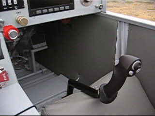

PostPosted: Sun Oct 01, 2006 7:55 pm    Post subject: dual sticks in 601XL Reply with quote
I wondered the same thing. I sat in Bob Archibald's XL (Dragonfly Aviation)
and ran the stick to all four extremes, shooting a movie with my digital
camera. It will hit the seat if pulled way back. But after flying the plane
I saw how sensitive the controls were. If you pulled the stick back a
quarter of that distance you would (with enough power) loop the plane.
The whole movie is 7.6 megabytes. If anyone wants it, let me know and I will
e-mail it to you.
-- Craig

In a message dated 10/1/2006 11:57:03 P.M. Eastern Standard Time, craig(at)craigandjean.com writes:
e-mail it to you.
-- Craig
Sigmo(at)aol.com
PostPosted: Sun Oct 01, 2006 9:07 pm    Post subject: dual sticks in 601XL Reply with quote
The stick movement in actual flight is very small but to get full movement the seat cusion needs to be relieved the same as an RV or other similar dual stick aircraft.
Mike Sigman
PostPosted: Sun Oct 01, 2006 10:19 pm    Post subject: dual sticks in 601XL Reply with quote
If you look through AMD's photo gallery you will see many pictures of dual-stick planes they have built without cut-outs in the cushions.
www.newplane.com/amd/amd/601_SLSA/photo_gallery.html
-- Craig
