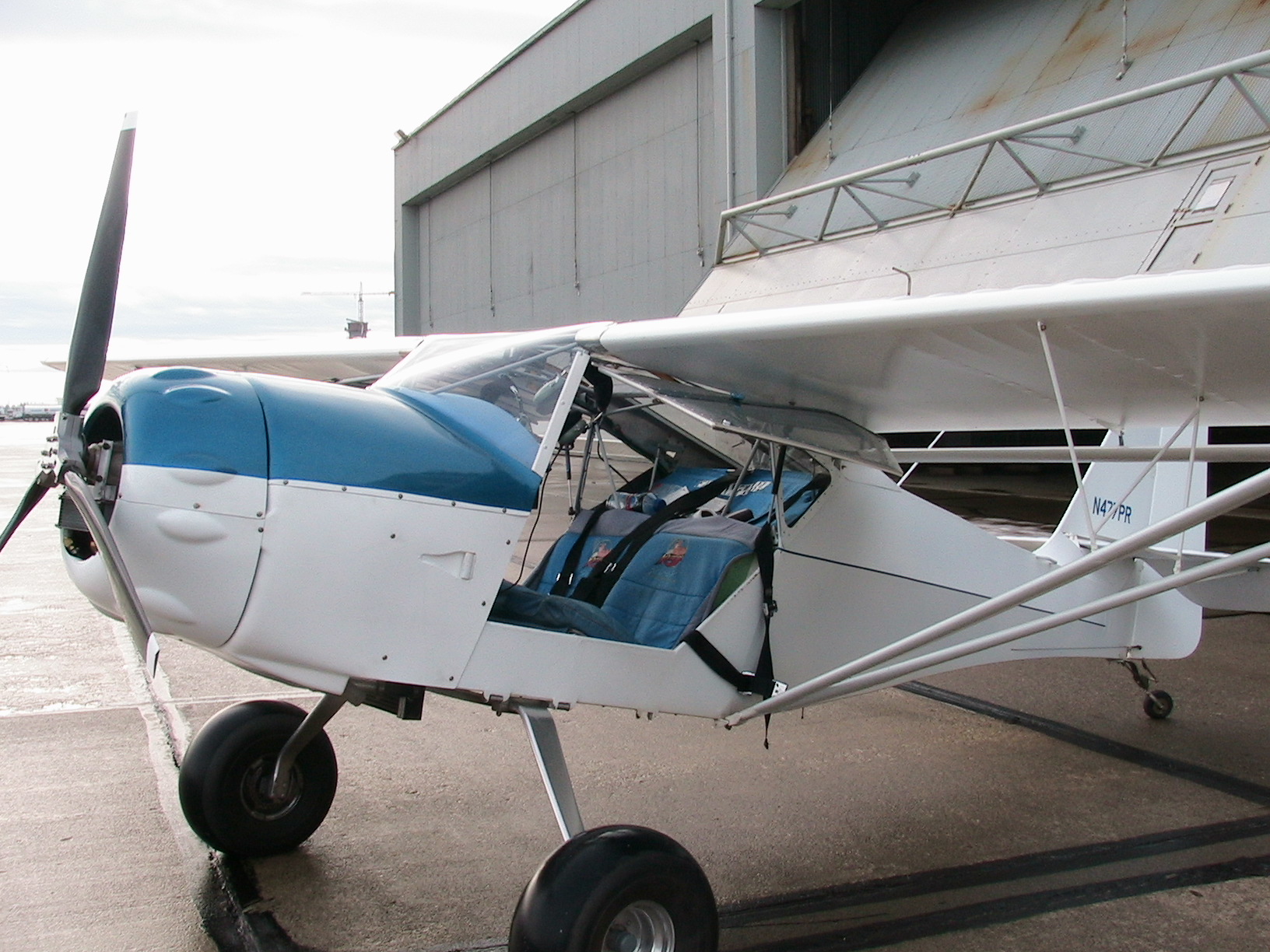

PostPosted: Sat Aug 26, 2006 11:29 am    Post subject: Re: tail wheel Reply with quote
this is the best pic of my wheel, not sure what it is, but it works great. Just for a tip, on landing with a tail wind, I know somebody mentioned having troubles doing such a thing. When I land with the wind at my back, you fly in as normal, don't slow up more, cause the landing speed will be faster, you maintain normal glide and decent and when your ready to flair, put in an extra amount of power, just a little, cause if you don't, chances are you will drop out about 5 ft off the ground, at least in my plane you do. Another thing, be ready on the rudder, cause your going to be a little faster than normal on the roll out, so correct as soon as it's needed.
