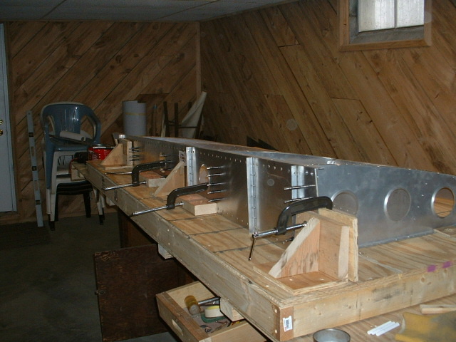

I must be losing my ability to0 communicate, because my question was "How many clecos will I actually need to0 complete my fuselage", not "How to I keep from warping the wings". I already0 learned that lesson the hard way- attached is a picture of how I prevented0 it. (118K)
My point is, if you're following0 the manual sequentially, you leave off building the center wing with everything0 in clecos and move on to the fuse. All right, I'm going to follow the0 instructions.

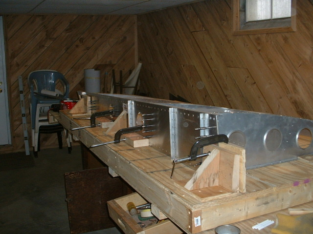

As far as alignment is0 concerned, I did everything with a 5' level and shims. Once everything was true,0 I clamped the skeleton down on the bench with the L fixtures shown0 in the first picture. I don't think it's a matter of making sure everything0 is laser true, but making sure the sucker doesn't move once you start reefing on0 it. As a matter of fact, I'm positive! Gotta remember the 601 series was designed before anyone other than the military could afford a laser0 level.
Someone asked how you fix a0 warp. Disgustingly simple. You tear everything apart to the point where you can0 get rid of the warp, salvage what you can, and either order Zenith "Oops" parts0 or learn how to fabricate them yourself. This is the point where some of us0 realized they would have been just as far ahead building from scratch from the0 start.

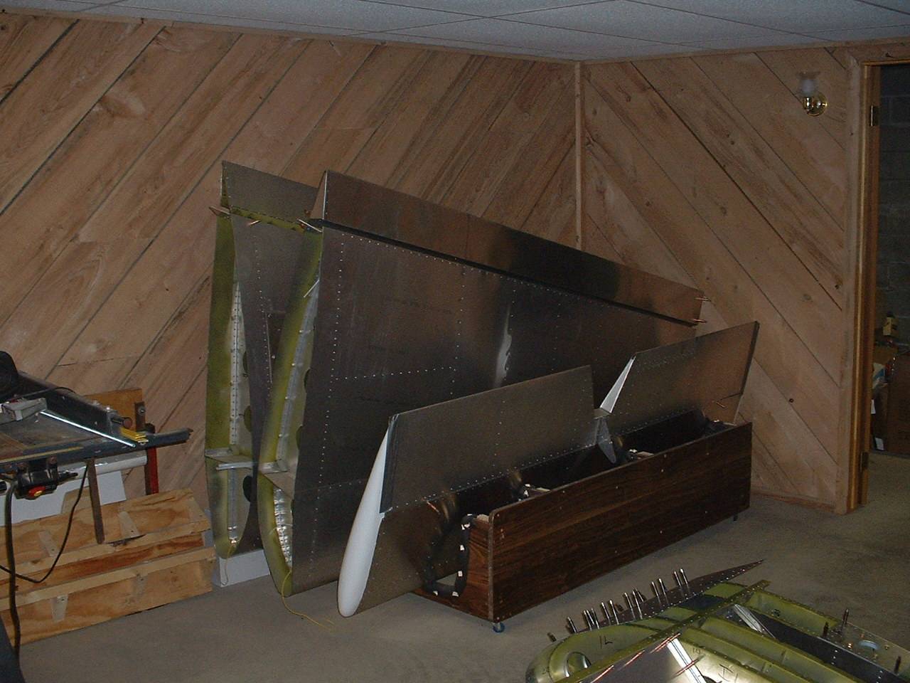

The first picture shows a0 scratchbuilt kit right outboard wing- 90% scratch, 10% kit. Damn near all I0 could salvage was the sheet part of the spar and a couple of rear ribs. Second0 picture of the finished products attached. As you can see, there are a batch of0 clecos behind held hostage. The picture was taken when everything was still in0 the basement.
