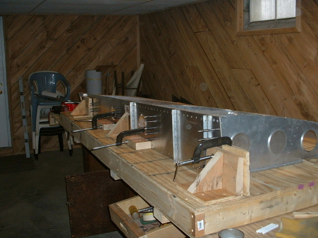

I hope what I'm doing is adequate... I just used a0 smart level to make certain that the main and rear spars were the same amount0 off level before rivetting. I may be missing something but I think folks get way0 too excited about having things plumb level or at a particular angle0 relative to plumb. I look at it this way..... once it's flying, it won't necessarilty be at any of those carefully guarded angles will it? But it damn0 well better be at the right angles relative to other parts of the0 airplane!
In answer to your question..... buy a herd of0 them.... particularly the black ones. About 250 - 300 silver..... about 300 -0 350 copper...... and about 350 - 400 black. The silver and copper ones will sell0 to anyone who builds an RV and when the -12 hits the market so will the black0 ones. That's my 2 bits worth,

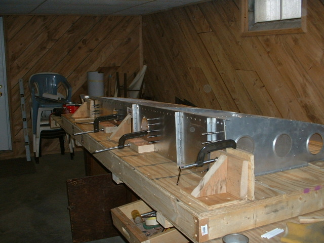

As far as alignment is0 concerned, I did everything with a 5' level and shims. Once everything was true,0 I clamped the skeleton down on the bench with the L fixtures shown0 in the first picture. I don't think it's a matter of making sure everything0 is laser true, but making sure the sucker doesn't move once you start reefing on0 it. As a matter of fact, I'm positive! Gotta remember the 601 series was designed before anyone other than the military could afford a laser0 level.

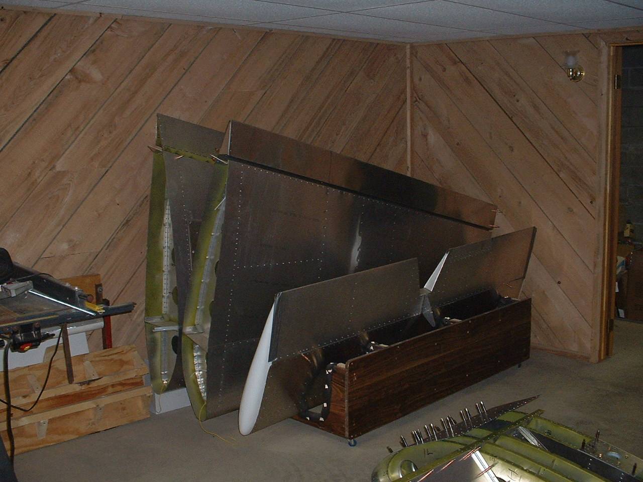

Someone asked how you fix a0 warp. Disgustingly simple. You tear everything apart to the point where you can0 get rid of the warp, salvage what you can, and either order Zenith "Oops" parts0 or learn how to fabricate them yourself. This is the point where some of us0 realized they would have been just as far ahead building from scratch from the0 start.
The first picture shows a0 scratchbuilt kit right outboard wing- 90% scratch, 10% kit. Damn near all I0 could salvage was the sheet part of the spar and a couple of rear ribs. Second0 picture of the finished products attached. As you can see, there are a batch of0 clecos behind held hostage. The picture was taken when everything was still in0 the basement.
Back to my original question for0 people who have completed a 601 project- how many black and gold clecos did you0 own when it was all over????

The first picture shows a scratchbuilt kit right outboard wing- 90% scratch, 10% kit. Damn near all I could salvage was the sheet part of the spar and a couple of rear ribs. Second picture of the finished products attached. As you can see, there are a batch of clecos behind held hostage. The picture was taken when everything was still in the basement.
Back to my original question for people who have completed a 601 project- how many black and gold clecos did you own when it was all over????
