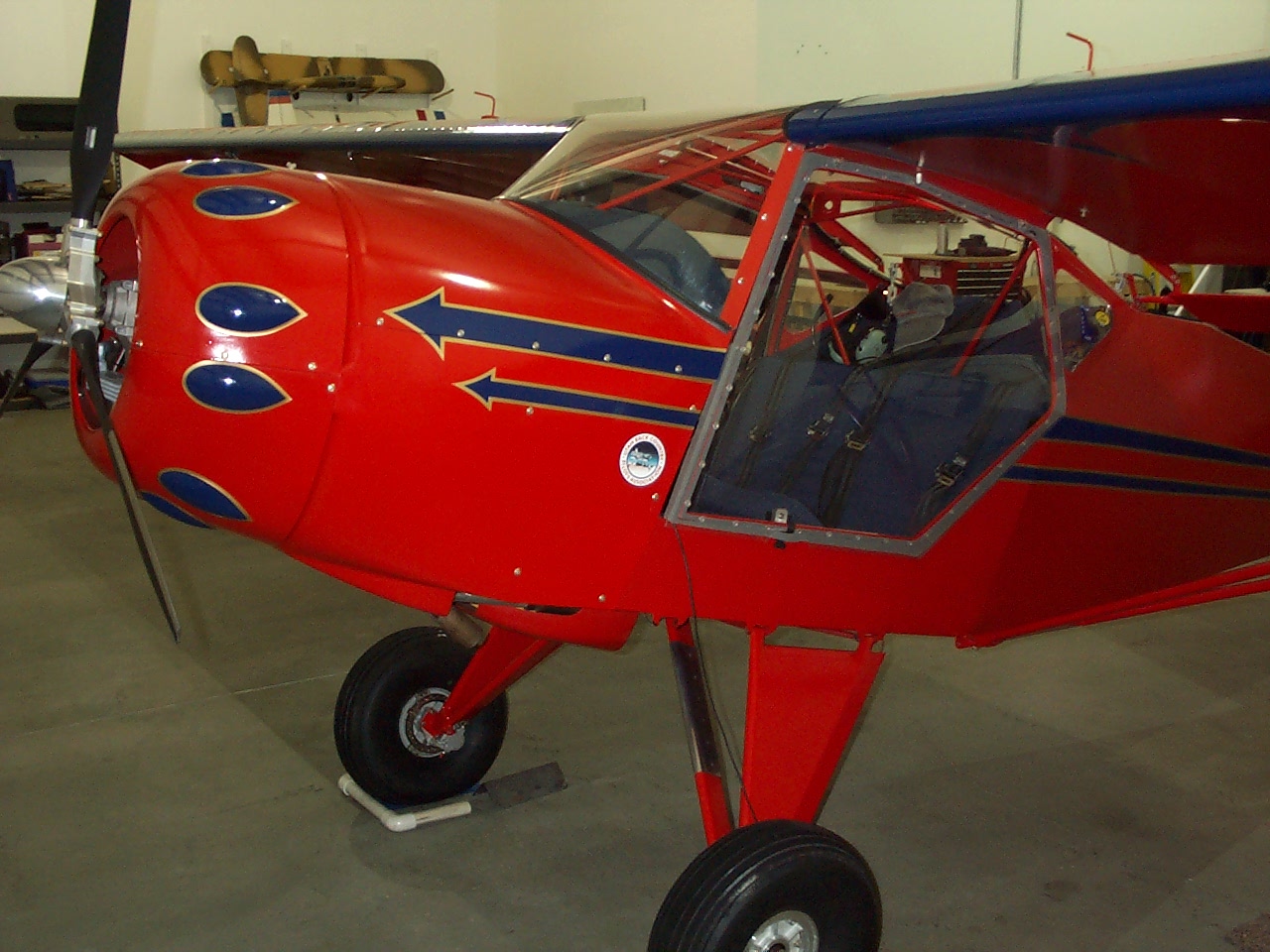

Steve,
The bubble doors are the only way to go on a Fox! They add about 3" of shoulder room on each side and they give incredible visibility. You can get them from John McBean at kitfoxaircraft.com or direct from lpaero.com. The shipping is not cheap (neither are the doors) so be prepared. I just ordered a pair for my Series 7 and the doors were $217 each and shipping was $87! They are worth it in my mind. Below is a picture of my model III (not mine anymore...sold it).
Darin

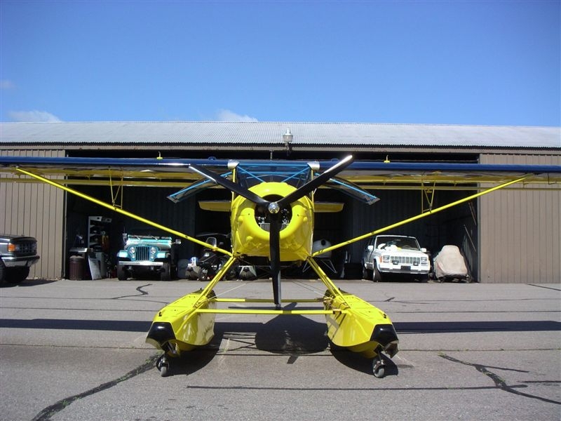

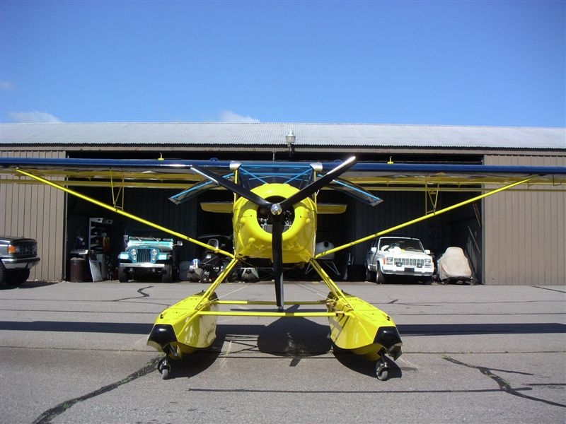

My float equipped Model IV with LP Aero bubble0 doors does not act like my old Avid Flyers or older Kitfoxes with the0 undercambered airfoil and the less bubbled doors do. The early0 airplanes flew just fine with the doors open or closed, or removed0 completely. In summer I rarely flew with doors0 closed. My Kitfox IV on the other hand needs to be slowed down to 800 mph or less in order to open the doors without them slamming up against the0 bottom of the wing (causing not only potential door glass damage,0 strut damage, and door frame twisting, but also the glass rubbing against the0 bottom of the wing fabric effectively scuffs [sands] the door0 glass). So I do not fly with the doors open on my Kitfox at this0 time. To correct this concern I am going to make a bracket that is0 held in place by the wing tank fuel drain fitting, that will let the0 door rest against it (probably will have a rubber pad where it touches0 the glass) when the door is completely open. Maybe it's just my Kitfox,0 but I thought I would share this with the group should someone else experience0 the same problem.
If my attachments go through (?), here are two0 photos that show how the bubble doors fit when full open against0 the bottomside of the laminar flow Riblett wing. The bubbles0 definitely limit your ability to get them up against the wing0 bottom.

The NACA scoops on the side of my cowl (see pics in0 previous post) really provide a lot of fresh air. So much in fact they0 will blow papers around in the cockpit if not stowed. And I don't mean a0 little, but a lot! A couple of days ago I had to retrieve a map from the0 back turtledeck area that was blown back there after I set it down on the0 passenger seat while flying. Even in the 97 degree 97% humidity0 weather we endured here in Wisconsin this summer, I was generally able to0 stay cool. (yes, I just had to go flying when it was that hot. I0 wanted to see how well my fox would perform off the asphalt, as well as the0 water under those conditions. I was pleasantly surprised...)
Opening the doors a half inch or so does seem0 to be an easy way to get a lot of fresh air, but overall I've found the0 NACA scoops to be equally effective. Not only do they give0 you a lot of air, but they blow it right on you. So if you are0 still building, or are considering modification, I highly recommend putting them0 in.
On a last note; A friend of mine with a model0 III Kitfox installed the rotating scoops that fit in the lexan. But he0 installed his on top of the cabin (right in the windshield lexan) right above0 the front carry through tube. Being they pointed directly into the0 slipstream, they worked well also. And if he didn't want them he just0 turned them backwards, or pulled them in altogether, closing them0 off. Just another idea. Would be an easy modification to any0 existing airplane.
Paul Seehafer

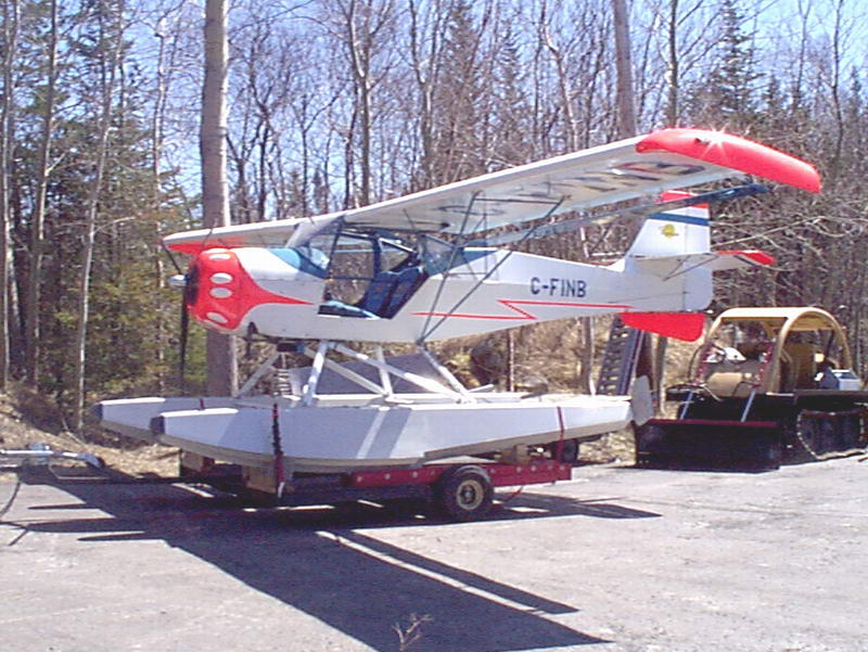

That's a very nice plane you0 have there. I was wondering about your prop. It looks like an0 Ivo. Is it in-flight adjustable?
I have the Aerocet straight0 floats on my 582 B box powered mod III-A. They are a hard act to follow on0 the water. I haven't tried the Full Lotus floats yet but I can't see0 how they would handle better on the water than the Areocets. I would love0 to have the amphibs. If you ever decide to sell those floats keep me in0 mind.
