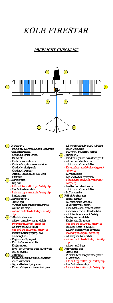

David,
I picked this one up off of someone's website I don't remember who's....
Hope it helps..
Mike
