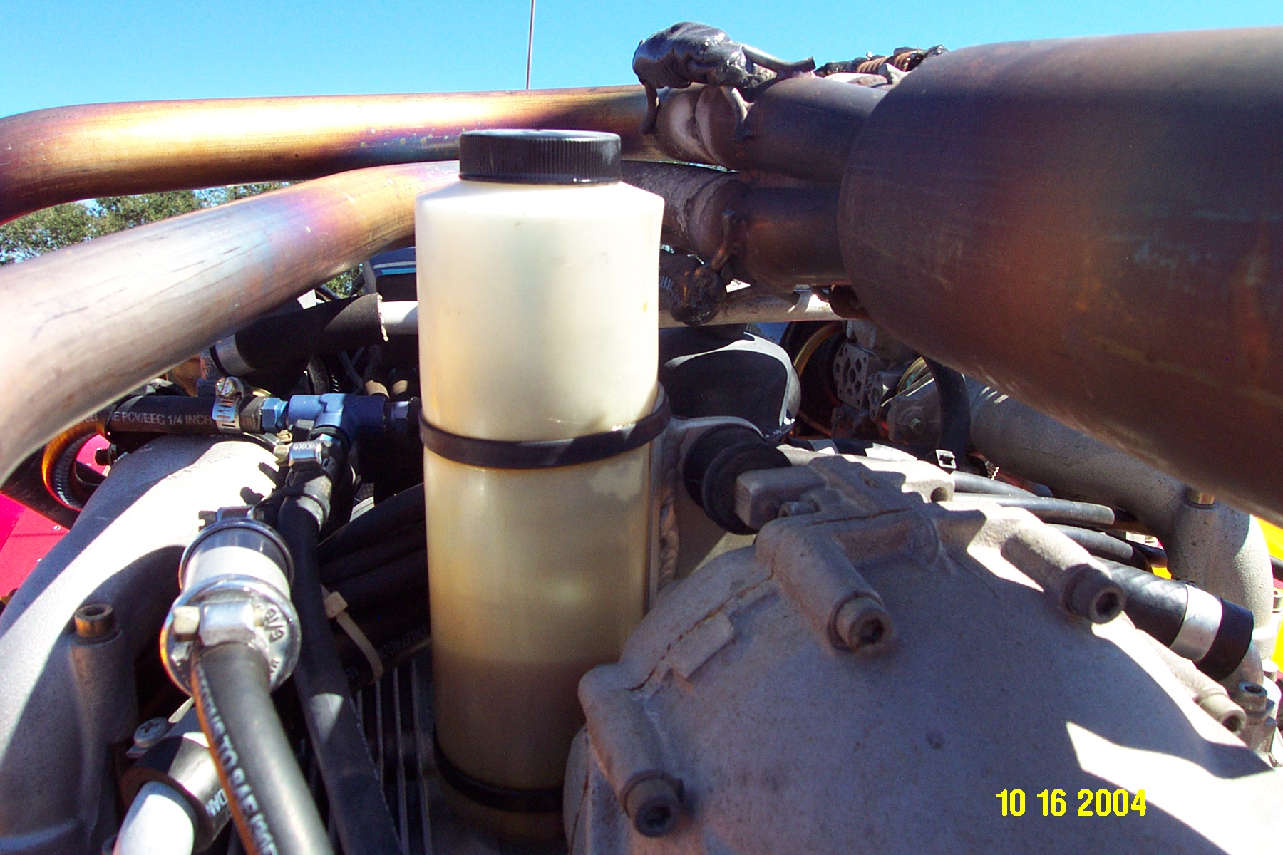

PostPosted: Fri Aug 04, 2006 12:36 pm    Post subject: Check List Reply with quote
Thanks John (exhast wrap). Maybe you could tell me how you mounted your
coolant overflow bottle. Thanks for the gas can info also, I was allready to
buy two 10's at $86 each and have some one weld a minor mod for them. 12
gals. will do for now.
Vic
MKIIIX 912ul
Maine
MKIIIX040
912UL
PostPosted: Fri Aug 04, 2006 1:51 pm    Post subject: Check List Reply with quote
| Vic
Vic:
Used a nalgene plastic bottle (the kind most little cafes use for
mustard and catsup. Welded up a little aluminum bracket with tabs to
mount to the two 6mm taped holes in the back (opposite prop) of the
gear box. Used a couple tie wraps to secure the bottle to the
bracket.
John Cooley
Posts: 17
Location: Lucedale, Ms.
PostPosted: Fri Aug 04, 2006 2:53 pm    Post subject: Check List Reply with quote
Hi Vic/John,
I just happen to have a picture that shows the bottle in question. Took the
picture in 2004 when John was at Octoberlite fly-in at Ronnie Smith's. Hope
it helps.
P.S. Hope the picture is not too big for the dial-up folks. I've converted
to Hughes satellite service and things are much better and more expensive.
Later,
John Cooley
| Vic
 Filesize:  473.55 KB
 Viewed:  446 Time(s)
Be Safe,
John Cooley
