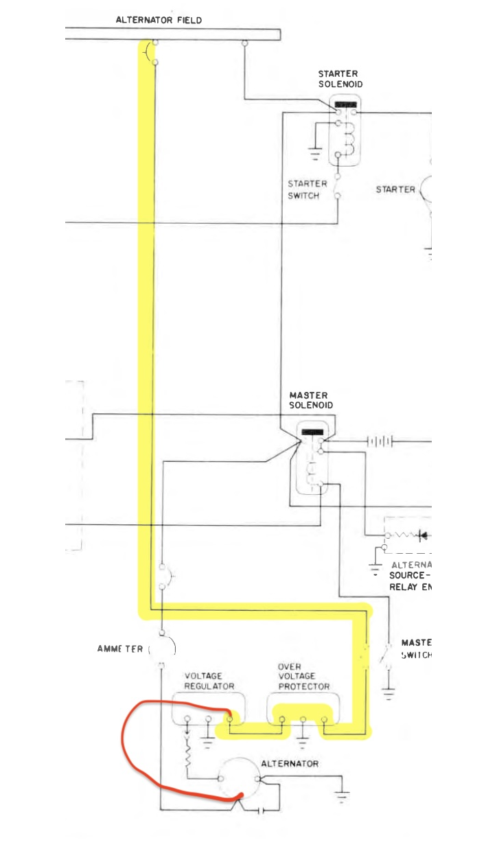

I have been reading Aeroelectric resources on the cause of the galloping alternator issue, and how to fix. I just want to verify that the circuit where a too-high resistance will cause an oscialltion is this one (yellow):
And that a differential diagnosis is that the problem goes away on temporary connection of the red wire - have I understood that correctly?
<Screenshot 2026-07-22 at 09.24.57.png>
