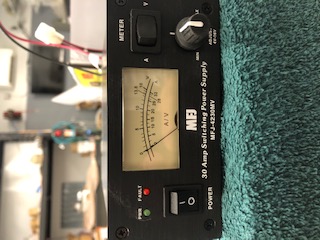

Ok Bob here's what I did to check the hourmeter.
I connected a power supply to the positive and negative pins on the
hourmeter. This illuminated the LCD digits but elapsed time was not recorded. I then added the enable pin to the positive lead from
the power supply and elapsed time began recording.
Unfortunately, I was unable to measure any current draw with the
equipment I have. Probably too low I guess?
The placard on the hourmeter says 1/2W max.
Anything else I can do?
I took a video but didn't turn out too good. Attached a pic of my power supply.
Shawn
