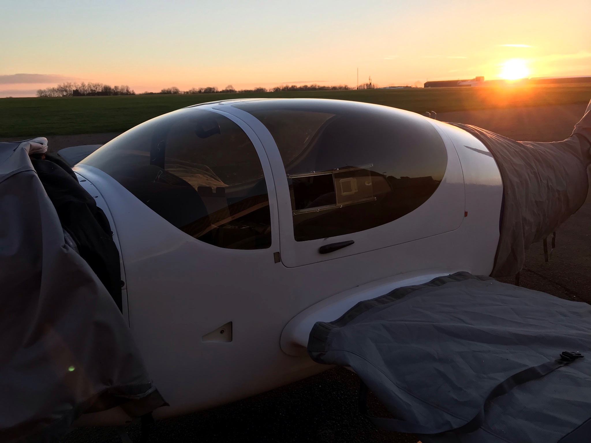

Graeme, I found the Naca vents did not flow enough air for me on hot summer days so went down the standard aircraft practice used for Sailplanes and Motorgliders
( derived from a ww2 requirement of all aircraft supplied to military to have a direct view panel in case of oil coverage or icing ).
I enjoy flying in the winter and during a dawn takeoff from Elverum in Norway snow covered strip , the canopy totally iced over as we climbed out , we were able to use open DV panel to circle the field as the rising sun melted the ice and restored full view..
Window needs to conform to shape of screen ,
Mould taken from exterior of screen before I laser cut the window aperture .
The location is high enough so the ram air vent clears the door handle.
And is as far forward as the slide rails will go against door frame .
https://www.afeonline.com/shop/mecaplex-dv-panel-scoop.html?osCsid=6b2332ad4f6f025eb953f910786112fe
[img]cid:48119686-0540-4C4A-96EC-682C9928E191[/img]
Sent from my iPad

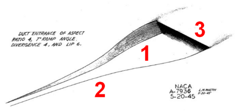

Hi all,
This is what we did as a "defog" system :
http://contrails.free.fr/cellule_defog_en.php
Also I happened to perform a small study on NACA vents some time ago.
To support Ducan message, location, location !
The "NACA sumerged inlet" works only if the streamlines at its location are fairly parallel (ie no acceleration or especially no deceleration) and not too disturbed.
A clean inlet ramp, really square edges and a proper "lip" are required.
[img]cid:part1.E6A2674D.3B9F56CD(at)free.fr[/img]
Should craft a web page one of these days.

My Europa has NACA ducts closer to the fuse split line and work very well. As do many other with the standard duct shape in or around this location.

Seems KJ might have his, very nicely finished, NACA vents to low down on the fuselage.
