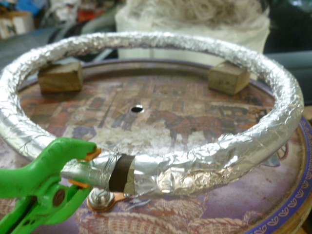

Finally got around to playing with nanoVNA and DDRR antenna.
I don't see that it can be used for a Comm antenna (118-136MHz). Too narrow bandwidth. Tried different things like changing gap, tap point, height and length. Formulas seem to be off. Found needed smaller circle (circumference). Also tap location closer to 0.5" that the 2.5 to 2.8" calculated points. I used a relatively thin wire as opposed to the recommended 1/4" to 1/2" tubing, hoping it would broaden the bandwidth (according to this remark:"The larger D is the higher efficiency is"). Bob tried to answer that for me but I'm still not sure if "efficiency" is related to bandwidth ("Q"). Perhaps I misunderstood that and should try 1/4" tubing?
Or even a radiator fabricated from flat sheet?
The larger the diameter, the greater the bandwidth.
Efficiency has to do with ohmic losses (how much
energy goes off in heat) and again, a larger surface
area of the radiator has lower resistance. Recall that
currents at these frequencies flow on the skin
of the conductor. At DC, there is a substantial
difference between say a 1" diameter rod and a 1"
thin wall tube. At 100 MHz there is virtually
no difference 'cause all the 'happening' is at
the surface.

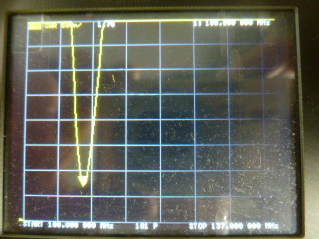

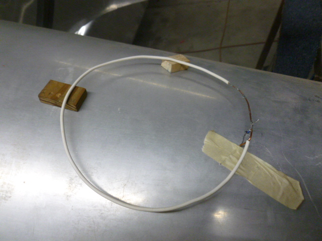

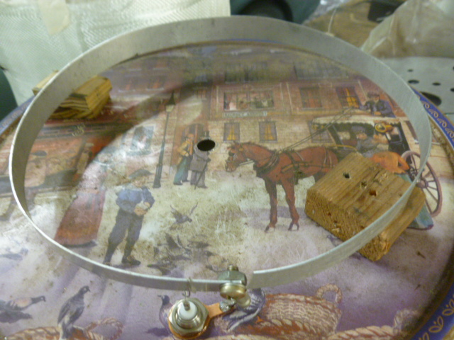

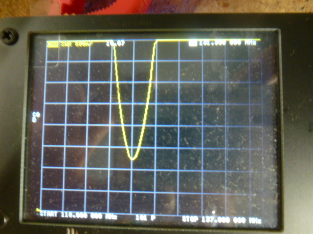

Tried with bigger "tubing" (Did not want to spend $ and time going to local hardware store to pick up 1/2" soft copper tubing and elbow.)
Size of wire or tubing does not appear to influence bandwidth.
So, my conclusion is unchanged: good compact vertically polarized antenna for single-frequency use, like ELT or 144-146MHz "band".
Not usable as wideband antenna. 118-136MHz certainly is wideband. (18/127 = 14%).
Would love to have someone else experiment with it and see if they somehow could get 1:3 SWR over 118-136MHz.
[img]cid:part1.9223A322.93ACD30A(at)gmail.com[/img]
[img]cid:part2.B888D8DB.B870AD98(at)gmail.com[/img]
118-137MHz, 1:4 SWR at top.
[img]cid:part3.AC576CD0.797E1988(at)gmail.com[/img]
[img]cid:part4.2F227B3F.402B8D8D(at)gmail.com[/img]
100-137MHz, 1:4 SWR at top.
You can definitely tune it to much better SWR at center frequency, but that was not the purpose here.
