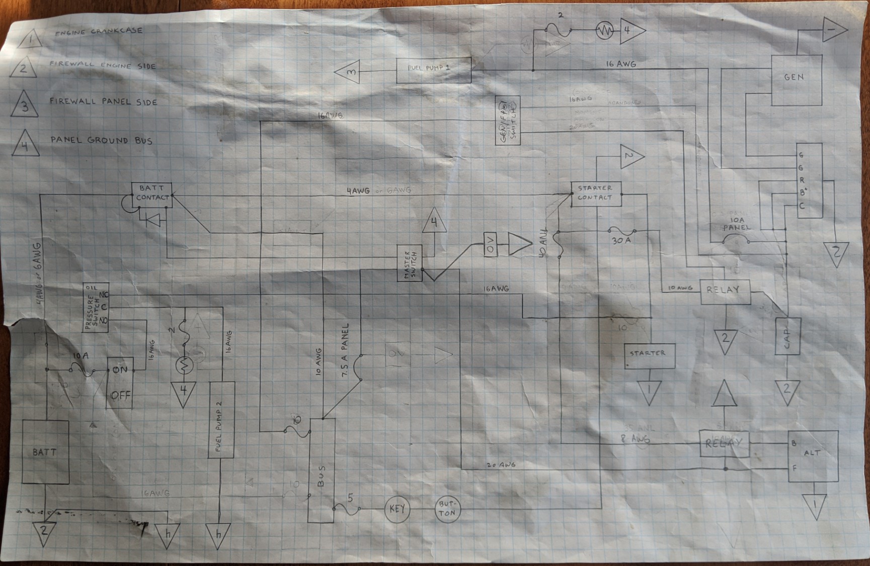

There has been some discussion about possible issues related to having two fuses in the same circuit. I'm not sure if this was ever resolved.
My situation has to do with the indicator lights that tell me whether or not each of my two fuel pumps is getting power. Of course the wire that powers each pump is fused. But the wire that powers each indicator light is tied to the same circuit as its respective pump, and that wire is protected separately by a 2 amp fuse.
I have attached a picture of my wiring diagram. Wiring is 100% complete, but airplane has not flown yet. Limited testing has not uncovered any issues.
If the existence of these two amp fuses in my system could cause me to lose power to a fuel pump, I would remove them, unless removing them causes other problems.
See attached and as always, thanks!
Ken

Noob question... why is a separate fuse for the indicator light a good idea, if the circuit is already protected?

Those 2 amp fuses are not a problem. If you want to experiment, you could short out
an indicator light to make sure that the fuel pump fuse does not blow along with the 2 amp fuse.

If the indicator light shorts out I would not want that to take down the pump itself.

It's not the circuit that is protected by the breaker or fuse, it's the *wire*. If the wire running to the indicator lamp is smaller than the 16 gauge running to the pump, the fuse is appropriate. I don't see the wire size labeled. That fuse should be as near as possible to the junction of the pump wire & the smaller indicator wire. If it's wired according to the diagram, I don't see any way the fuse to the indicator could take out the pump, because that fuse is not in the path of the electrons going through the pump. ---

If you move the lamp connection point (and fuse) back to the source, any
issue disappears. Unless you're using the CB to control the pump, of course.
What pumps are you using? Facets run on about 2-3A; Walbro injection
pumps expect a 15A protection device (startup surge). The Wabros are
marked right on the pump.

My GSL393 is marked "20 amp fuse".

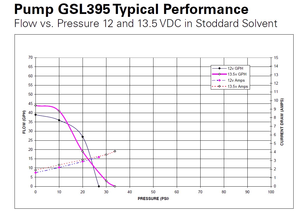

Charlie, the pumps are Walbro. I believe they are GSL395. I was advised to use 10 amp fuse but I will double check. I did go to the Walbro website but couldn't find specs.
> Ken
Charlie
> Ken
Charlie

Walbro 395 flow and current... the Walbro page I found had broken links to the jpg graphs but those broken links contain file names and with the file names one can google and get https://walbrofuelpumps.com/images/flow-charts/
In that file space is "GSL395-Flow-Chart.jpg"... attached.

PostPosted: Sat Aug 08, 2020 6:57 am    Post subject: two fuses in a circuit Reply with quote
If you use an LED indicator, the obligatory
current limiting resistor for the LED can
be installed at the 'head end' of the indicator
feeder where the fuse would be located . . .
putting the resistor there limits current
in that feeder to milliamps even when shorted
to ground. The fuse goes away.
