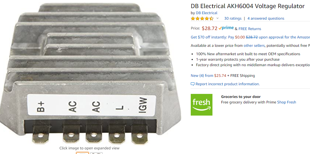

Can you post a picture of your John Deere regulator?
If it looks like this one, B+ terminal goes to a 30 amp fuse that is connected to the downstream side of battery contactor.
The AC terminals connect to Rotax permanent magnet generator (yellow wires)
L is for a lamp. Usually not used.
IGW connects to a switch (labeled "Alternator") which gets 12 volts from a 3 amp fuse on the main power bus.
Be sure to mount regulator using heat conductive grease between aluminum surfaces.

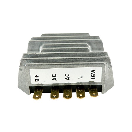

I originally bought this as a back up to carry in my flying tool/spares pack.  I thought it might be a good idea to know how to install it.
thanks

So my research indicates
AC = Yellow rotax wires output from ALT
B+ = +B = battery
I believe that on the Ducati R and +B are connected internally.
Will,
Yes they are.
http://contrails.free.fr/elec_ducati_en.php
