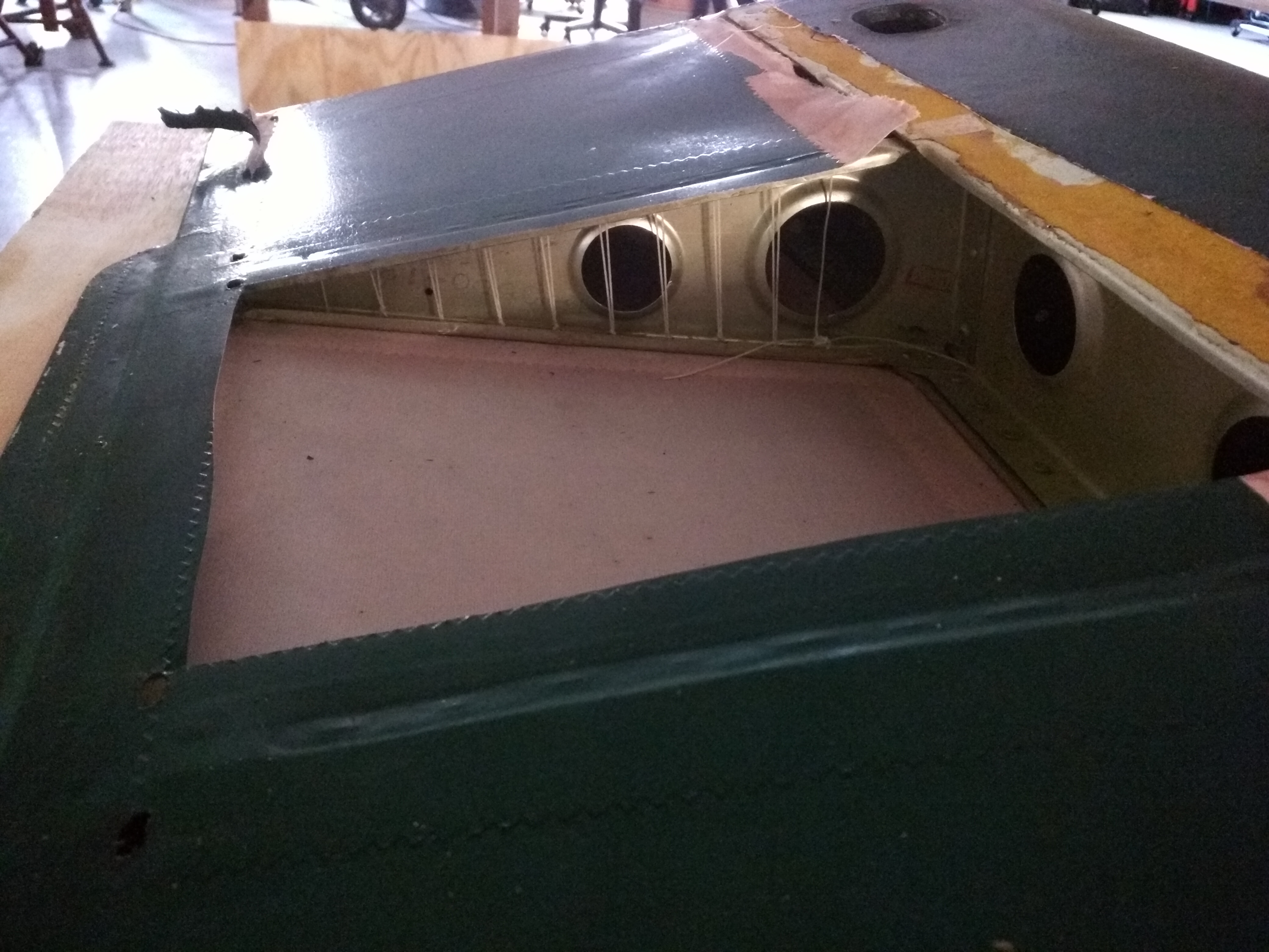

Have had a great deal of help from 3 EAA gurus on stick and fabric airplanes. A lot of tricks learned from those 3.
It is a good thing I undertook this project. There were three cracked ribs along with the trailing edge that were almost completely broken through. The two worst were where the trim tab mounted. I now know why I had a ratcheting right snap roll.
To stiffen it some RU Afro engineer put a strip of 1/8 inch x 1 inch flat plate steel 1/2 of the length of the trailing edge. None of that mod was found in the right aileron.
It was a good thing I tore it down. That one was about to test my piloting skills.

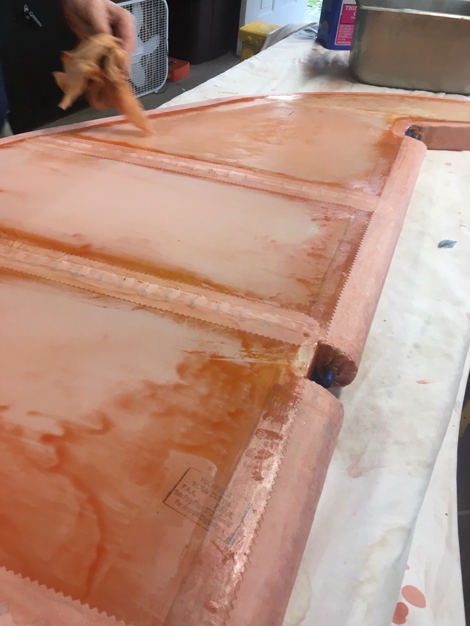

This is a pics of my rudder getting the MEK wipe down before applying poly spray. My tail feathers are poly sprayed now hanging on a rack in my hanger awaiting the fourth coat of poly spray. Then I will paint them. ( with the help of my EAA gurus). 😜🥴
Sent from my iPad

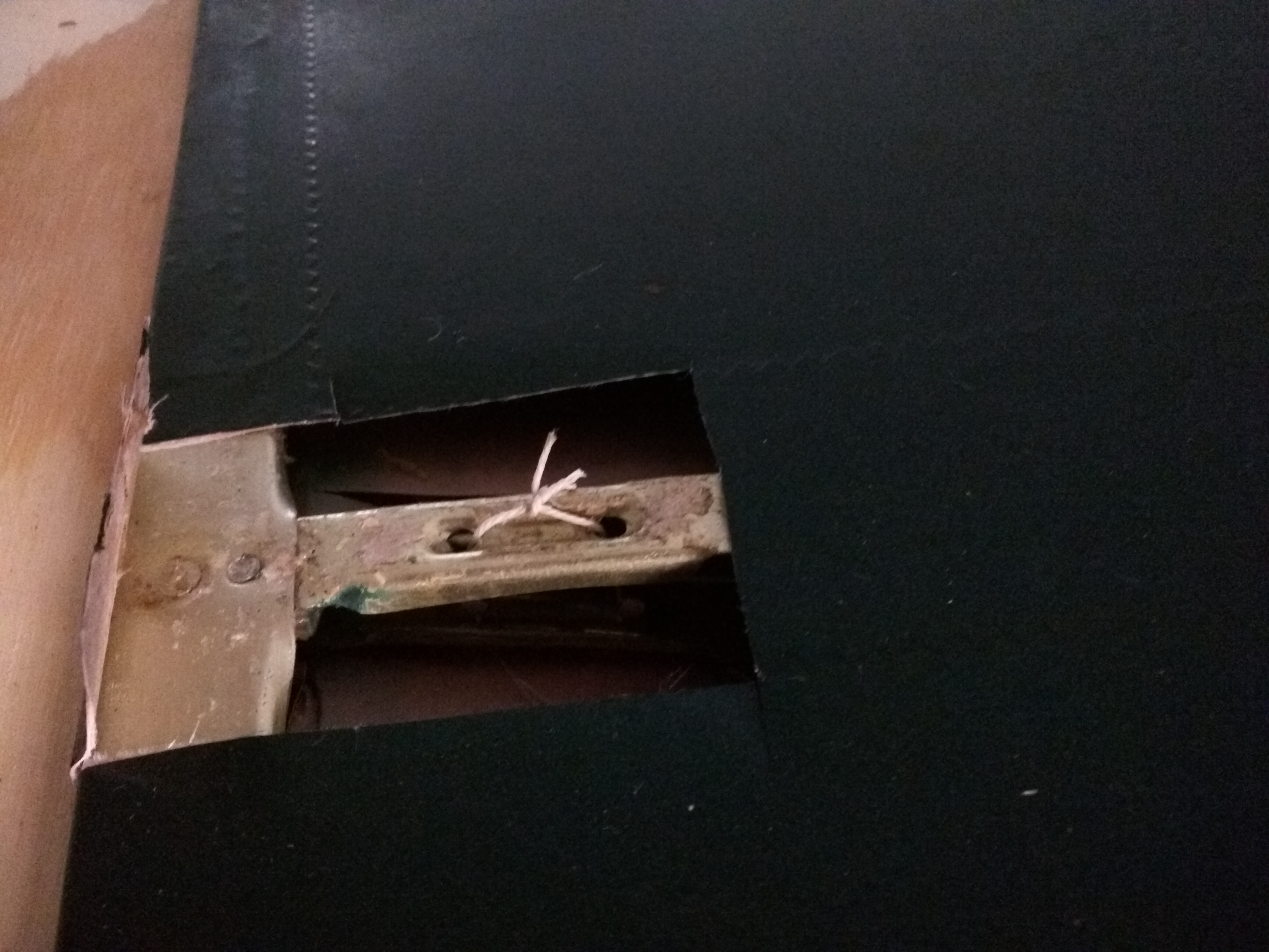

I had never done this before, and I did mine with the oversight of an EAA guru too. It was so cool to learn how to do this!
I could have done them better, but hey, 100 hours and they still look good. I also had a cracked trailing edge that I fixed. Here is a link to my "New Fabric" album...

Hey - thanks. IIRC, took me a month or so in the summer, working fairly sporadically while waiting for things to dry/cure, get the correct color shade for final coat, etc.
One thing I wish I had paid more attention to, is getting the tape to settle "down" over or into the rib lacing/sewing "channel". Much of it has a bit of a bubble the channel. It is well secured, but not beautifully level as some other work I have seen. Next time... !!

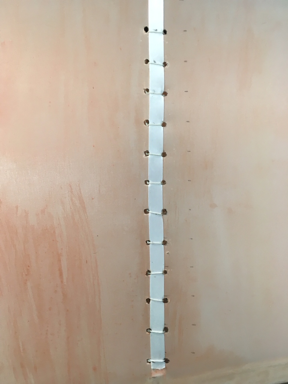

Stephen , I am recovering my flight controls and I would like to know how you did the stitching. We can not figure out how the chinese got the knots tied after the fabric was put on. See pictures attached.
Also what weight fabric did you use. Thanks.

Sorry to take so long to reply, I missed your question. The whole airplane re-assembly and refurbish (from pieces!) took about 4.5 years, of part time work. The web link below shows some pics trailering it to flying it...
For the recover, I used Poly-Fiber medium fabric and Stits P103 tapes. As far as stitching, my faint memory is that I would run a up/down loop through a couple holes, tie it off really close to a hole, and then repeat in such a way that as I was pulling the next stitch, if I pulled a little bit "taught", I could pull the knot under/through the hole and everything would tighten up... hard to explain. I might have a document/image of the stitching process somewhere. I will look in the fabric box and see if it is tucked in there with the Poly-Fiber instruction booklet.

I know you did not. I use the Stits method Seine knot. Placed at 2 cm ~ 1 inch it is supposed to good for 220 kts. I never could get the RU method to cinch up. When I pulled the cotton of my controls they had some loose strands. With a knot at every loop it’s not going balloon.
Sent from my iPad

Doc, what do you mean by the RU method? I have the PolyFiber book and am trying to understand the Seine knot. I will need lots of practice.
Robert, the spray on is called PolyBrush. I will keep this thread updated as to my progress.
