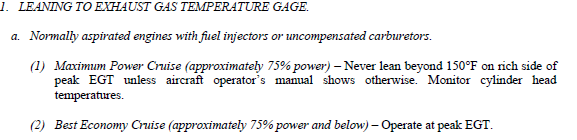

[img]https://docs.google.com/uc?export=download&id=0B5d7rgAInTuTUUZsUjY4QmJsdVU&revid=0B5d7rgAInTuTdDJDaXRFZVh3b3lMa3FWL0s3MFdzc01YRlNvPQ[/img]

I tried this method and compared the results with using the EGT (also per Lycoming's operating manual). I got the same fuel flow both ways.
I learned the manual method in airplanes that lacked an EGT probe on each cylinder. It's quick and doesn't require me to interrupt my scan.
    -- Art Z.

PostPosted: Sun Aug 18, 2019 1:54 pm    Post subject: Flaky EGT Probe Reply with quote
Art, my copy flips that:
[img]cid:ii_jzhhrik50[/img]
Operating at or above 75% at peak egt is  generally considered to be hazardous to exhaust valves. Under 75% makes peak operation ok, as mentioned in the document. The doc doesn't seem to address lean of peak; not surprising since it's almost 15 years old. IIRC, there are Lyc docs with later publication dates that hedge a bit on that 75%/peak statement, but virtually no one operates there, anyway. Almost nothing is lost by going 20-30 lean of peak, assuming mixture distribution allows it.
Charlie
