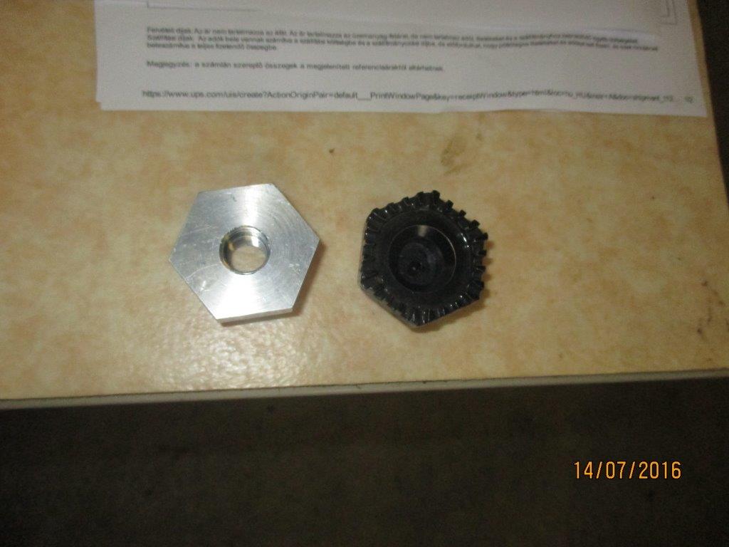

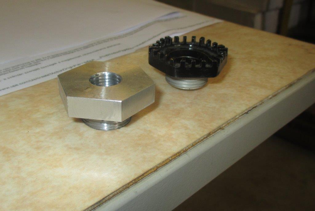

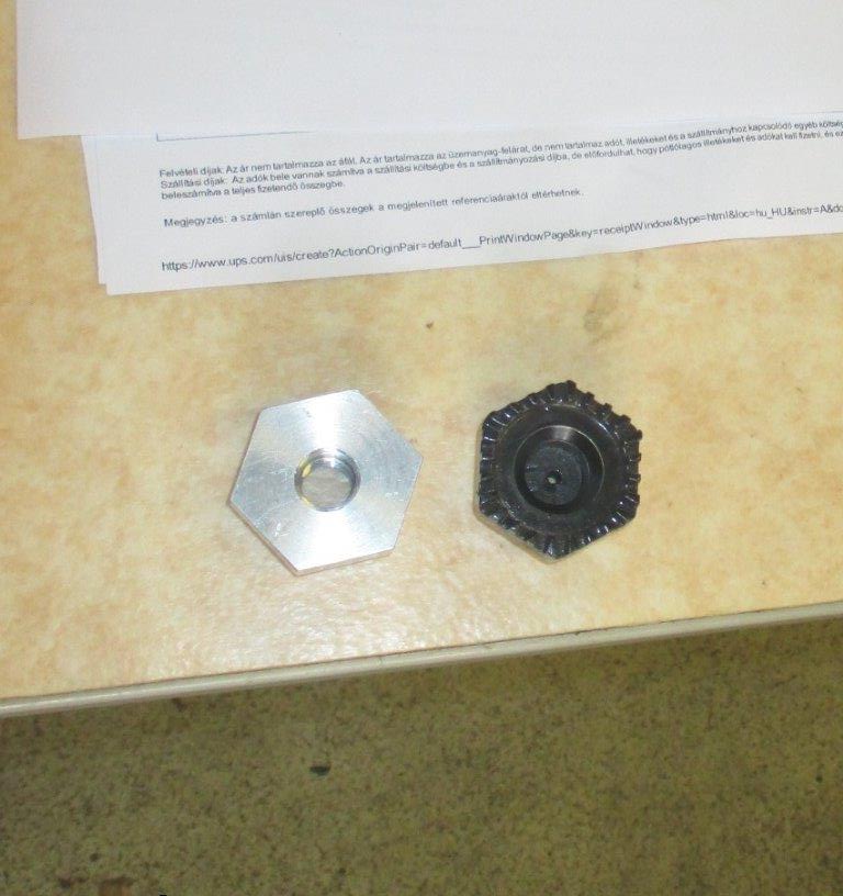

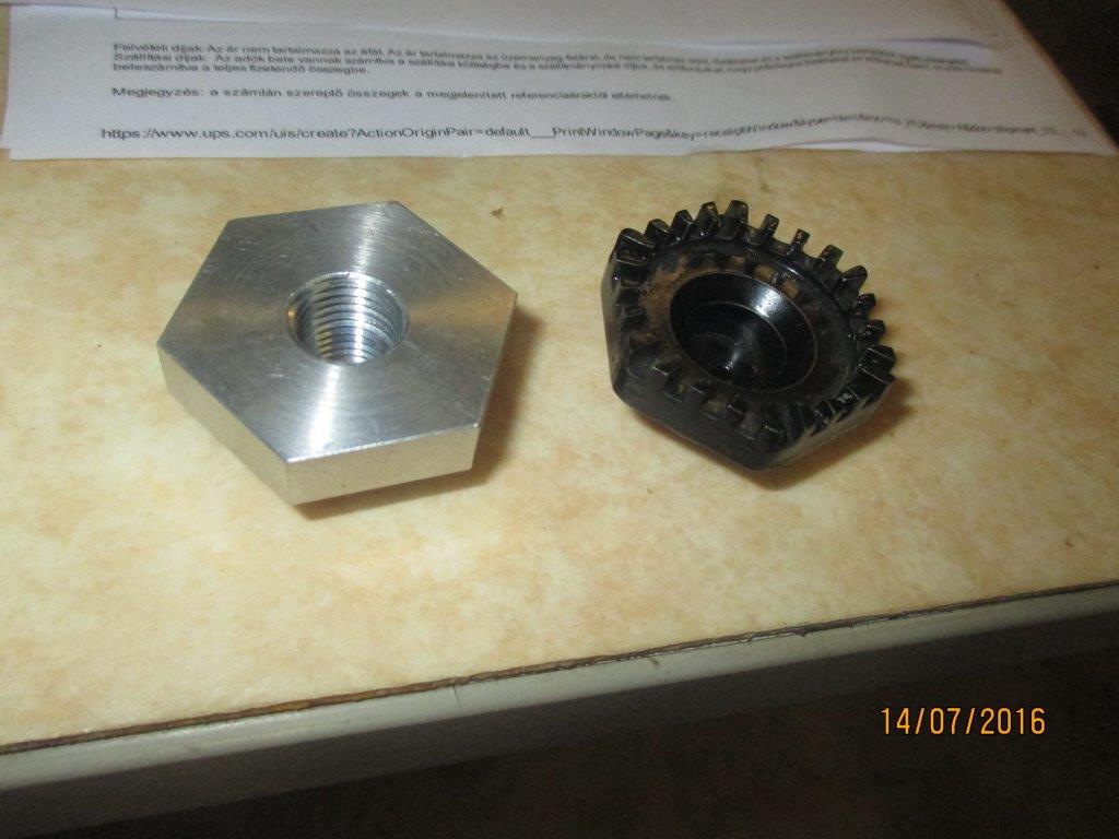

PostPosted: Mon Jun 10, 2019 8:25 am    Post subject: Did a stall, and engine almost quit. Reply with quote
We change the complete intake tube – those ones with a very small hole are simply too small to fit an appropriate AN fitting.
I attach photographs of the much thicker plugs that we manufacture.

What do you have for the small intake tube drains that appear on some engines?
Dennis

You don't mention the kind of manifold oil drain system that was
used and what actually had failed. But, in our experience, it is a
mistake to use the standard Russian manifold drain plug (I have no
experience of this on the Nanchang engine); drill it and tap it
for an AN fitting. This is because it is relatively thin aluminium
and simply not designed to be drilled and tapped. We make a much
thicker plug to replace the Russian one that has much greater
strength and is designed to be tapped.
