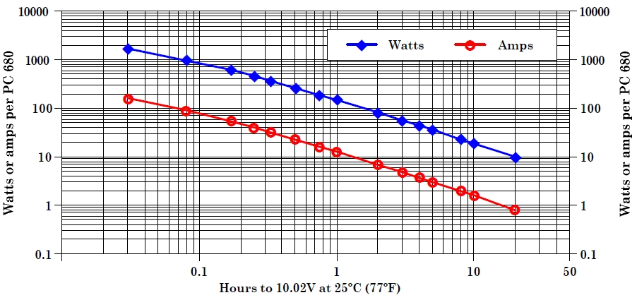

Motor condition is but one of several reasons
for sluggish performance. The weakest link
in cranking chain is battery condition.
Just for grins, jumper your car battery
to the ship's battery and see how the engine
cranks. If there is marked improvement,
consider load/capacity checking your battery.

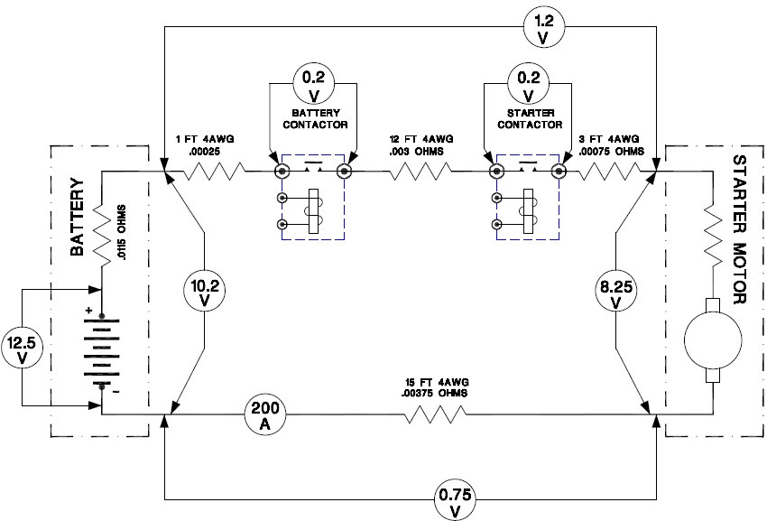

A least likely reason for diminished
performance is an increased voltage
drop in cranking power loop.
[img]cid:.1[/img]
It's expected that voltage available at the starter
motor is lower than battery voltage. Just how much
lower has an effect on cranking speed. I'd carefully
check out the cranking power loop, ESPECIALLY the
battery, before swapping out the starter.

<b1f681f.jpg>

[img]cid:16982567f58aa0d15412[/img]

The way to cap check your battery is to set
up your panel to operate your Plan-B (alternator
out) electrical loads and monitor battery voltage
with a voltmeter. The time it takes to reduce
battery voltage to 10V (the lower limit for
your avionics to operate).
For example, a NEW PC680 has the following
ENERGY delivery capability.
[img]cid:.0[/img]
Assume a 4A endurance load. The curves say you're
good to 3 hours. Here you have to tailor the question
to match your own endurance requirements. If one hour
meets your own Plan-B design goals, then according
to the chart, the new battery is good for about 10A.
Actually, you would want to rate the battery for about
8A given that maintenance protocols suggest replacing
the battery at 75% of new capacity.
Then there's the real-life test . . . turn on the
goodies, start the clock, watch the voltage, measure
the time then recharge the battery. If that time
is equal to or greater than your design goals, then
you're good to fly.
you're good to fly.
How old is your starter? It MIGHT be that brushes
and/or commutator are worn to the point of producing
degraded performance.
<10a704b8.jpg>
you're good to fly.

Agreed. Use a voltmeter between
(1) battery(+) and starter power terminal
while cranking.
(2) battery(-) and crankcase.
Where is your battery located with respect
to starter i.e. how long are the wires
and what gage are they?
This is a NEW condition . . . used to crank
right smartly and only now sluggish?

PostPosted: Mon Mar 18, 2019 1:51 pm    Post subject: Starters Reply with quote
Bob,  The slow prop became more noticeable after rebuilding the engine last summer.  Fresh cylinders along with upping the compression ratio from 7 to 8.5.
  The battery and solenoids are located on the firewall.  So the cables are not very long.  Maybe 5' total and 2' for ground.  They are B&Cs 4 ga. weld cable.
  Looking at the measurements I made yesterday, the drop on the negative was small, maybe .3 volts.  The biggest drop was somewhere between the battery and in side of the starter solenoid.   10.5 volts down to around 8.  Didn't check either side of the battery contactor as the battery was getting low.  I have a brass strap that connects between the two contactors.  1/2' wide by about 4" long.  Do you think this may not be adequate.  Either that or the battery contactor.  I will check the voltages there when I get back out to the hanger.
 Thanks, Steve

PostPosted: Mon Mar 18, 2019 6:03 pm    Post subject: Starters Reply with quote
Your compression change is not significant in terms of starter cranking.
A PC680 easily cranks an 0-360 with 8.5 compression.
Check to see that each connection is at proper torque at the max end of
scale for bolt size. Check the drop across the solenoid.
Now that you have run the battery down a fair amount, charge it at
around 3 amps until full charge. Should have a resting voltage of 12.9
to 13.0 four or more hours after off charger. If less, may need
rejuvenation through several discharge, charge cycles.
On 3/18/2019 2:49 PM, Steve Kelly wrote:
Bob,
to 8.5.
ga. weld cable.
 Thanks, Steve
