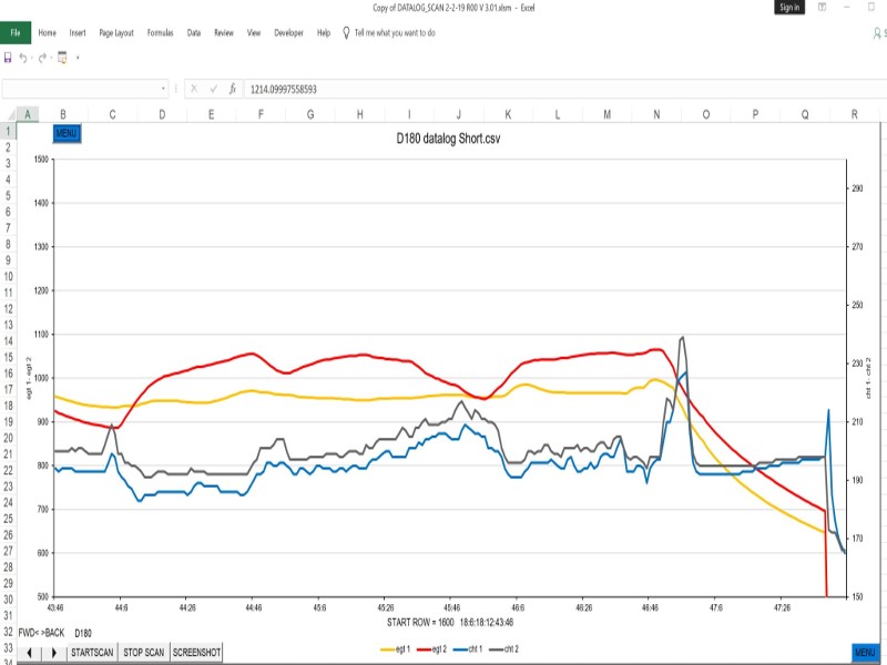

I have an RV12 with D180 and D100.  I use the Datalog capability.  I written Excel macros to allow me to graphically  scan through the data.  It works in an animated fashion or in steps.
The current version supports D180, D100, D120 , Skyview and Advanced Datalog files.
If you would send me a request to  at my email 91827364(at)earthlink.net (bulla31205(at)mypacks.net) I will email you a copy of the "DATALOG SCANNER" program.

I just finished my plane and performed the first engine start this weekend. I have the SkyView DX system and downloaded the logs after the run and found them very complete but almost unusable due to the incredible amount of data.
Your logger spreadsheet sounds like what the doctor ordered and I would greatly appreciate a copy.
Just one additional question, do you use the temperature and air speed in the Celsius and Knots form as stored on the log files or convert to Fahrenheit and MPH?

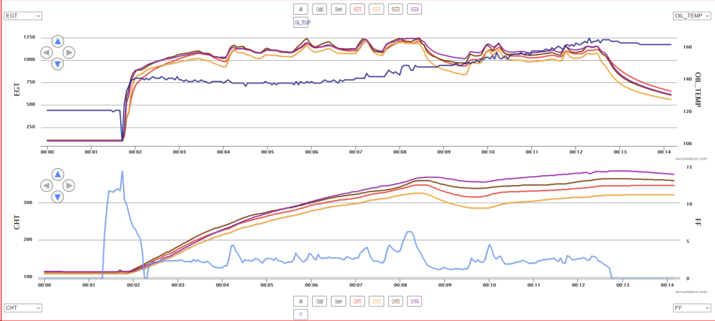

I've been using the free analysis program from Mike Bush...https://savvyanalysis.com/home.
The neat thing here is that if you ask, they will analyze any problems you may have and offer solutions...for a fee, of course.  But the data uploads and charts are free.  And they save them online as long as you want to keep them. Note that you can display up to 4 items at the same time, so you can compare what happened at the same instant (here, I've chosen EGT, CHT, Fuel Flow and Oil Temp).. Just by clicking on the menu, you can choose to display 41 different items, from engine performance to aircraft attitude and fuel and oil ...whatever your device can output.

Just checked it out and it looks great!!! I will give it a try tonight.
Thanks for the heads up.
