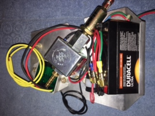

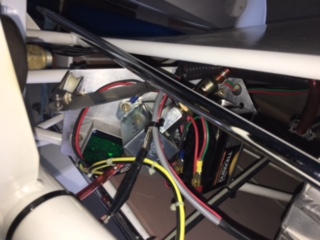

PostPosted: Fri Jun 02, 2017 2:23 pm    Post subject: Fuel Pump Reply with quote
This is thanks to you Kolbers who contributed to my request for information on the Facet fuel pump. I had to add an electrical system to my 1986 Firestar as I'd never really needed one before. I used pretty much all of your input. Here's what I came up with and it seems to work quite well.
I fabricated a mount plate that mounts to the aft cage section directly under the engine mounts. It's mounted using 4 ea. Steel with rubber insulated harness clamps. The mounting plate includes the rectifier/voltage regulator, Facet 40104 fuel pump, 25v22000uf capiciter and sealed lead acid Duracell 12 volt battery. I think the total cost was around $130.00 including wiring and a master power switch. Total weight came out to 3.8 pounds. Here's a couple of pictures. Before and after installation. Thank you all your help.

PostPosted: Fri Jun 02, 2017 2:47 pm    Post subject: Fuel Pump Reply with quote
PLEASE be careful with having fuel lines and seals and connections just a few inches from a battery and electrical connections !

This is
quite well. I fabricated a mount
George H.Firestar,
FS#10014GDHMesick,
Michigan gdhelton(at)gmail.comHave a great
day!
