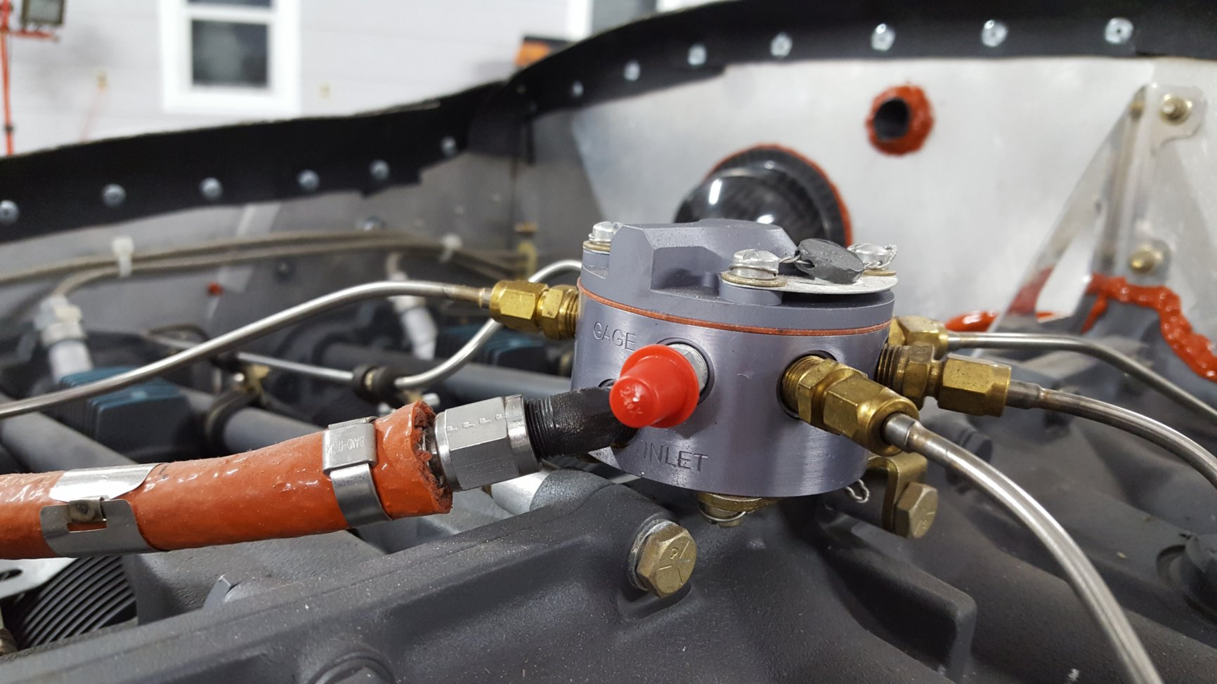

Could someone help me identify what this GAGE connection is?  How should I terminate it?
Is this an overflow?
Thanks!

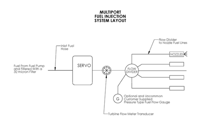

If you have a fuel flow sensor like the red cube, etc., you can just cap it.  It's used by some installations to display fuel pressure (often converted to fuel flow) in the cockpit.--Dave

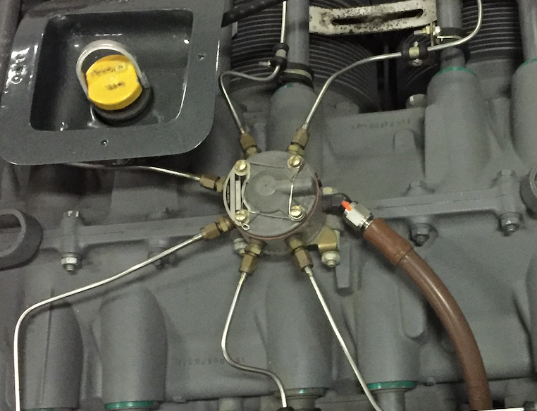

I plugged it. Here's a picture of my spider and a diagram from the Silverhawk manual.

Yes, plug it or it will leak fuel. I thought it was a bleeder but it isn't and won't leak anytime fuel pressure is applied. Only I Kept finding fuel stains on the spyder and finally figured it out.
