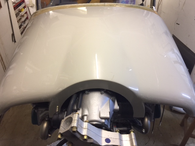

If you were supplied with a Europa XS engine frame then no it is not feasible.
The engine frame extends the cowls two inches forward. The XS cowls also have a different cooling system which allows for your oil and water radiators sent by Europa.

I have kit 215, a Classic Tri Gear, with a Rotax 912ULS. It has the Classic cowls ( I actually have 2 sets of them), but the Europa supplied firewall forward kit requires XS cowls.
Folk tell me I must order a set of XS cowls. But is it feasible to mod the Classic ones?

PostPosted: Thu Dec 15, 2016 10:28 am    Post subject: Re: Classic cowls, with XS oil & water radiators? Reply with quote
Thank Tim & Martin.
I have now put my Classic top cowl in place, and it is a lot shorter.
Decision made!
The improved prop clearance will be welcome too.
