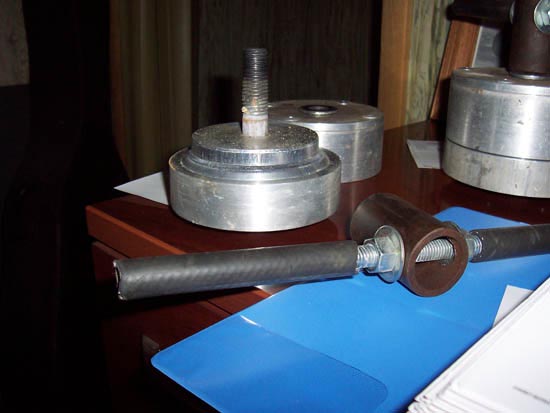

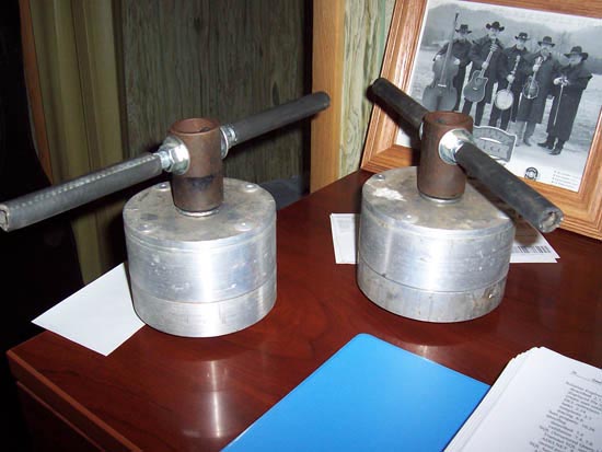

PostPosted: Thu Jul 06, 2006 4:58 am    Post subject: Flanging tool Reply with quote
My cousin made a set of flanging dies for he and I to use.  He made a "T Handle" to squeeze the 2 halves together...  These work very well too.  Attached are 2 pics of my dies.
Randy
