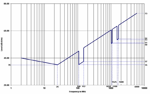

There are chargers . . . then there are CHARGERS.
Small variances in their design and construction
can influence where any antagonistic
behaviors are noted. Unless the device is
designed to suppress the full spectrum of
input frequencies used by potential victims,
it can emit antagonistic energies in little
pockets located anywhere on the spectrum.
So it's entirely possible to find devices that
don't bother YOUR radios on the frequencies
you use . . .while still being a nuisance
to somebody else.
When qualifying to DO160, and depending on
the criticality level of that qualification,
a device is allowed produce greater, potentially
annoying energies outside the spectrum of 'aviation
interests'. As you can see below, the limit lines
for allowed emissions are reduced over frequency
ranges where important airplane business takes place, and
relaxed elsewhere.
[img]cid:.0[/img]
Given that no, commercial off the shelf USB power
adapter will have been so critically evaluated, its
possible to have one that throws tomatoes at ATC
but not Ground Control . . . etc. etc. Even
multiple examples of the same product may demonstrate
different behaviors.
