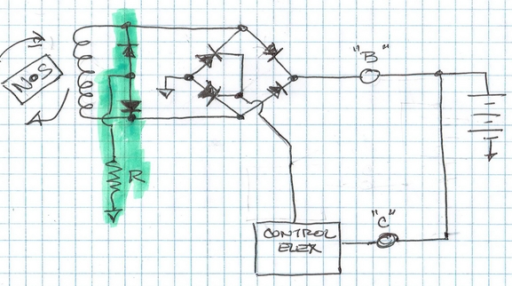

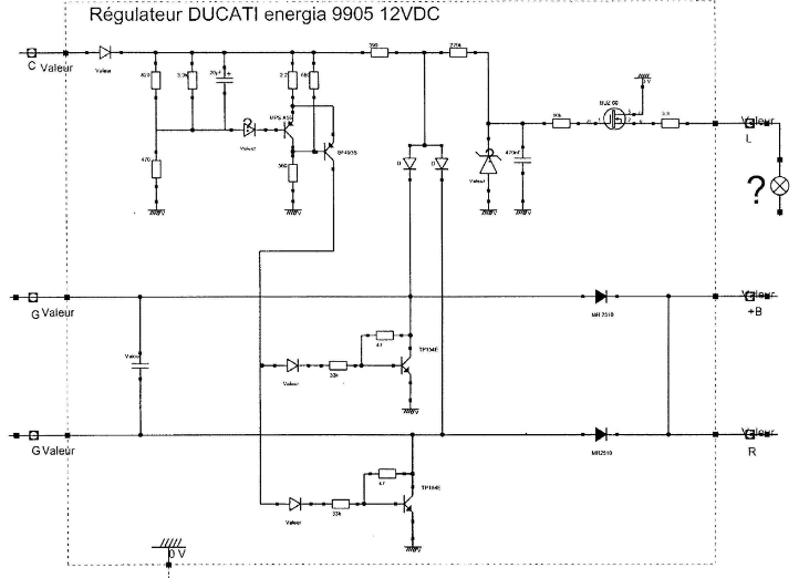

Here's a close approximation of the Ducati product used by Rotax. This
illustrates the general architecture of most rectifier/regulators over
the past 20 years or so . . .
[img]cid:.0[/img]
If you noodle through fuctionality of the circuit, you find a bridge
rectifier consisting of two diodes with cathodes tied to the output
terminal(s) . . . two silicon rectifiers with anodes connected to
ground. Control electronics for the SCRs gets power through the
"C" terminal.
With no source of power at "C" and "B" . . . the control electronics
are dark. With no control electronics, the SCRs are dormant. The
AC output from a rotating dynamo is unavailable for use.
[img]cid:.1[/img]
Adding a battery . . . even a badly discharged battery of under 10 volts
will wake up the control electronics which in turn flogs the SCRs into
action and the Dynamo/R-R system wakes up.
Adding a couple of diodes external to the R-R along with a
current limiting resistor creates the equivalent 'leaky SCRs'
where rectification through the R-R is never zero. Small but
never zero.
In the absence of a load on the usual capacitor across the
R-R output terminals, this small energy source will charge the
capacitor to a voltage that will wake-up the control electronics
and bring the system on line.
This works only if there are no loads on the system's output
that over-taxes the weak, wake-up source.
