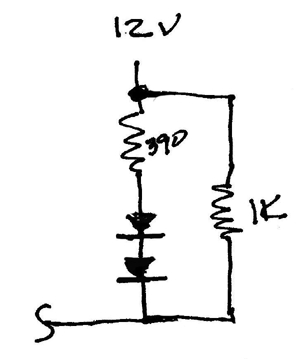

Consider the array of sketches at:
http://tinyurl.com/oxrwae7
I suggest we pay homage to our teachers one of whom once replied: "Dammit Bob, I'm a doctor, not a engineer" -Dr. Leonard McCoy- Very Happy
Unfortunately, this is a bit beyond my skillset. While the squiggly lines are not quite hieroglyphics to me, I'm not exactly sure what to do with them.
How about a brighter led, so it's dimmed level will be equal to the others.
That's a good idea. Except the LEDs that I'm using were the brightest that I could find. So I don't think I'll be able to find any that are brighter and have the same footprint.
I don't believe you will get satisfactory results with any combination of resistors. I think the only solution is a driver circuit between the output and the LED. A single transistor and a couple of resistors should do it. It may need a separate power source.
That sounds reasonable. Is this different than the MOSFET solution posted earlier?

OK, here is another idea. Put a diode (1N4148 ?) in series with each of the bright LEDs. If you are lucky, the voltage drop across the 1N4148 will equal the voltage drop across the oil pressure solid state switch.

It was a legacy practice in aviation annunciator
lamp outputs to offer some way that an annunciator
can tell the pilot that the system driving that
annunciator is OFF. Using the normally closed
contacts of a relay ALWAYS works but if they
can be replaced at less cost, the solid state option is
preferred.
The output circuit depicted in the adaptation of
LED's to the B&C LR series regulators
http://tinyurl.com/cgnwr5k
is an exemplar approach to the task for incandescent
annunciators common to the time. The resistor between
the collector and base of the lamp driver causes
a 'powered down' LR3 to drive an annunciator lamp
into partial conduction . . .
In later years we added a remote sense lead to the
ov/lv detection system which causes the lv warn
to come alive when the bus becomes hot but before
the engine is started and irrespective of the
position of the alternator field switch. This
change of architecture eliminated the value of
'powered down' conduction of the annunciator
sorta went away.
The 'problem' can be eliminated by snipping out
the one-time-useful resistor. I think I'll
suggest that B&C eliminate that resistor in
future production and modify any regulators
that come back for other reasons.

It CAN be eliminated . . . with a massaging of
performance facts . . .
I turn the engine monitor on before engine start and leave it on
until after engine shutdown. Since ghosting only occurs when the
master switch is on and the engine monitor is off, I never see
ghosting because the engine monitor is normally on whenever the
master switch is on. I now consider ghosting, if I ever see it, to
be a warning that I've forgotten to turn the engine monitor
on. "It's not a bug, it's a feature."
. . . it may have been just that under
alternative design goals. Without benefit of
documentation or conversation with the original
designer . . . its a WAG.

Putting a resistor across the lamp/resistor
string SHOULD have fixed your problem. But the
narrative of your observed behavior left
me scratching my head . . . too much is
not yet known . . .
[img]cid:.0[/img]

PostPosted: Wed Jun 18, 2014 3:10 pm    Post subject: LED Ghosting Reply with quote
Technically the resistor did fix the problem (ghosting). But it
created a new problem (dim LED). So now I'm working on the second
problem while not re-introducing the first problem.
That's the fact that does not make sense. The barefoot
string of two LEDS and a resistor function with a
current level on the order of 15 to 20 milliamps.
(First sketch in the document I published). This
is much lower than the typical incandescent lamp
at 80+ milliamps. Adding the resistor (second sketch)
adds another 12 to 14 milliamps for a total of
27 to 34 milliamps . . . much LOWER than the incandescent
lamp being replaced.
We can continue to flog this topic with all
manner of cut, paste, try, suppose, wish and
propose . . . with poor prospects for fixing
it and poorer prospects for understanding
root cause for the symptoms you've observed.
The second sketch 'fix' should have NO effect
on lamp intensity . . . the fact that it does
have an effect says we don't know squat about
what we're doing . . . yet.
Hence, the 'dim LED' is a mystery that
cannot be resolved without knowing the reason
for what appears to be a reduction of available
voltage. The experiments I asked you to conduct
went toward resolving the mystery.
