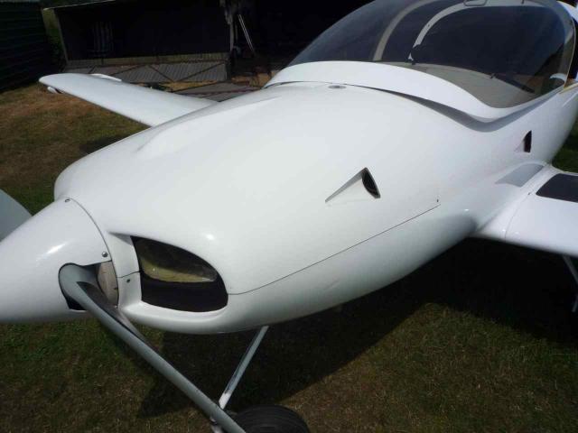

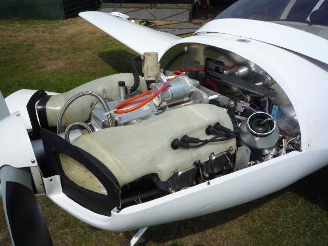

PostPosted: Wed May 22, 2013 5:24 pm    Post subject: Re: Rotax 912 mounting options?.... Reply with quote
Thanks for that information Greg,
I have started an analysis on wing, wing/ gear mounting and fuselage loads and reinforcement. (I commenced this a while ago using the Aerovee VW engine). Once loads are calculated, I'll be looking at reinforcing the inside surfaces of the fuselage shells with uni-directional tape which would allow me to distribute loads more specifically and accurately, to give the same or greater strength as the additional 6 Oz of glass used in th XP, but use a lot less material and therefore result in less weight. It would look like a 2D composite version of a steel truss type structure projected onto the shells. (Same theory as the load bearing structure created by the tape used to reinforce the lower engine cowling/ mount).
the Landing gear and wing "box" structure will be reinforced accordingly after analysis and design, and the fuselage and tail analysis goes from there. It also starts at the engine mounts (bed at this stage) and load paths are also developed and combined. I have been looking into either a pure carbon or aluminium horizontal stab tube and would be interested to know the wall thickness of the XP horizontal stab aluminium tube as it would help to be able to compare my calculated required strengths and modulus to what was originally used with the XP there also.
As far as the fuel tank problem is concerned, I have a copy of the wing tank supplement and at this stage my intention is to make fully molded wing tanks which mount the same way as the XP wooden spar version, but will have less joins and fiberglass ribs to remove/ reduce the likelihood of foam rib and leakage issues. I'll also be using ethanol resistant resin. (Of course I wont bother if the C of G element of the analysis works with the "header" style tank, it's a "Plan B" thing).
I can assure you that all of my calculations will be checked by an aeronautical engineer prior to construction. Components, the entire airframe and flying surfaces will be static load tested. Standard stuff and a lot more thought and testing than most re engined/ modified homebuilt aircraft get, (Probably Pulsars included!). I'm not looking to go faster or make it aerobatic.
I have seen pictures of Pulsar 1's converted to Jabiru 2200 engines using a bed mount and with the header tank, and it has been recommended to me to use the Jabiru engine previously, it appears to have a very similar weight to the 912? I'm guessing these aircraft wouldn't have been structurally improved and probably only had the 900lb spar at maximum? (See Pictures of one example).
My AC is a Tail dragger so the nose gear failure issue isn't a concern. We will use the Grove aluminium gear. (The original fiberglass/ foam gear is still available if someone needs it, but its not worth my job trying to "sneak" it along for a ride in the 777. The guys I fly for don't have much of a sense of humor!).
Why would I bother going through this instead of disposing of my kit and doing it the easy way? I have the kit, it is a great Aircraft with loads of potential, and this is what sport aviation is all about when done properly! (.......And Sonex's don't have the curves!).
So........... do you have the XP manuals available? Wink

PostPosted: Wed May 22, 2013 6:25 pm    Post subject: Rotax 912 mounting options?.... Reply with quote
Your assumption on the Jabiru weights is wrong. The 2200 Jabiru is 15 pounds heavier than the installed wet weight of the 582, making it a good swap. Do not forget, the gross weight is limited by the wood spars.
I am sorry Matt, I cannot support you in this endeavor. You are using a proven design to make a new airplane. When you are done, it may look like a Pulsar, but with all of the modifications, it will become your own design. If you want a 912 Pulsar there are plenty of those out there and I am sure you can find one for sale. There is one on Barnstormers.

PostPosted: Wed May 22, 2013 6:53 pm    Post subject: Re: Rotax 912 mounting options?.... Reply with quote
No assumptions Greg, the Rotax and Jabiru websites have the weights with exhaust etc and they are pretty much the same, so I'd like to hear your opinion on that?
I fully understand the wood spar limitation and am not intending to exceed it?
2200 engines using
very similar weight
been structurally
example).
