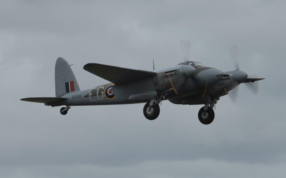

And just for interest, yesterday I attended the first flight of a DeHavilland Mosquito FB26 at Ardmore Airport in NZ.
This is the only flying Mosquito in the world and was built scratch from the original plans in New Zealand.
Two Rolls Royce Merlins together makes a wonderful sound.

Bill & Others,
Dang! I was hoping that would be Ardmore, Oklahoma. Would I love to see that Mosquito fly in person.

Bob
Maybe you will one day. I believe it is owned by an American so he will take it home eventually.
Meanwhile have a look at this and others.
https://www.youtube.com/watch?feature=player_detailpage&v=7vQOY3d89JE

Hi Sue and Bill, Howdy Bob.
What a lovely country you live in NZ, i visited a few years ago and it brought back memory's of Old England , that a compliment.
My favourite Aeroplane, nothing could catch it in WW2, and the later version had a pressurized cockpit, very tricky on one engine go around.
My neighbour now 95 was a Mossy Pilot, so i know a little about them.
We had one over here but crashed just after completion, over here they get the Who you Knows to fly them, and Not the What you Knows so they crash.
Hope that's not the case in NZ.

Lance,
Wonderful! Thanks!
