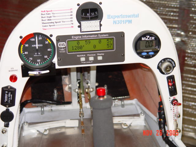

planecrazzzy Guest
Posted: Thu Jan 12, 2006 6:30 pm Post subject: Re: 40 MPH Stall |
Hi,
You wrote to me after my first flight in my Kolb....
Like I had told you when you were wondering about my stall speed...
Like I said to you then.... When you go up , Your first flight should be a short one.....get up to 3000 ft and "APPROACH" a stall ......NOT A FULL STALL...... then you'll have the info you need to be safe....
And it does sound like a "STATIC" problem that your having...
Got a digital camera ??? lets see PICTURES , CLOSE UPS.....
Gotta Fly...
Mike in MN FSII / N381PM
I bought one of those "Hall" mechanical wind guages as a "Check" because I couldn't believe how SLOW I was flying before stall...

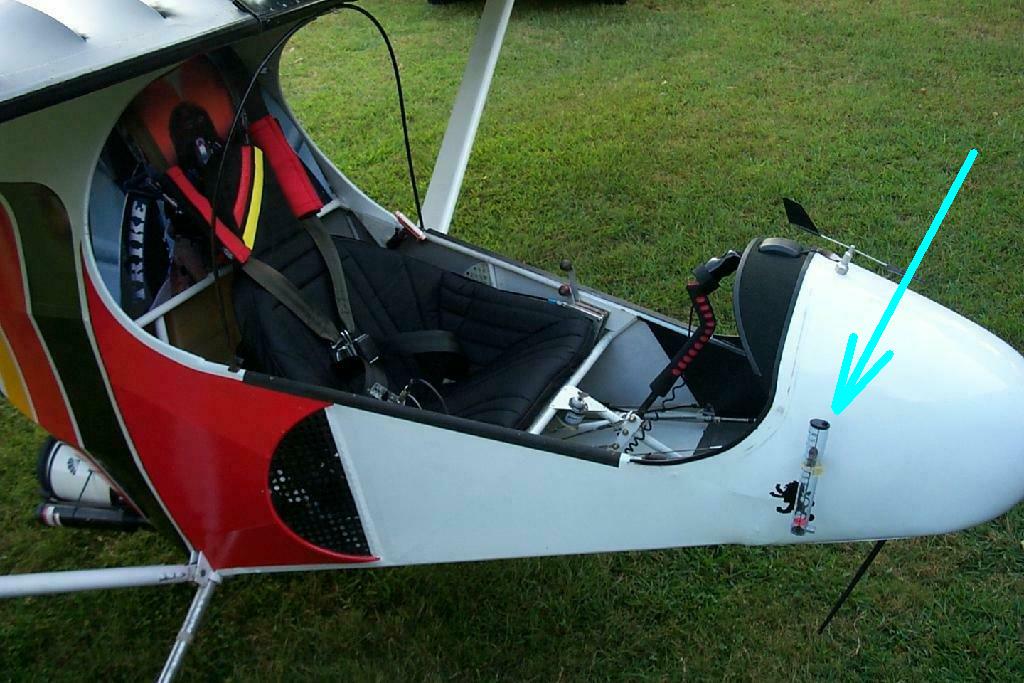

Oh -- BTW I've got a $35 "Hall ASI" on my nose cone, Air Speed Indicator
in the Instrument panel and Garmon GPS 295 inside.
So I'm pretty sure my airspeed is right, but the Hall is the most accurate.
Before the VG's my stall speed was only around 36 mph - so don't
expect miracles.
expect miracles.
Actually got a glass panel - but still have my "Hall" as
a back up. Ha Ha

Can you provide a link to the $35 hall asi product?
Charlie
http://www.hallwindmeter.com/wind.php
