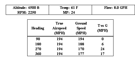

Listers,
I went flying tonight in the RV-6 around sunset and took some airspeed numbers flying the four points of the compass. I let each direction normalize for about 2 minutes before taking the readings. I've still got my little black-tape washer deals on the static ports that I detailed in a previous email.
Do these numbers make any sense?
I set the altimeter to 30.15 (KLVK ATIS). I compared the Dynon altitude with the Garmin 696 GPS altitude. The Dynon was high by 100 ft. I used the Dynon altitude adjustment to set it to match the GPS (-100ft). The readings above were after this adjustment.

I think one can calculate from the GPS numbers that you had a 14 MPH (approx) wind from the WNW and you were doing 182 TAS. Your IAS would appear to be 12 MPH too high.
