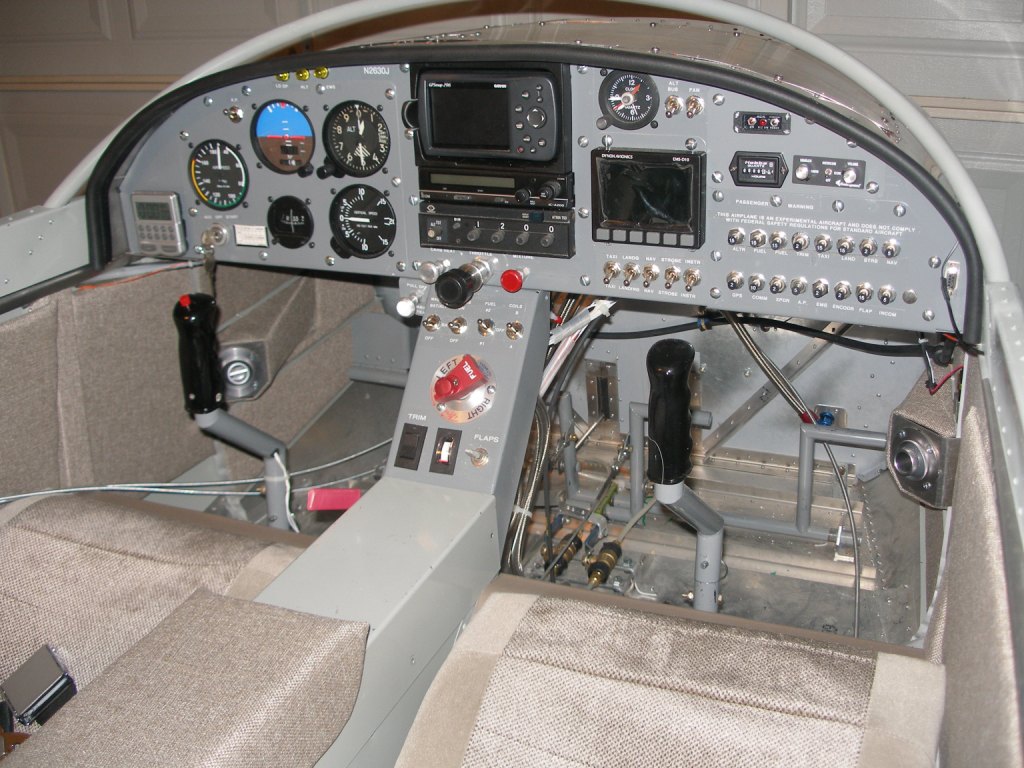

I used Rustoleum from a rattle can, medium to dark gray, with white lettering (see photo).

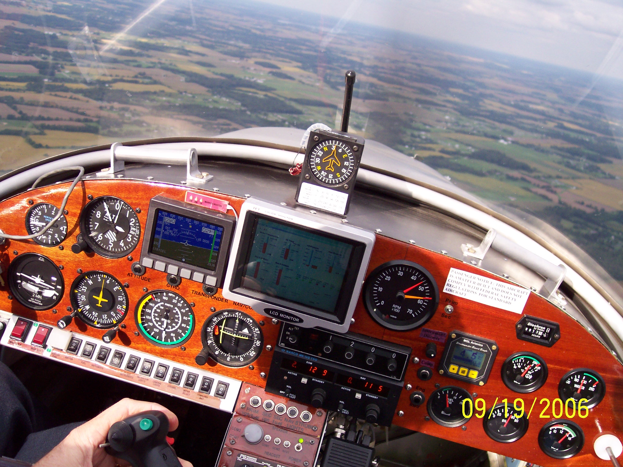

I used cherry veneer, you varnish then use transfer letters for any text
then varnish a few more times.
